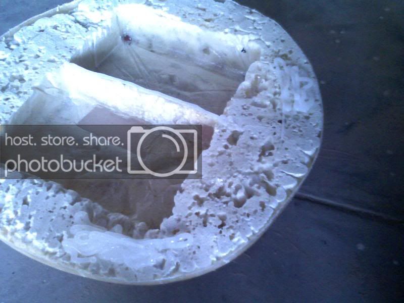

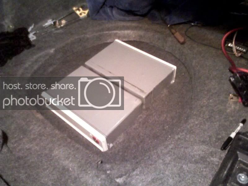

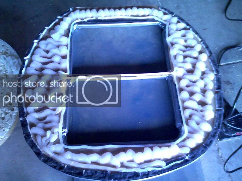

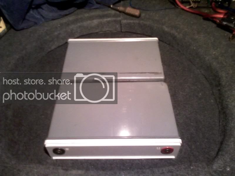

Yes it's on concrete, but only for like 15 minutes to hold the material until the glue got tacky.
2.5 bottles of silicone to bond the top to the mold
0.5 bottle for the low spots
It's still drying in my car.. fumes from the silicone and all!

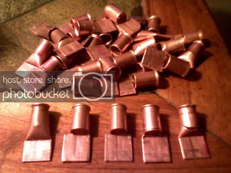

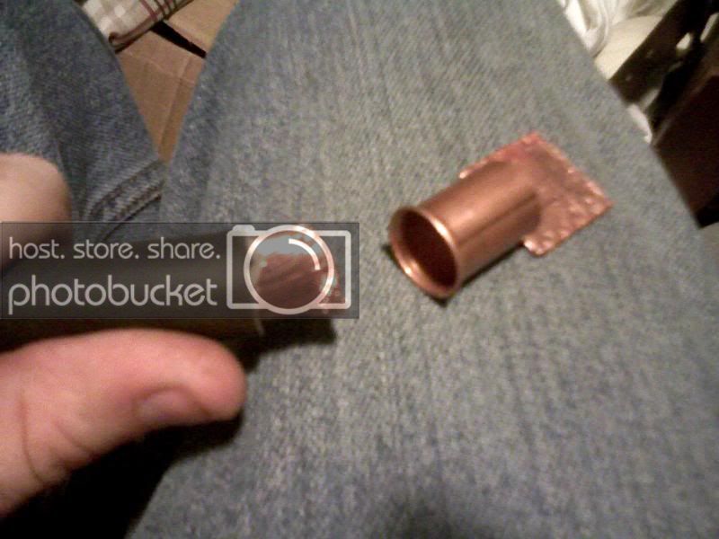

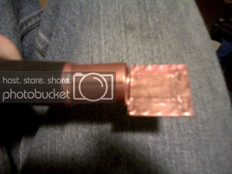

While that was drying, I started making some terminals. The cheapest price online was like 1.80 for 1. There were bulk deals, but I don't need 100 of them. I made 31 in all- +9/16" inner diameter, 1 7/8" length, flared end. I was bored so I made like 4 kinds. The one on the very right is a mix of the left and middle one. Haha again, I was bored.
Test shows it fits like a glove!
I forgot to mention that I plan on rounding off those corners on the terminals when I drill the holes, but I'm tired now.

What did you use to flair the ends? That's a great idea you had there.
Shallow sloped with a flat tie end plumb bob. Before I while each piece was still a full cylinder, I gave it a couple taps on the plumb with a hammer.

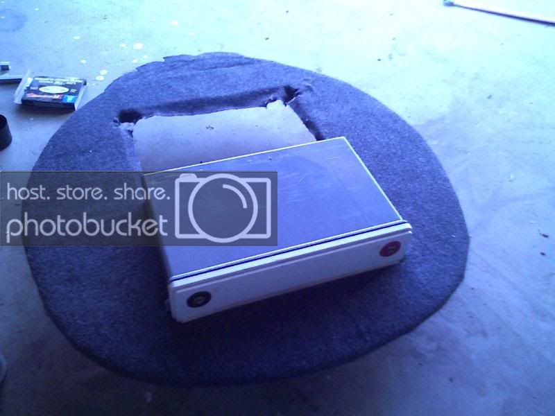

nice job so far but why did you cover that sub why not show it off with some plexiglass
A) It would be super expensive for a piece that big. This is still a budget build
B) I'm definitely not a flashy glitzy kind of person. This is a time where I prefer function over form.
