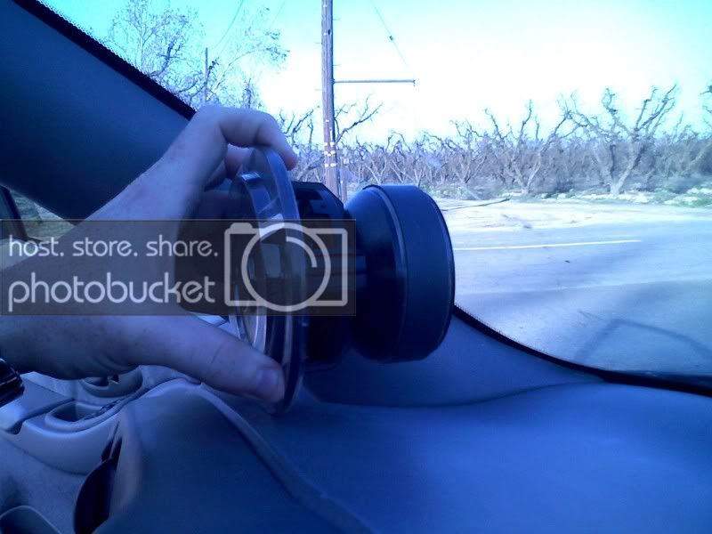

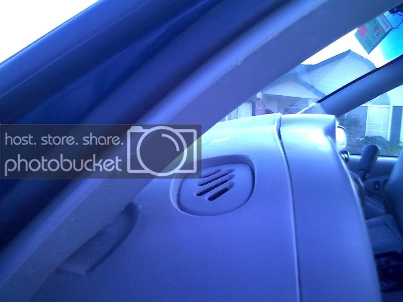

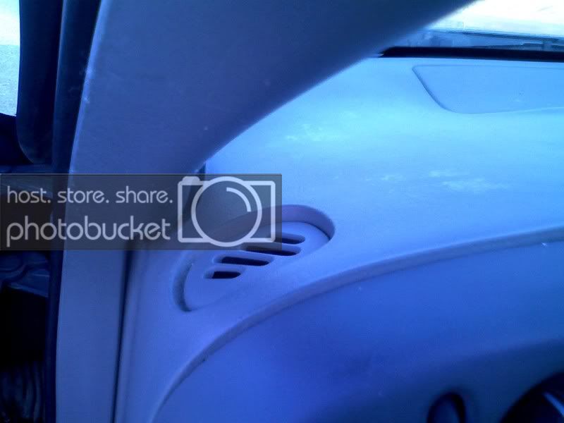

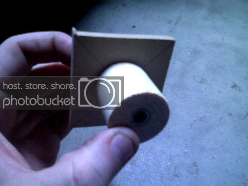

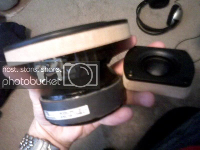

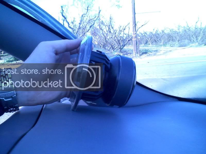

The thing that made me switch the mid and tweeter was the little heater vent:
Here is the clearance obviously not including the thickness of the mount:
Straight forward with magnet touching windshield
Angled upward with ring and magnet touching windshield

I'll definitely mount it there for short term. Keep up with other location suggestions. I just gotta make an almost skin tight pod for the mids to try as many locations as possible... I haven't had ANY time this week at all. Since I haven't been keeping up with my assignment or even doing them early, school has been kickin my butt.

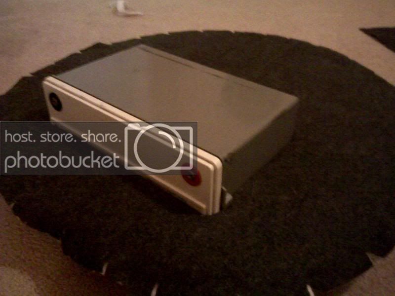

Installed the 880 and boxed up the 490 to install in my other car at a much later time. After fiddling with it and learning how to use some of the options, (not yet even applying all of them) I love it! The iPod adapter is kinda slow, but its definitely tolerable. It's not as bad as the people that write terrible reviews make it seem. Also the built in volt meter reads .3 volts higher than my DMM reads so I'll have to remember that in case it ever becomes necessary.

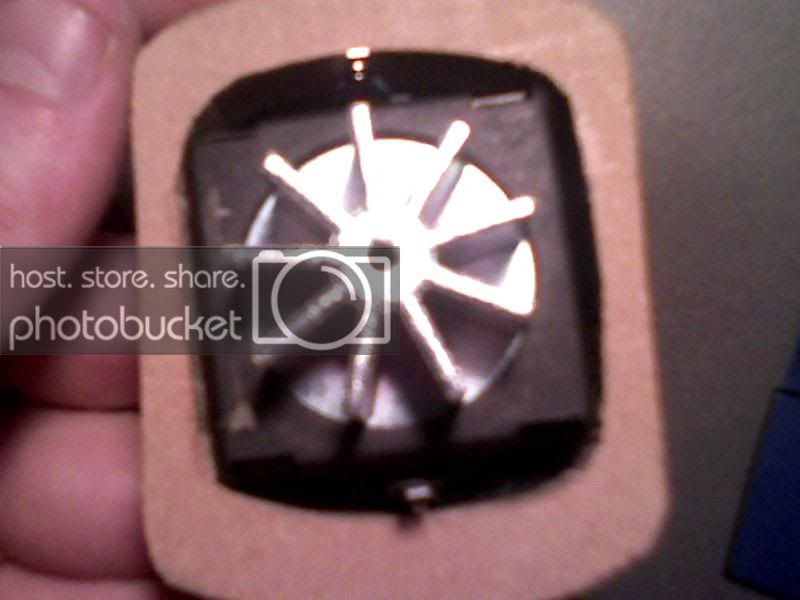

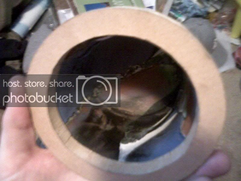

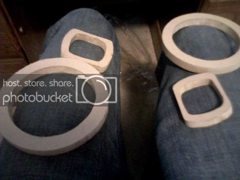

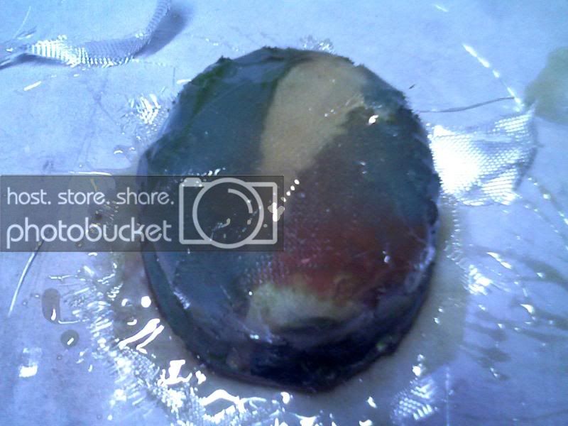

About an hour on the jigsaw got me these:

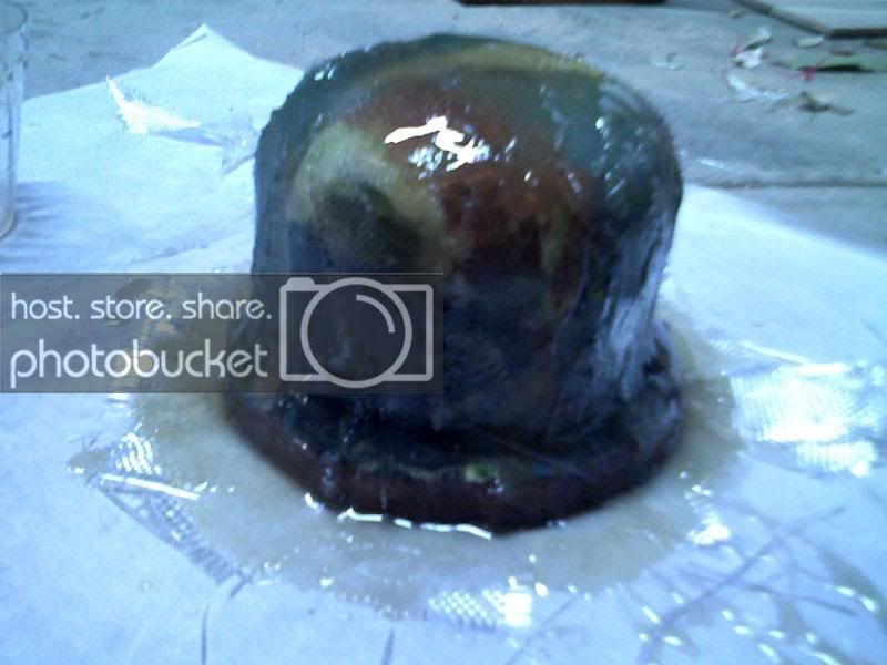

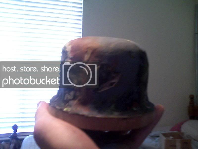

I'm treading in unsure waters now, I couldn't think of an easier way to make a mount just a hair bigger than the speaker itself. I hope this clay idea works out. I used a rolling pin to flatten out some play clay to
**** it's ugly but looks weren't a concern of mine since a) it's the 1st layer and b) the are temporary.
I figure one more layer of mat on the outside, then I'll remove the clay. After that, 2 layers on the inside to keep the outside thickness down. We'll see how it goes from there.

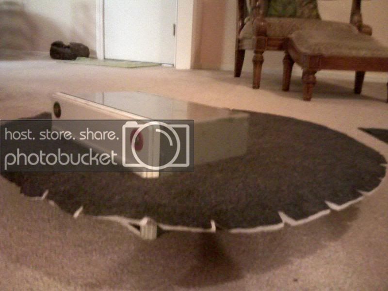

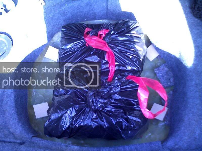

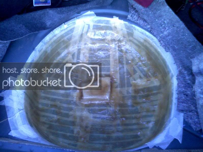

For the past couple of weeks, I've been working on finishing the electrical in my car- one of the most major steps to this is mounting the second battery.

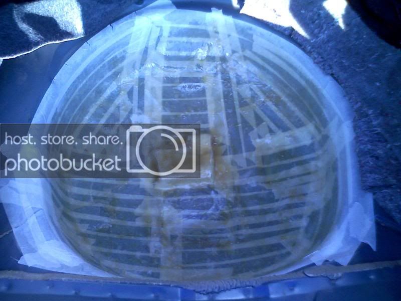

Taped off ( no foil //content.invisioncic.com/y282845/emoticons/frown.gif.a3531fa0534503350665a1e957861287.gif ), first layer and second layers

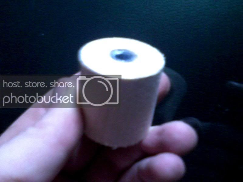

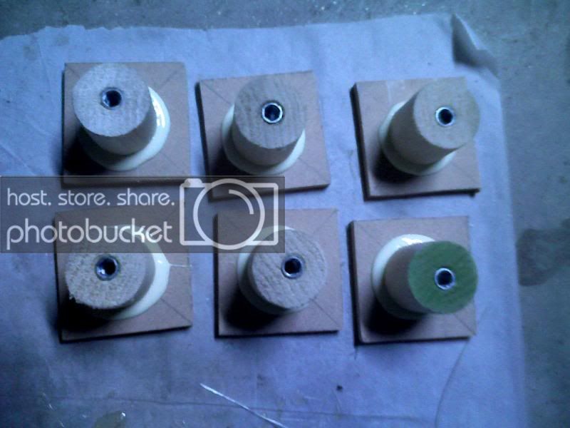

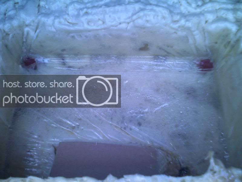

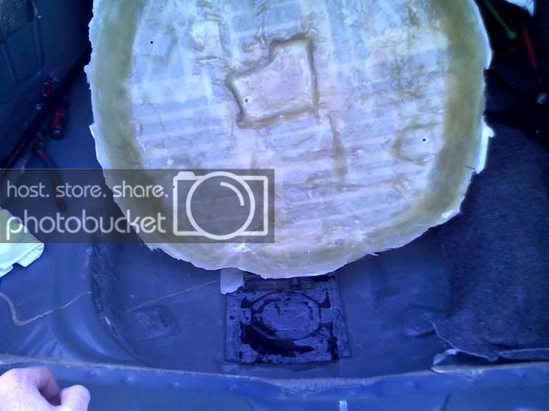

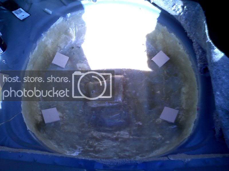

The few pics below are of the anchors to keep the battery mold securely in place.
6 in total, only used 4.

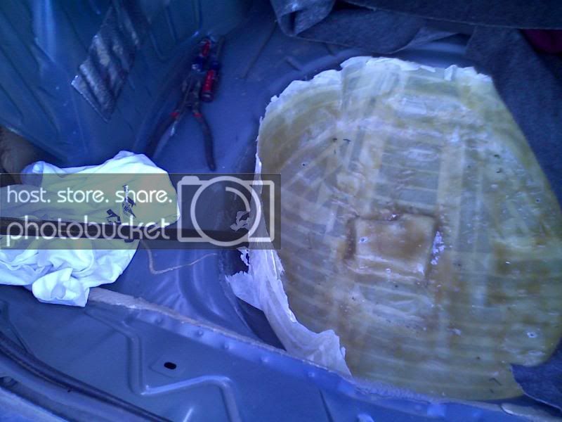

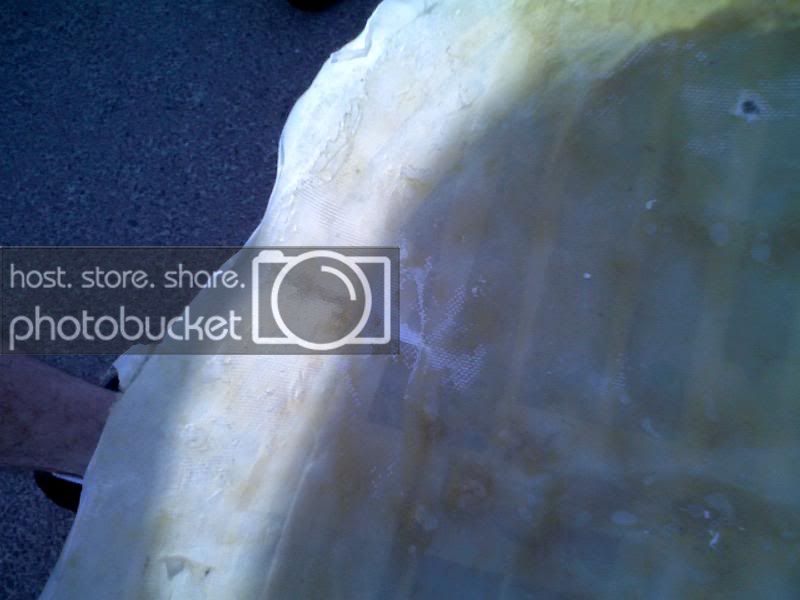

Since I used tape for the FG, it was a huge pain in the butt to get out. I tried delicately at first with just my hands and backing off when I heard little cracks, but it never budged for about 45 minutes. It took a crowbar to get it out with really small damage to one area and negligible damage a few inches to the side. And after I got it out, it took about 2 HOURS to get maybe 85% of the adhesive left from the masking tape off of the metal. I was NOT happy.
It looks bad but I call it minor since it wont affect anything and that part is hidden.
Anchors bolted in from the bottom

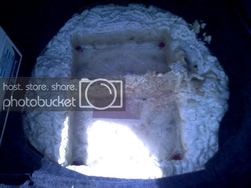

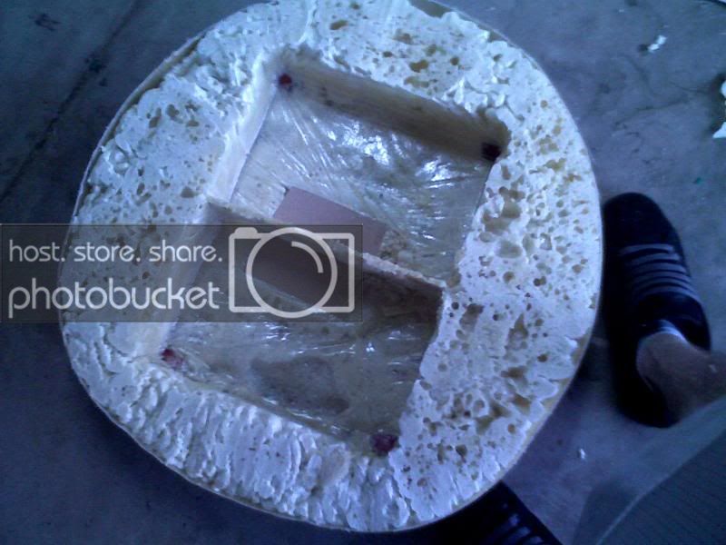

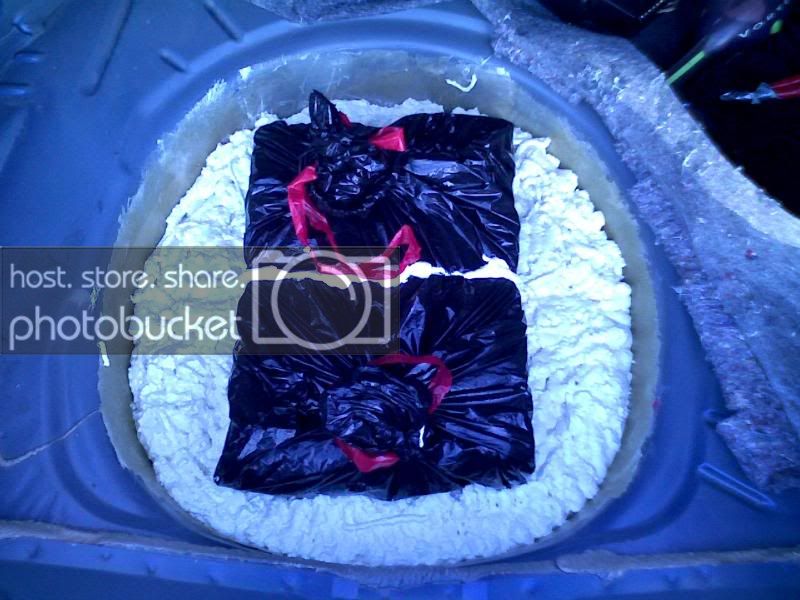

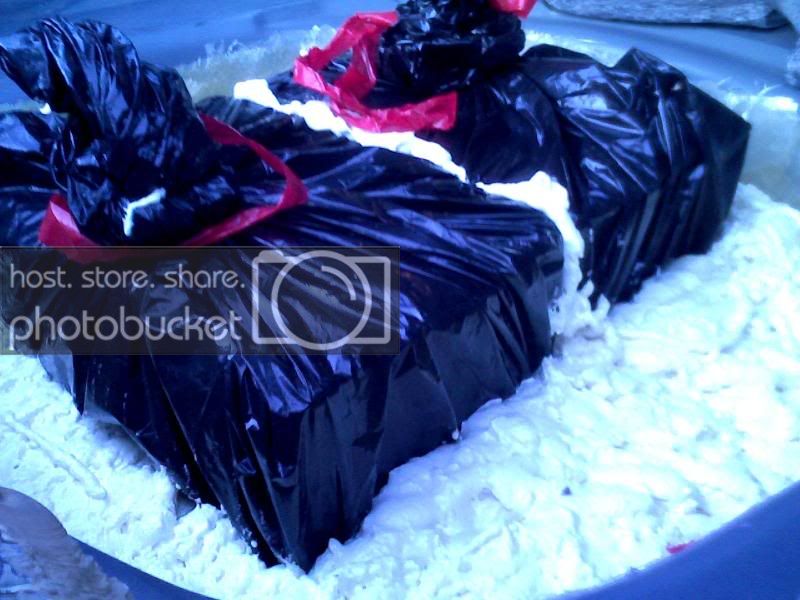

Actual batteries in the bags. What you can't see is a 1/2" wood platform on the bottom of the common side for the batteries to share and rubber supports on each corner where battery meets FG. For some reason, I thought 1 can of expanding foam would be enough. I emptied it and ran to home depot for another 2 cans.

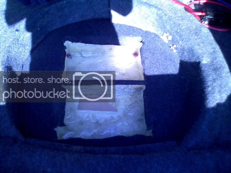

Batteries out, now you can see the platform and rubber supports.
Top is cut to almost flat
I had some 1/2" mdf laying around.. perfect for an aesthetic top.
