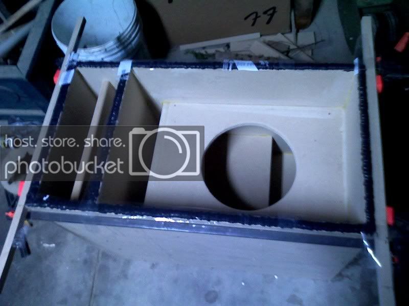

Thanks, Ill perfect it before I patent it and sell it. It was pretty good tho.
i've never heard of a 6th order box.. what are the benifits/weakness of this?
Best readup on it that I like is http://www.diysubwoofers.org/
you shoulda put lexan or plexi on the front to show off that beast!
If I had the money, I might have done it. I like to keep things kinda subtle tho.
That is a really nice box.Amazingly efficient.

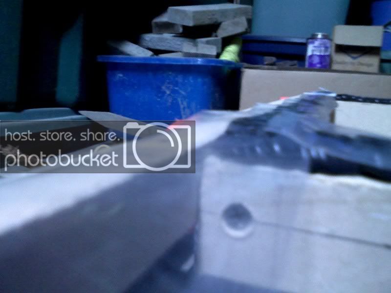

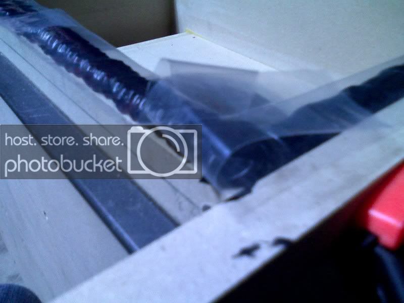

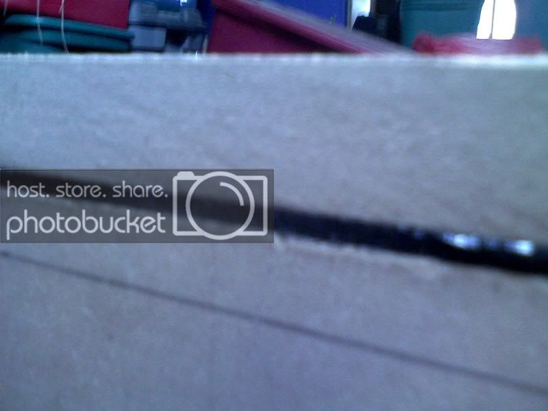

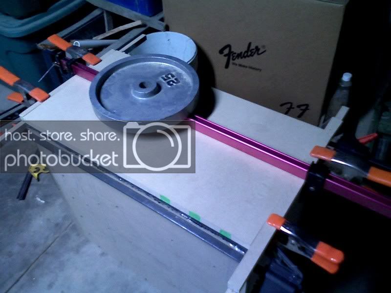

Making the gasket. I planned on it being in my car today but a setback caused otherwise. Anywho
Thats a ziplock bag cut to strips on top of the silicone.
Gasket will be 1/8"

Prolly so it doesnt stick to what he doesnt want it to stick to.
//content.invisioncic.com/y282845/emoticons/smile.gif.1ebc41e1811405b213edfc4622c41e27.gif
Zactly. Its how I make my ping pong paddles

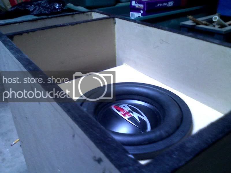

The box is finished for now. The only things left to do are for aesthetic purposes only (wood filler over the screws, carpet, painting the ports, etc) so those steps will be done down the road when I do the amp rack.
The box is a LOT better than my last one which was built to the suggested specs from the manual.
Awesome enclosure...
I may have missed it, but what is powering the RF?
Thanks, right now a RF T10001bd is powering it. I plan to replace it with a sundown 3k and run it at 4 ohms until the single 10" is replaced by two 12" ssa xCons.
