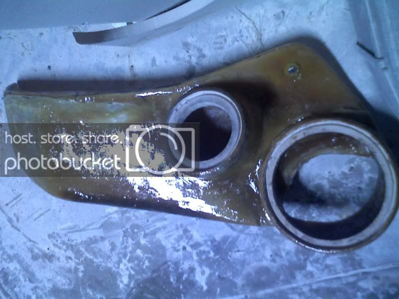

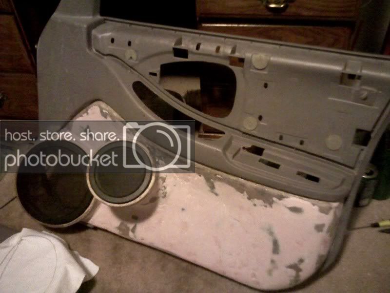

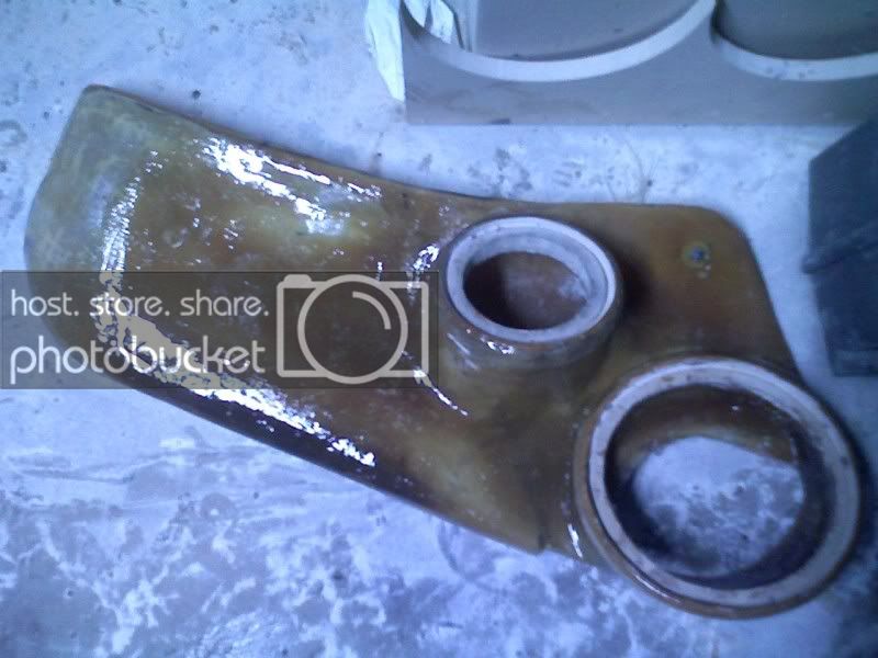

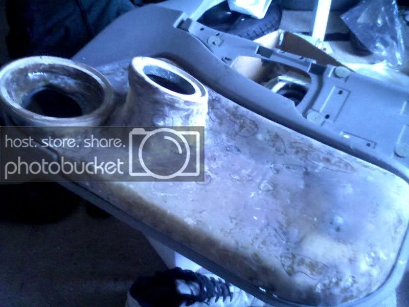

I just sanded everything down and did a test fit. Everything fits great and that interior piece no longer rubs. The glove box can fully open too. But I found a couple bubbles between layers that I'm going to fill before I set the last layers. Plus I haven't eaten yet and I'm really craving some burgers and Rallys fries.
Final touch-ups with resin
Lots of bondo for the first time, hopefully I'll use less on the next door.
A before and after (pre-carpet)

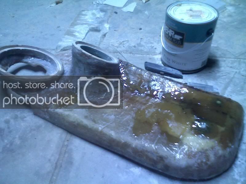

Oh what the hell, 1 pic of the latest progress.

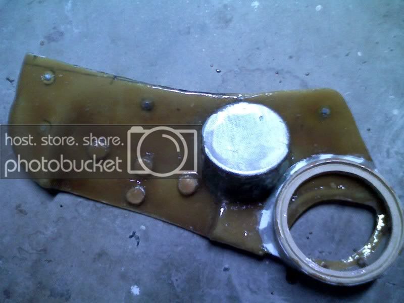

Main base: 1 layer of fabric, 3 layers of fg mat yesterday
Mid: 1 layer of fg cloth
8": 1 layer of fabric
I'm too tired to wait for the resin to dry on the rings so that's all for a couple days. I'm going to the beach tomorrow.
These pictures don't really show how much better and more smooth this one is coming out. It's almost all thanks to a new 4" grinder (with a sanding wheel I got for it) my dad got that came with a hammer drill he bought. It gets the job done in like 1/6th of the time that the 3" air grinder and orbital sander takes. But hopefully the orbital sander doesn't poop out on me during the bondo stage tomorrow.. it started to run roughly and slow way down even though there's only one speed //content.invisioncic.com/y282845/emoticons/frown.gif.a3531fa0534503350665a1e957861287.gif The grinder is too much for finer sanding and I don't wanna take 89 days by sanding by hand.

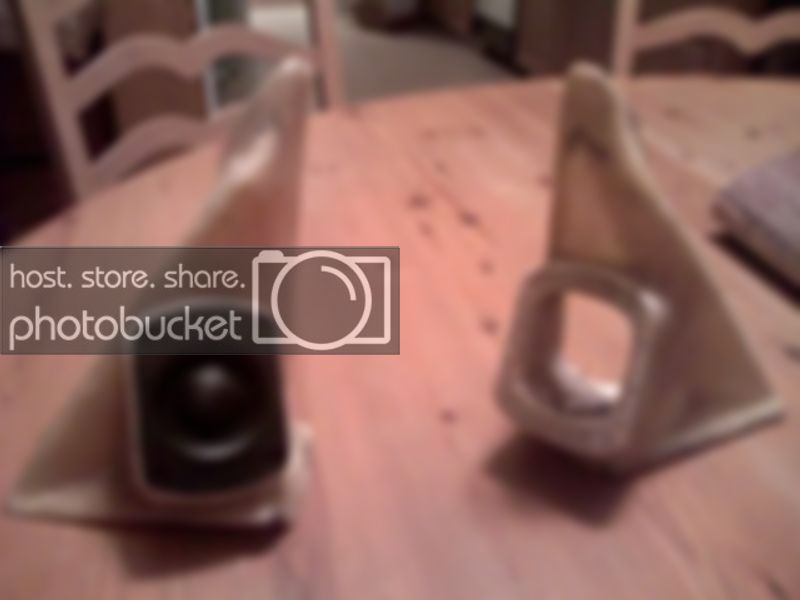

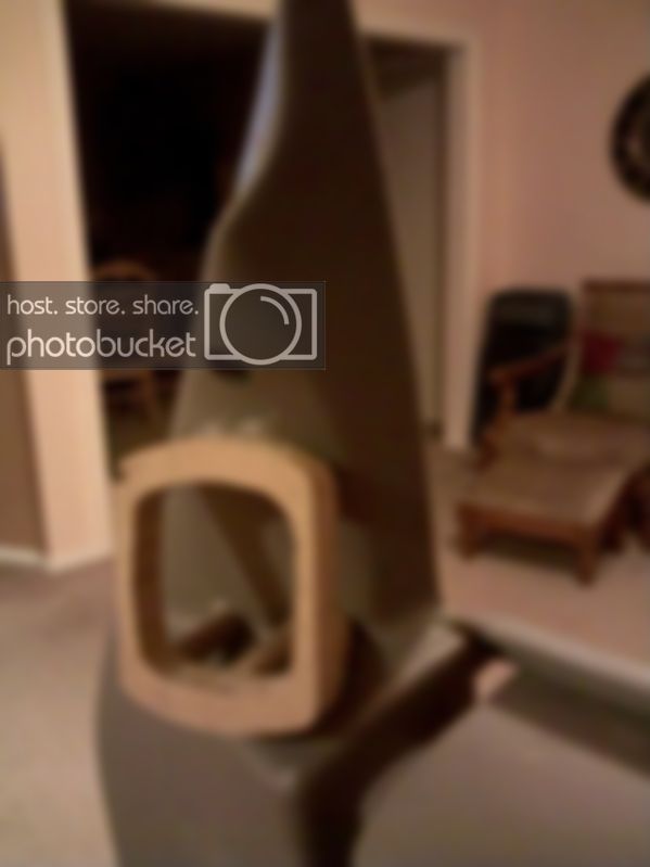

Started on the tweeters. I listened to them right next to the mids but I liked them up on the sails a little better. Maybe tomorrow or Thursday is when I'll finish the resin stage.
