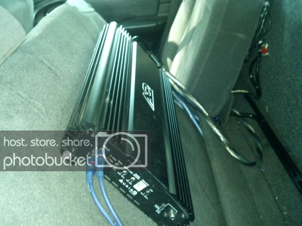

Audioque 2200 (installed)

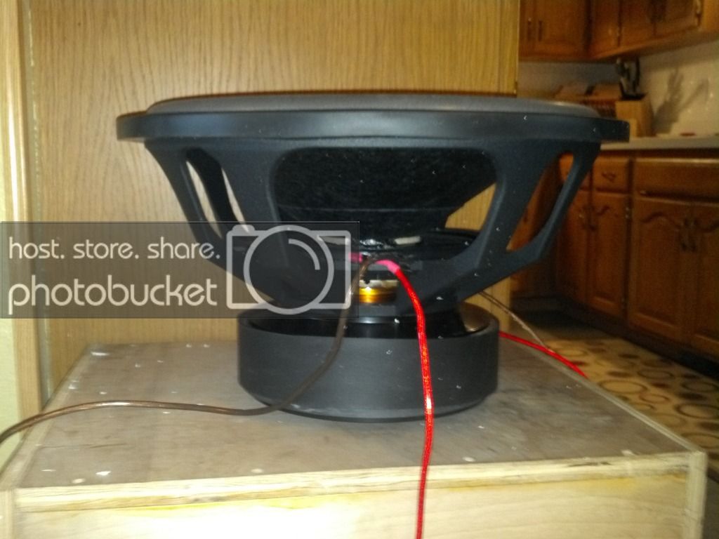

Audioque HDC4 18" dual 1 ohm (due here Tuesday)

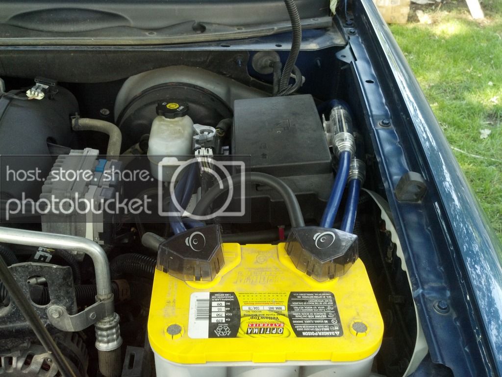

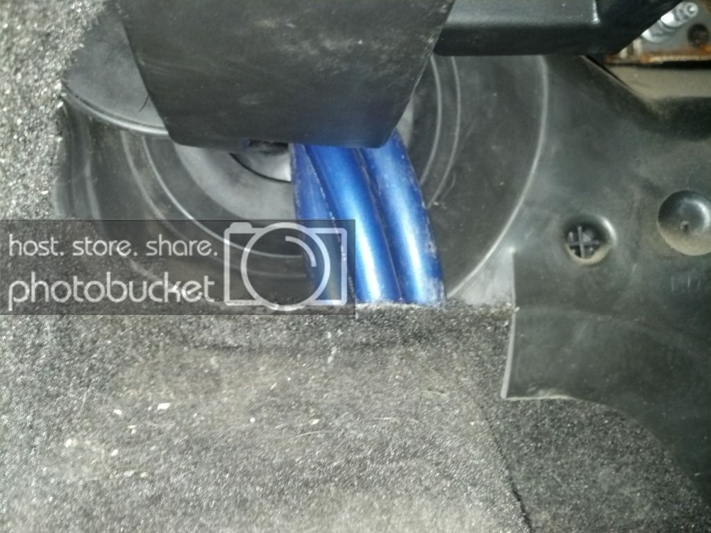

Knukonceptz KLMX 1/0 cable, 4 runs front to rear (installed)
Big three done with 2/0 welding cable (installed)
XS D3100 in rear (coming soon)

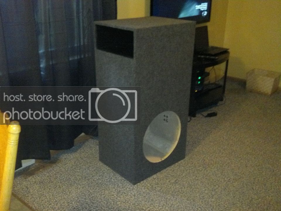

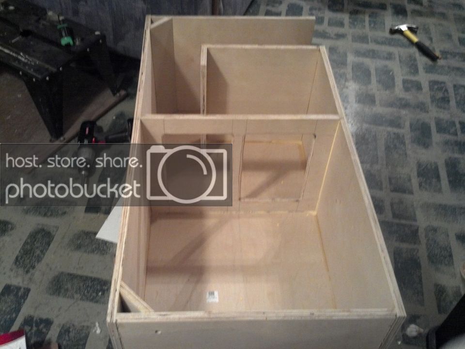

Custom sub enclosure (built but waiting for sub):
6ft^3 net
35 hz
108in^2 port

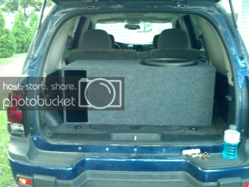

Pics: (will get some shots of the truck soon)
Favorite thing purchased for this build //content.invisioncic.com/y282845/emoticons/biggrin.gif.d71a5d36fcbab170f2364c9f2e3946cb.gif
Only shot before being finished:

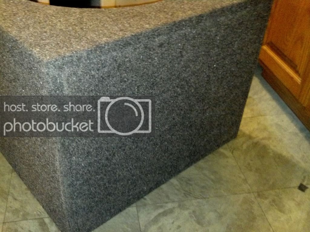

First time using the rabbeted side panel method for carpeting:

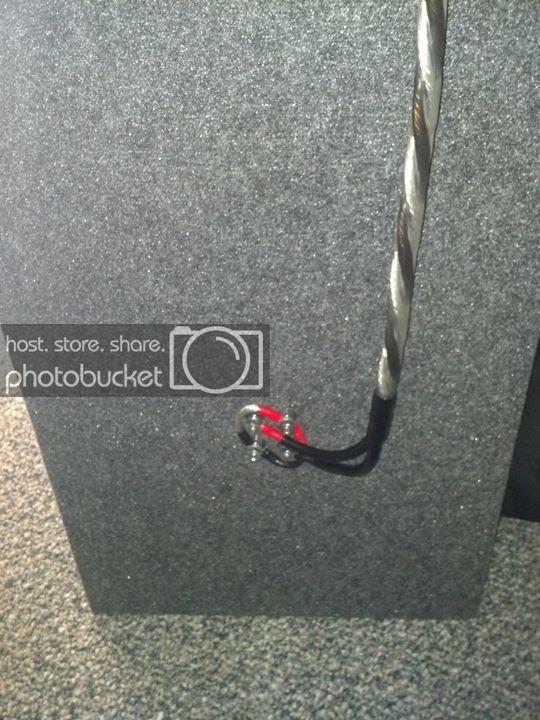

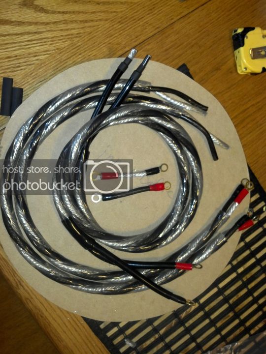

Love knukonceptz' 8ga speaker cable!:
That is all for now but this will be coming together soon. I will be running the HDC4 @ 2 ohms until the funds are available for electrical upgrades and then will be dropping it to 1/2 ohm. This should allow a good amount of time for the sub to get broken in.

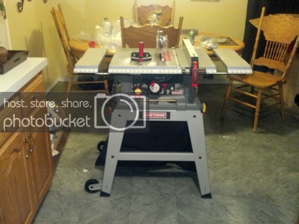

note with that table saw that the extensions might not be the exact same size as the main table. that is a concern when the guide overlaps the seam, then the guide can lose true perpendicular and you can get binding at the blade. it can be a PITA to cut some dimensions. the best thing to do is laminate a later on the extensions so they are the same size as the main table (usually they are a bit smalller) so the guide can overlap the seam and remain true.
cool box.
The fence doesn't square the best even on the main part of the table. I measure both the front and back of the blade always just like I would on any table saw.
