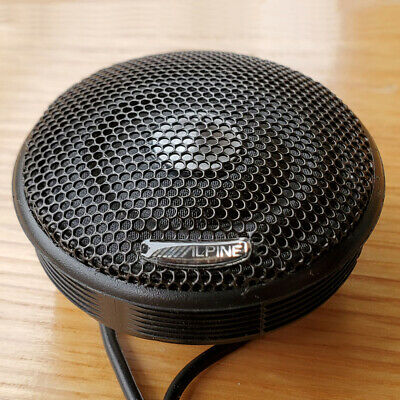

And then for the tweeters you have many options...The Alpines for 40 bucks shipped
Or a set of Massive CT2s
So if you went that route with the massives you would be at 825.00
With the Alpine tweeters you would be at 790 so 2 options.
