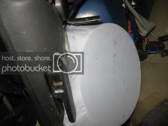

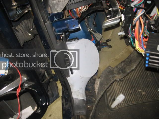

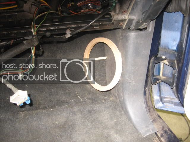

I guess Ill post some new pics today, some pics of the kick panels, and how to make them in a s10 forthe drivers side with what needs to be modified on the E-brake
sorry for the wait...
Ok I apoligize if the pics are shitty, the screen on my camera broke so ive been using the eyesit and i cant tell if theyre good until i get them on my computer.

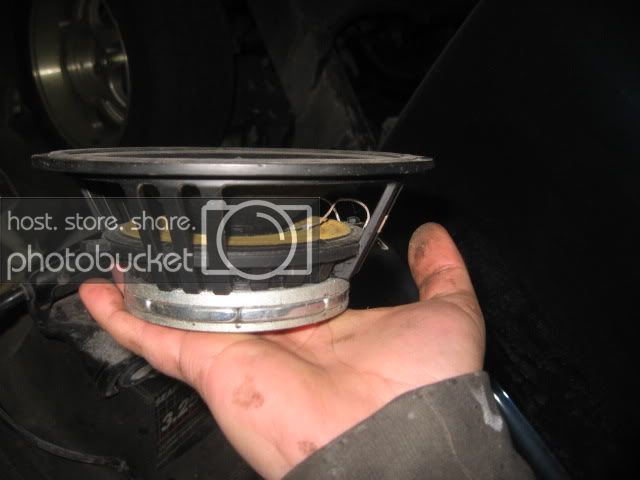

heres a pic of the new Pro series 6.5 neos - SST-654n

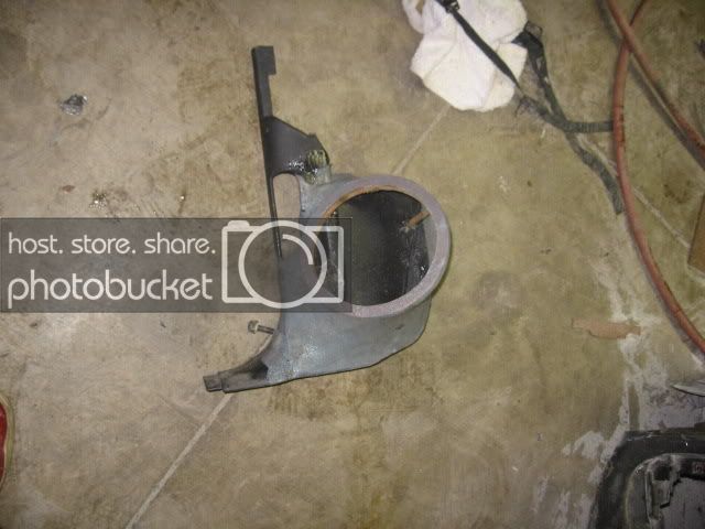

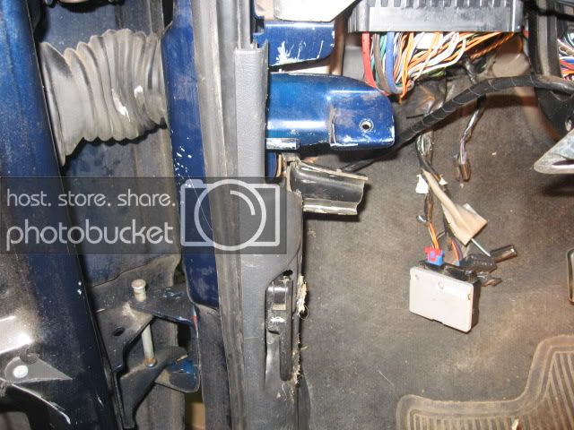

problem with doign kicks in the s10 is the e brake pedal, so what i did was I cut it and bent it so it clears, its not as easy to push it like before but its better than taking it out.
