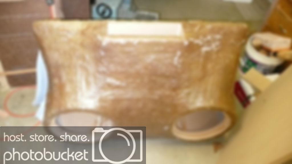

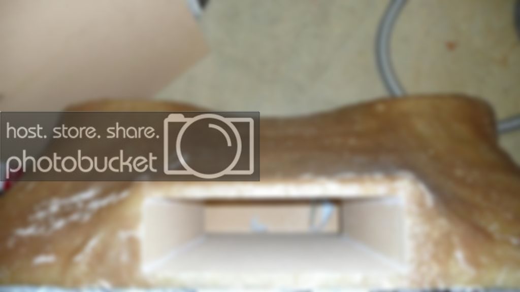

This is just a ****ing waste of equipment right here. You have NO IDEA what the tune is of that box, no idea. You guessed? Shit dude go in Winisd and plug in some numbers and see how a few points of c/ft of volume change the port dimensions.
This is just a plain old waste of good equipment and potential
Like someone said, you should have built it sealed, fill it with packing peanuts to get volume, then spent the $50 on a beautiful aeroport
well 1st off. **** you. second, its pretty **** close to what i wanted it. it wasnt a guess. ive been building boxes for a while now, i know what im doing. and **** winisd, that program blows. if you know how to do math you dont need a program.
dont tell me what i do and dont know about my own work. you were not here when i designed it. you dont know any thought that went into building this. dont come on here acting like an *** hole for no good reason.
thank you jdawg. it may be off by 1hz +/- but like you said, wouldnt be able to tell a differance anyway.
sorry if i over reacted but im putting a lot of time and money into this and that really pissed me off.
No, it wont be off by 1 hz dude, the difference will be huge. And yes you can hear the difference 5 hz in tune will do and can put a sub WELL out of sounding good and using it to its potential. Fill that port and put an aero in there, ur not far into the build yet.
Do it properly
You just wanted a "cool" looking box
no i did the math and i know im not WAY far off.
it should be at 4cuft. tell you what, when im done ill fill it up and if its way off you can laugh at me and say "i told you so".

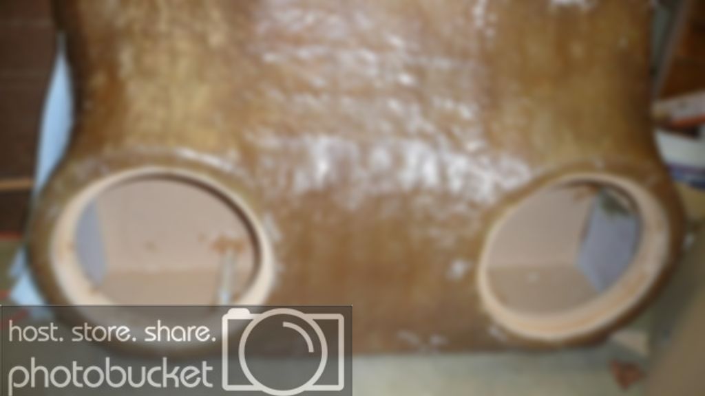

WAY too much resin. When there is too much resin in any fiberglass piece, the strength the fiberglass WOULD have slowly decreases, as resin is very brittle by itself. The lack of reinforcement makes cracking almost inevitable.
Also, you should do all of your fiberglass layers in one sitting, and use MINIMAL resin, just enough to wet the mat out. A roller helps with this. If you absolutely MUST do your layers in different sittings, sand the dried layer before applying more mat.
What weight mat did you use? What brand/type of resin? How many layers? I would be very skeptical about using alot of power in that box. I would add layers around the insides of the rings for extra strength.
Edit: Lot's of air bubbles, as well. These are weak points in fiberglass, grind them out and fill them with glass (correctly) or with a fiberglass reinforced body filler, like Duraglass or Kitty Hair.

lolz, last time I checked you didn't know how to do the big 3, yet alone build a proper box. What OP did is somewhat common practice when making a FG enclosure. You can never be perfect, just try to get something to aim at... and if somethings off, he can alter it.
Do it properly
Even if he uses an aero, he'd still be guessing the space, and would probably get the same tune //content.invisioncic.com/y282845/emoticons/laugh.gif.48439b2acf2cfca21620f01e7f77d1e4.gif
Idskot i agree, WOT you still call car audio ICE, quit being a ***.
But OP you are no where near painting that shit, you need alota body filler and alot of sanding. You might be painting next week lol
But a good way to measure volume of a fiberglass enclosure is use something like packing peanuts, get a 12x12x12 cardboard box and pour the peanuts in it to get a reasonable guess.
