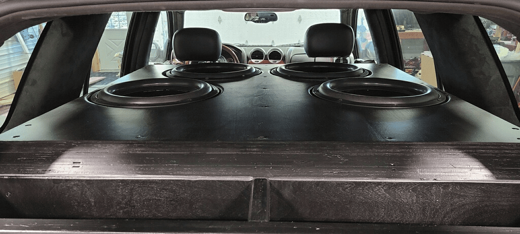

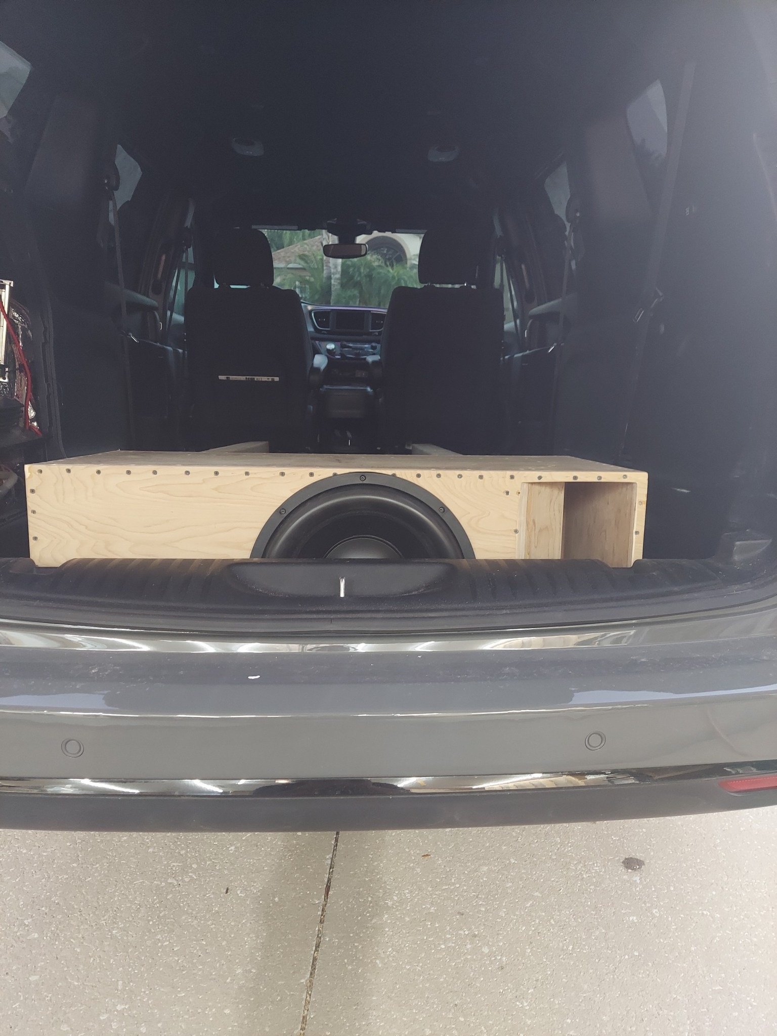

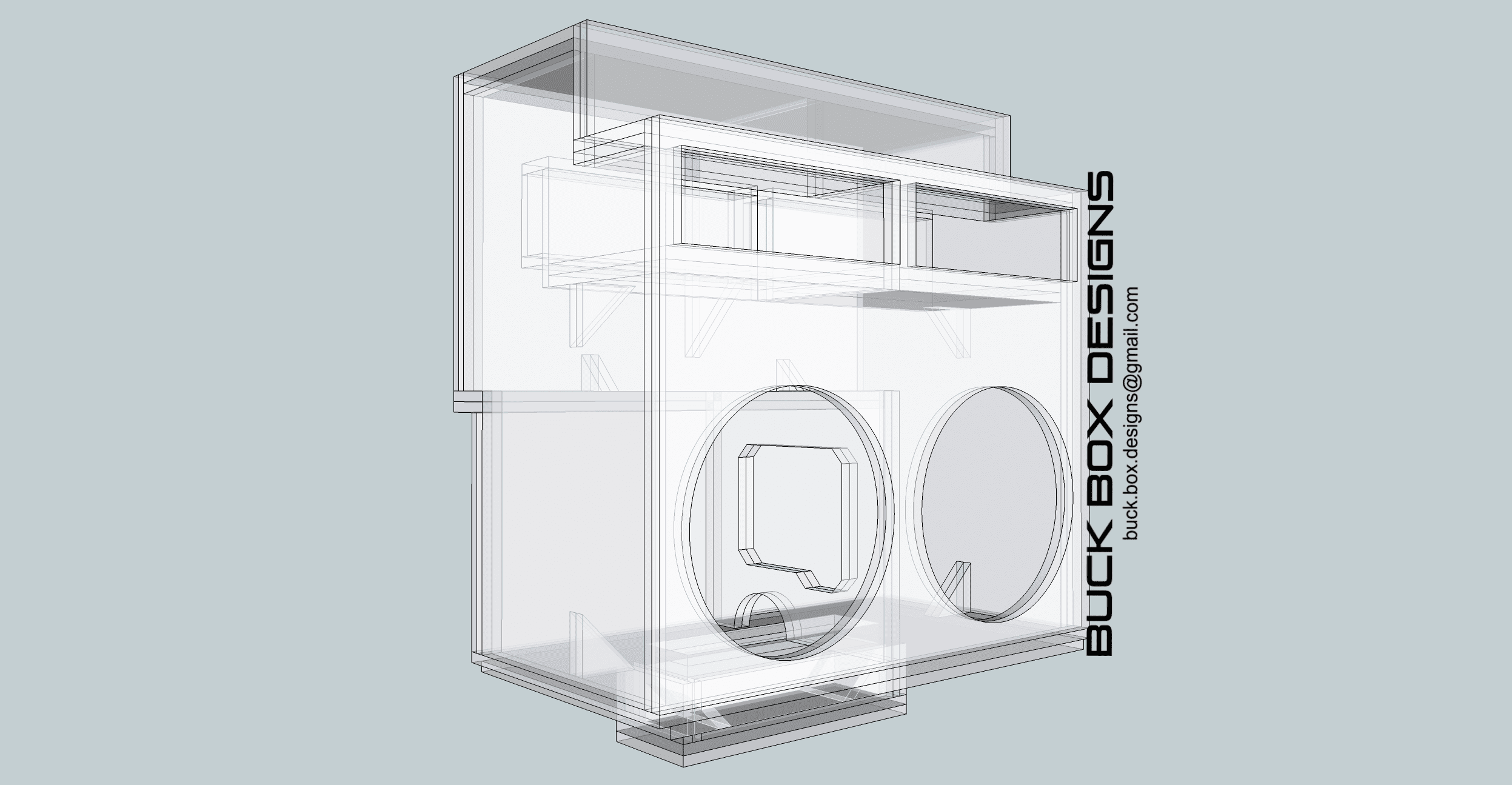

I design boxes in attempt to make certain pressure zones in the vehicle.
33956
Every single little part of this box, for a good example, is designed to create staged pressure zones from the back of the sub's cone all the way to the front of the vehicle. The subs are spread out in the exact fashion they are because I wanted them to pressurize a certain way both internally and have the air over the top of the subs flow in a certain way, although it was more an internal sub layout decision over anything else, in relationship to how my port was laying out. There's a huge reason why the port stops short of the baffle and the baffle is angled like it is, and why the subs are all the way at the front of the box and not like centered in the middle or something. This isn't just a ported box with an airspace and a tuning that I just threw together. I went through about half a dozen port styles before I settled on this one.

That is what I was thinking with the sub and Port up design. The enclosure itself is far more rigid than the rear hatch and you want to concentrate that energy upward into the more rigid area yup.

I love it, this is like school only the classes are way way more interesting. That's why I'm more than happy to let you look at all these variables and design me a box. Take my money lol it really is all about the install and mastering those variables.

I still got an old 18-in ascendant audio chaos, in the box sealed up I could switch that over to my Honda and pull the SQL 12s out of it and run four of them in the SUV that would work out about right with a slot port design like that. 4sql 12s on a 5k @2-2.5 cubes each should do pretty good on music. Just a thought

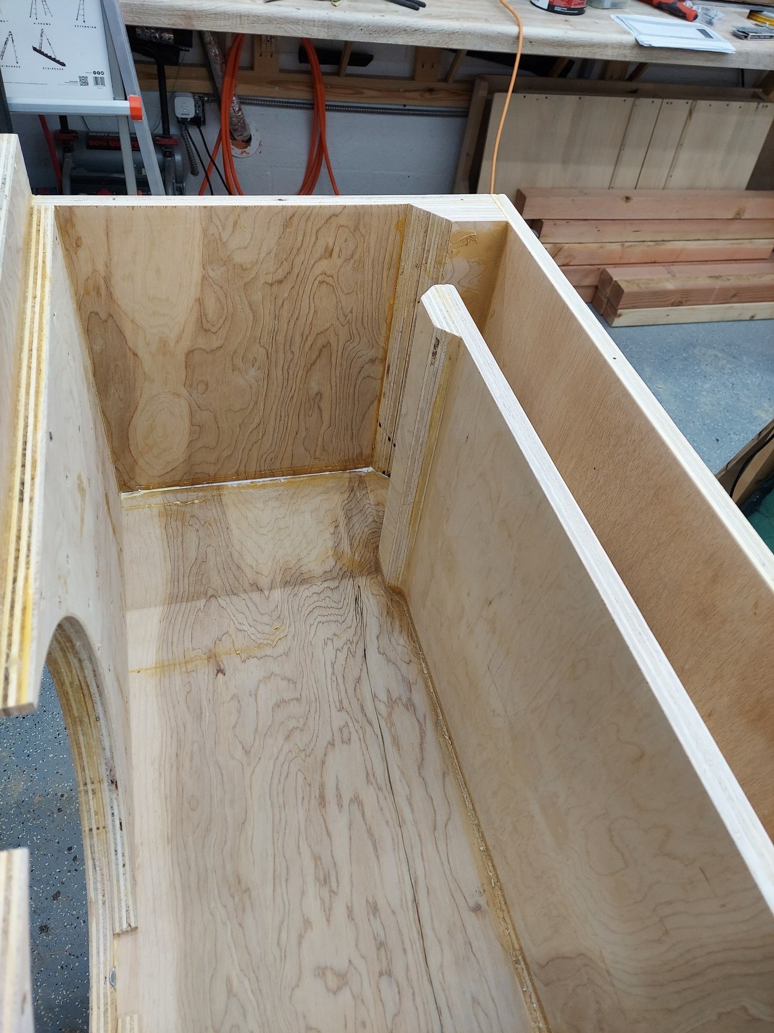

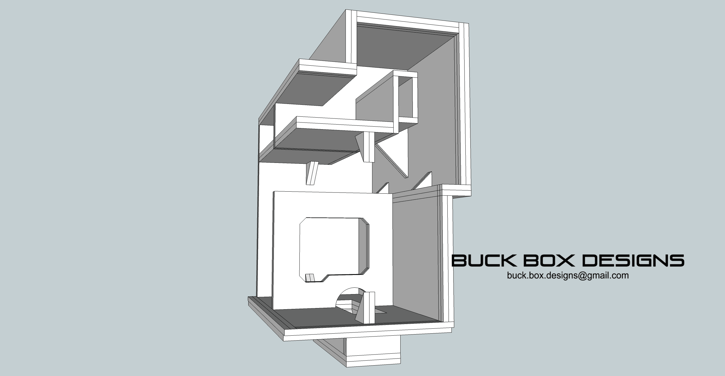

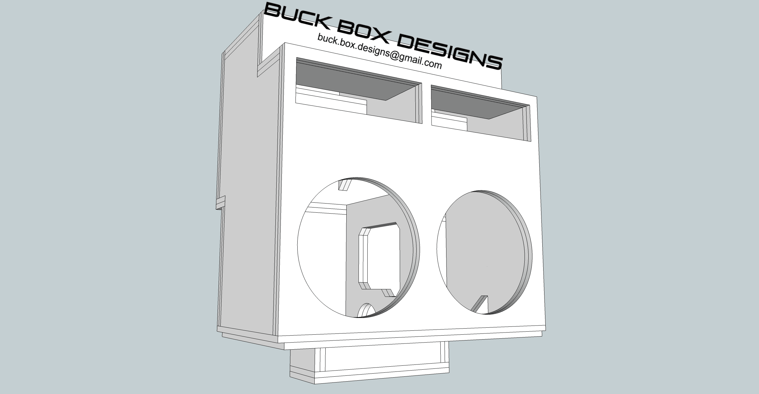

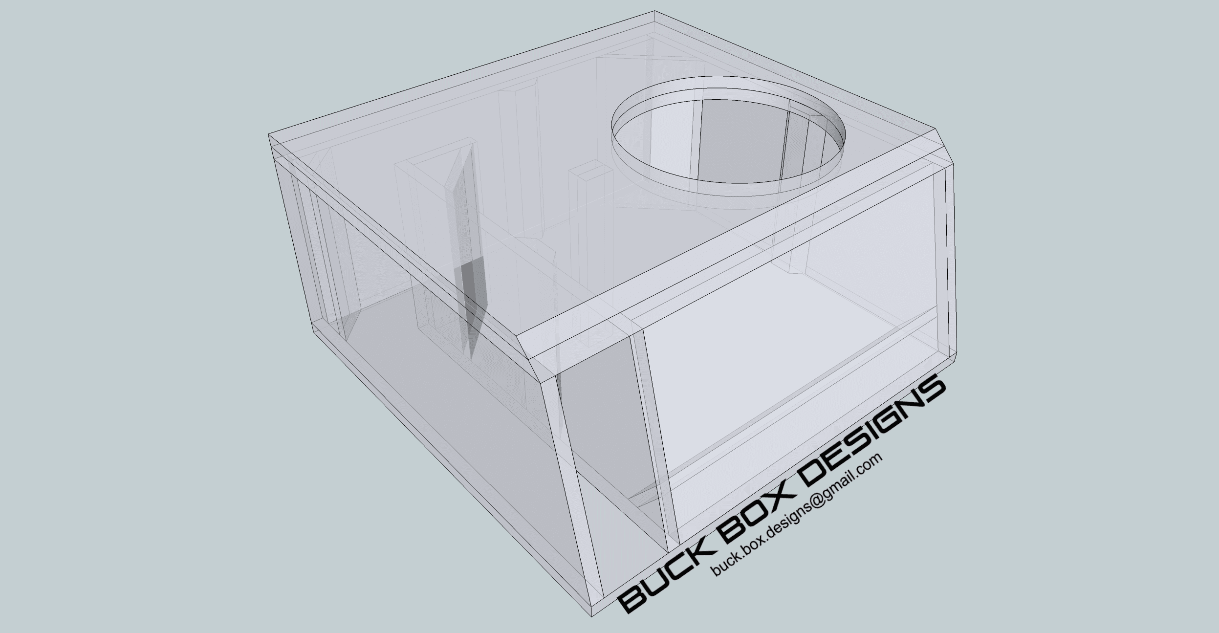

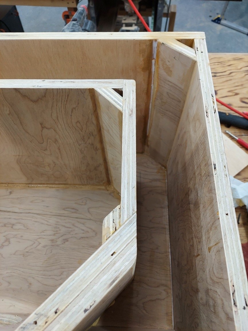

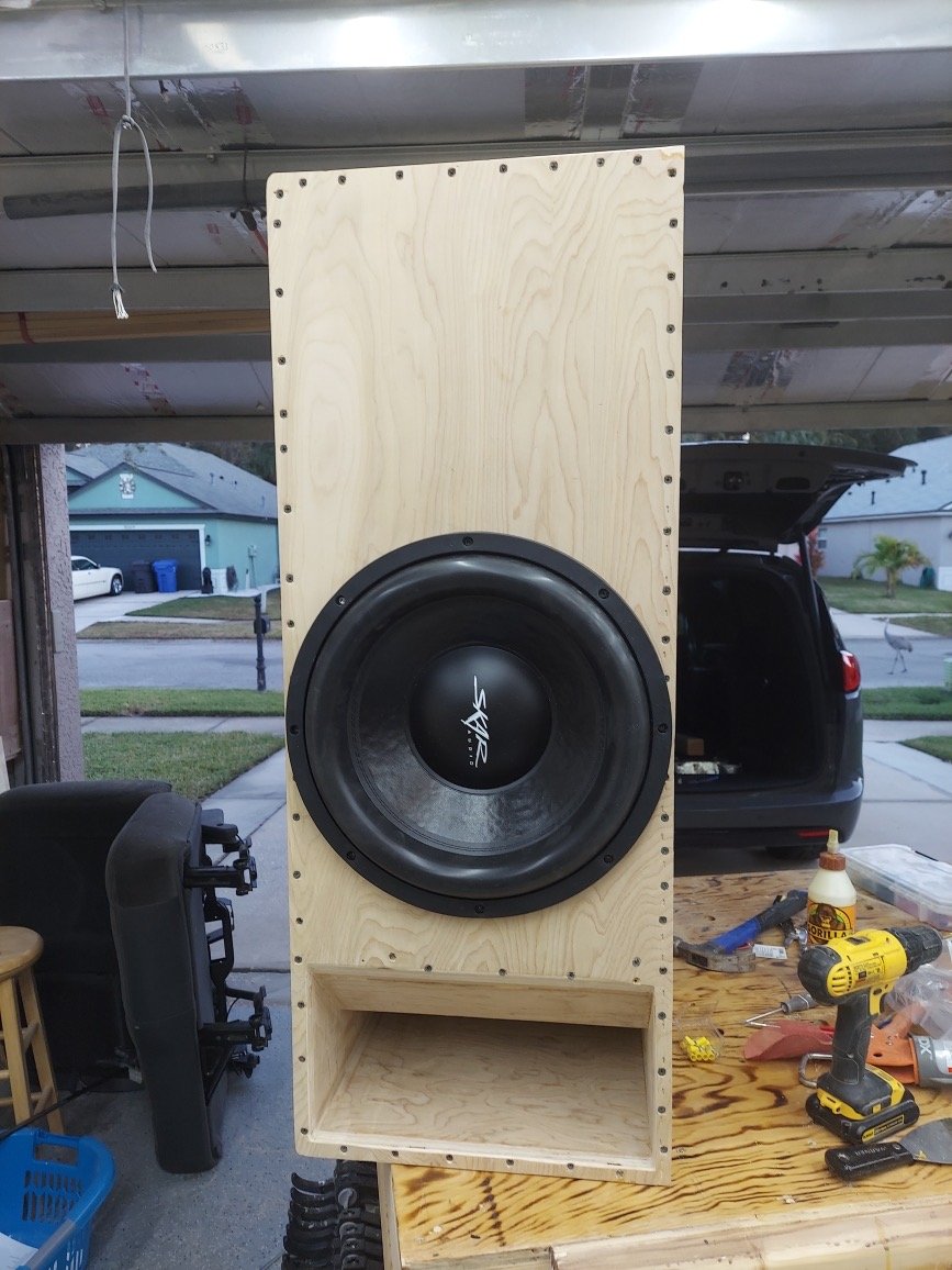

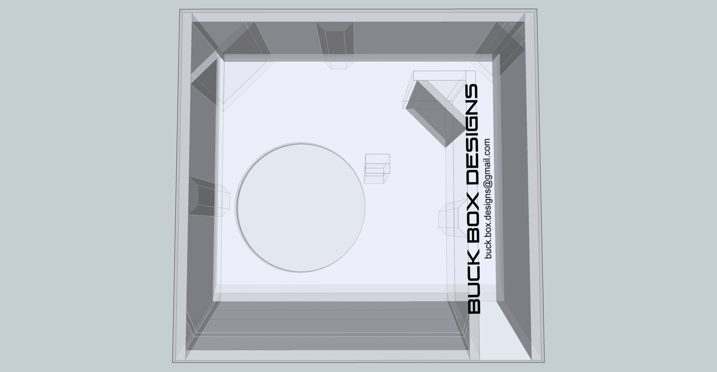

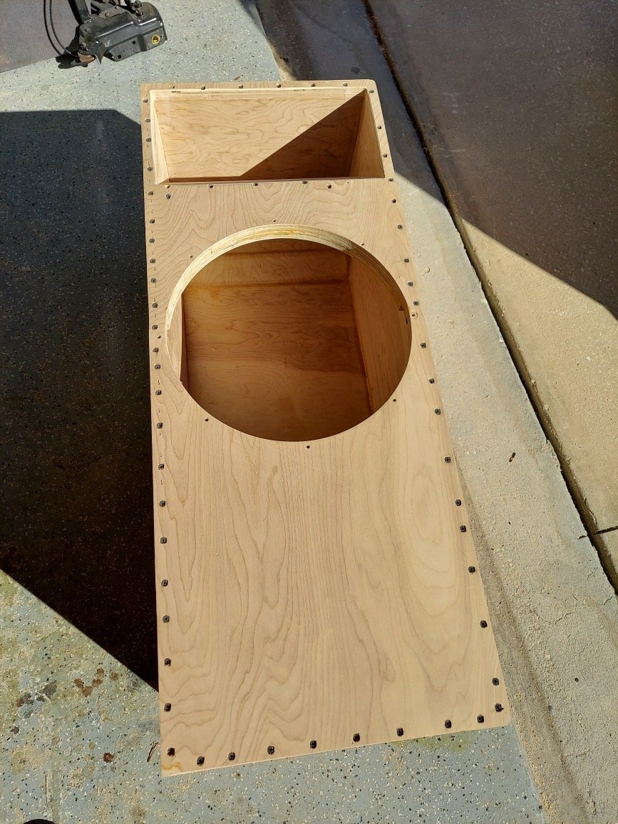

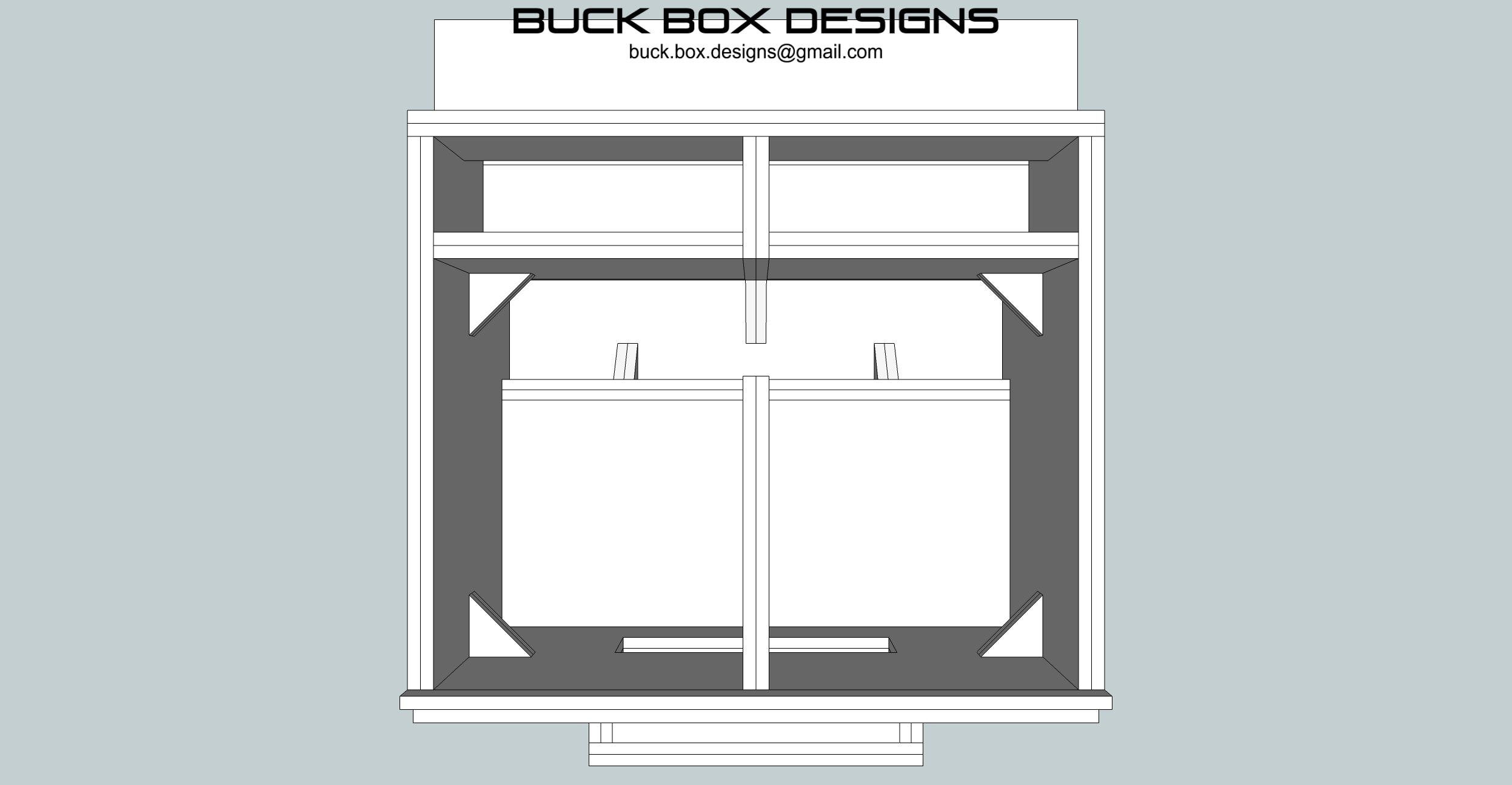

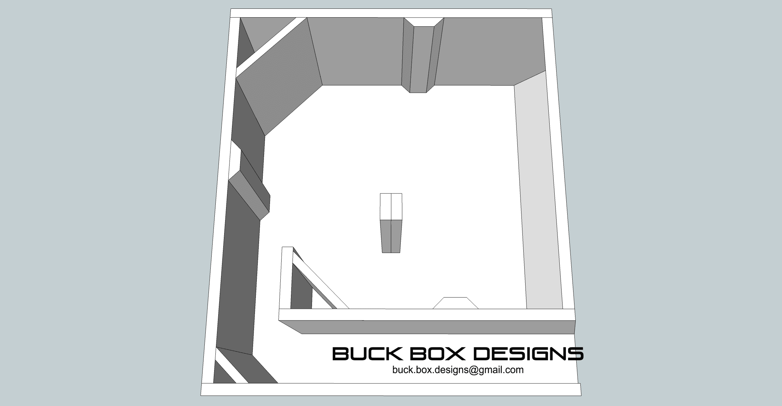

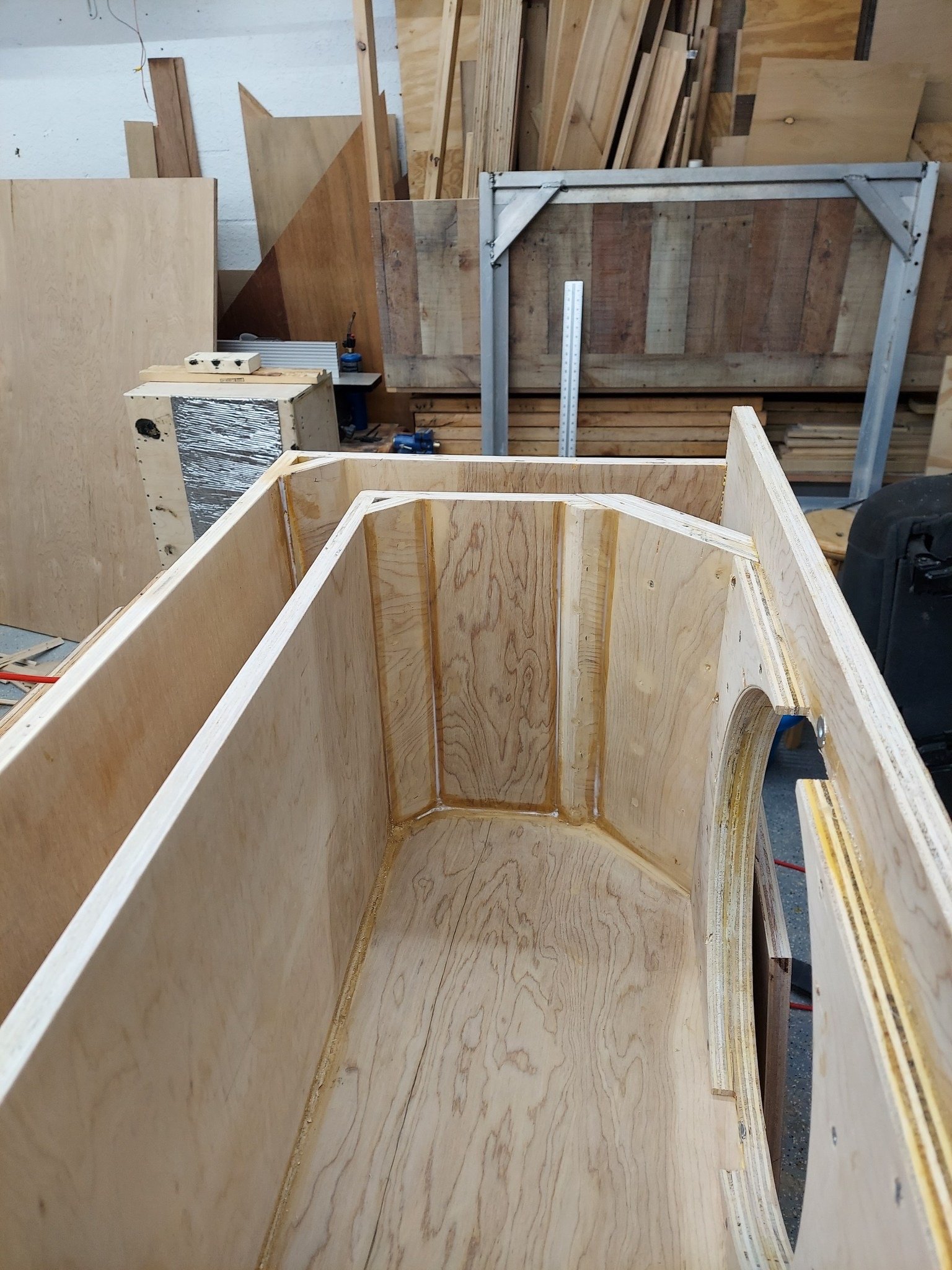

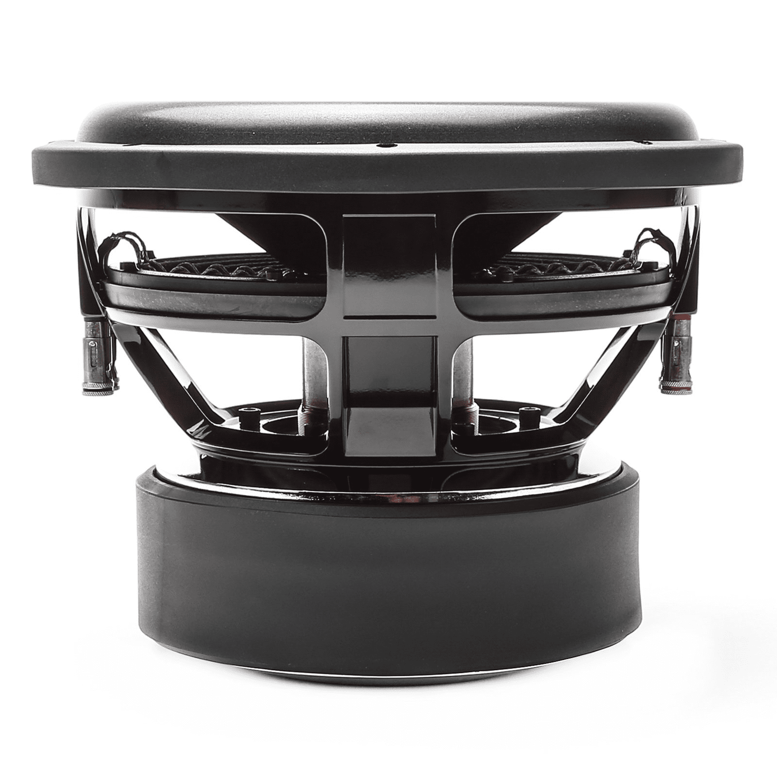

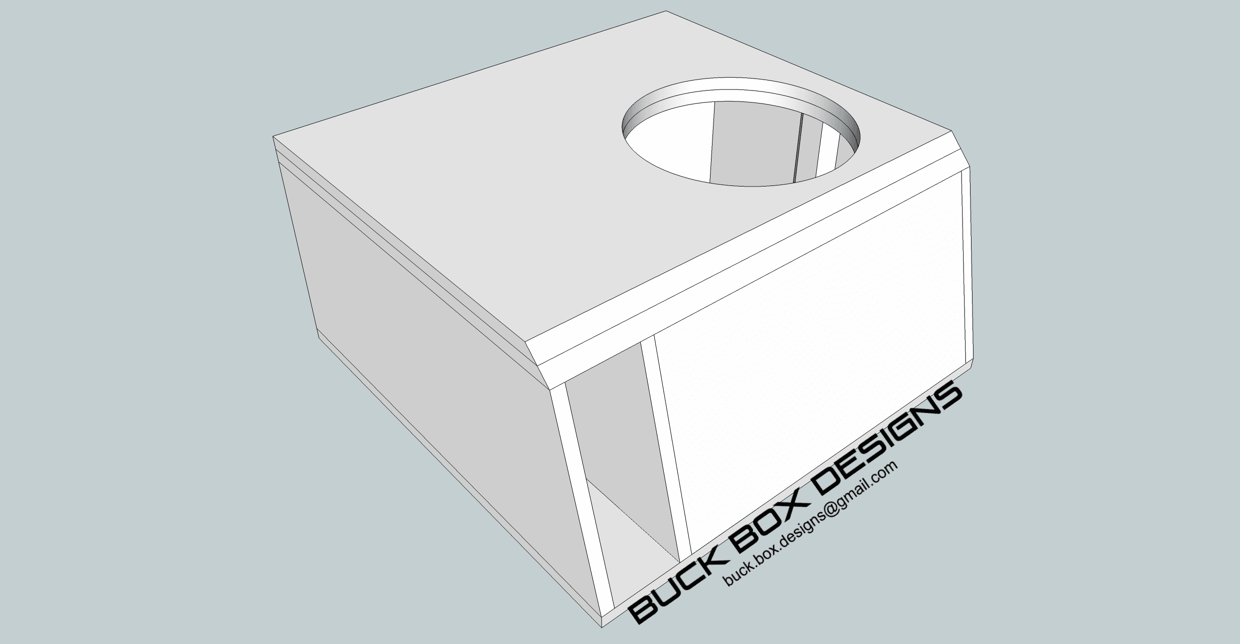

Sundown Zv6 18 ported going in the back of a small wagon.
This box is tuned super low, and the sub is on 3kw+. Almost all of this box is 1" thick sheet wood, except for the corner 45's. Should do some damage.
