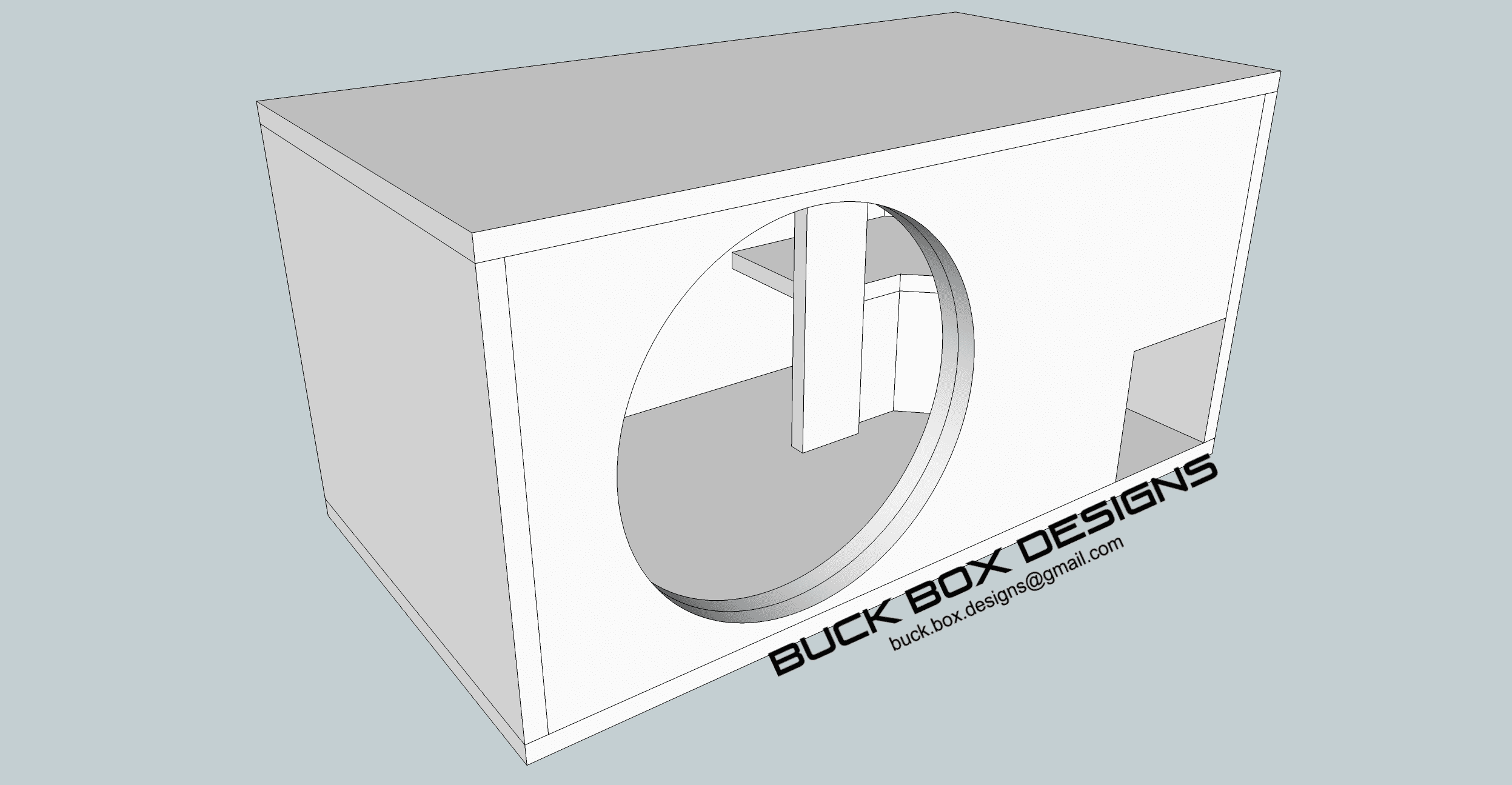

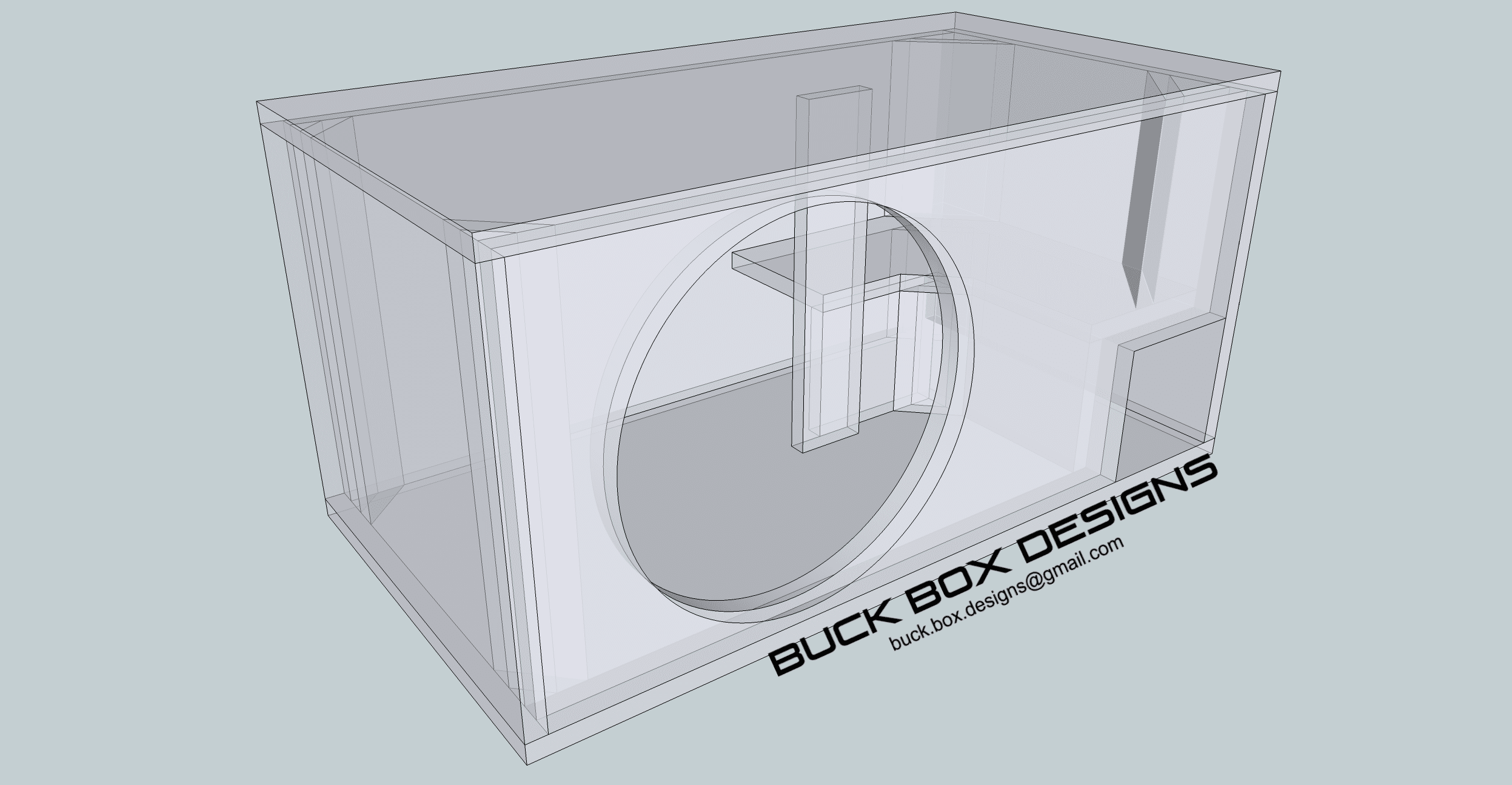

Skar VXF 15 ported going in a minivan.
33752
33753
33754
33755

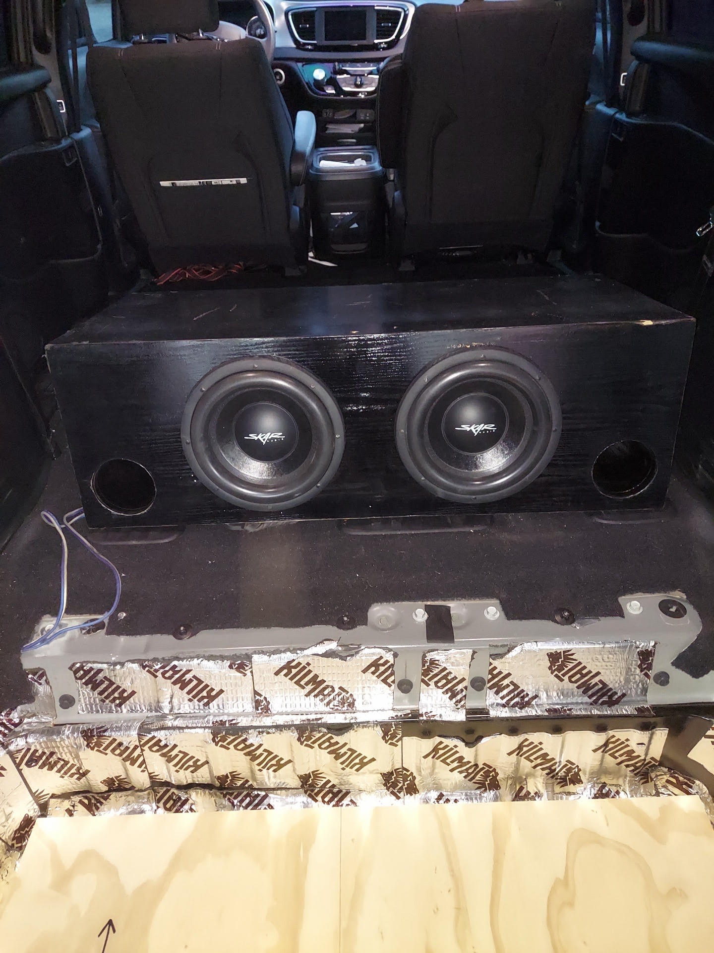

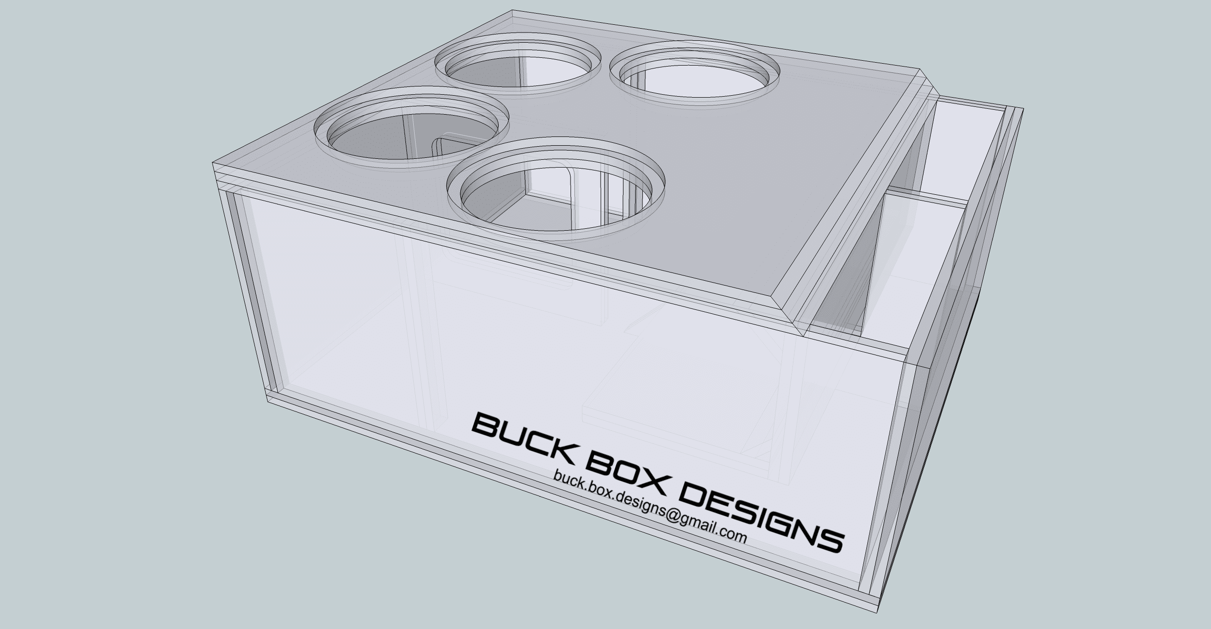

This is a 2 Skar DDX 10's ported box that I designed and my customer built for a van.
This was a design I did back in February (2021), iirc. I had no idea how the design turned out until now. It's a weird/cool setup, because the sub box sits down inside of this giant well in the floor at the very back of the vehicle. The box isn't in it's large floor-hole in this pic. Customer said the box turned out well. I'm glad, because I was interested in how the box would play, exactly, being down in that hidey hole.

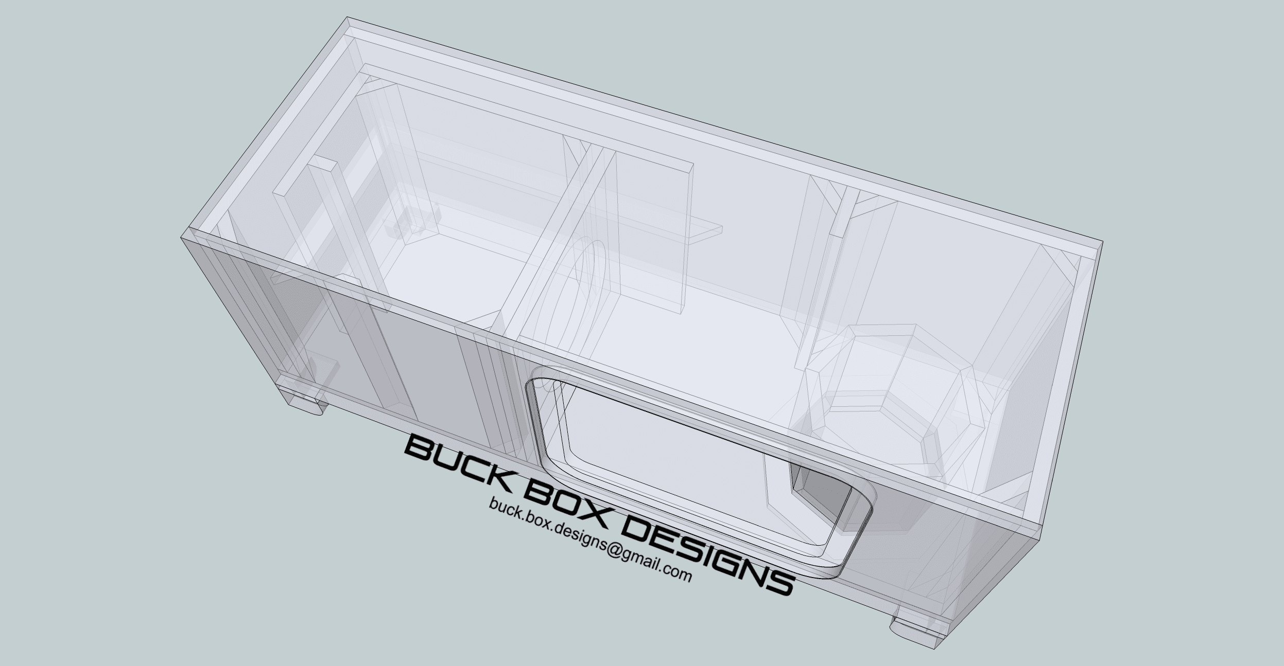

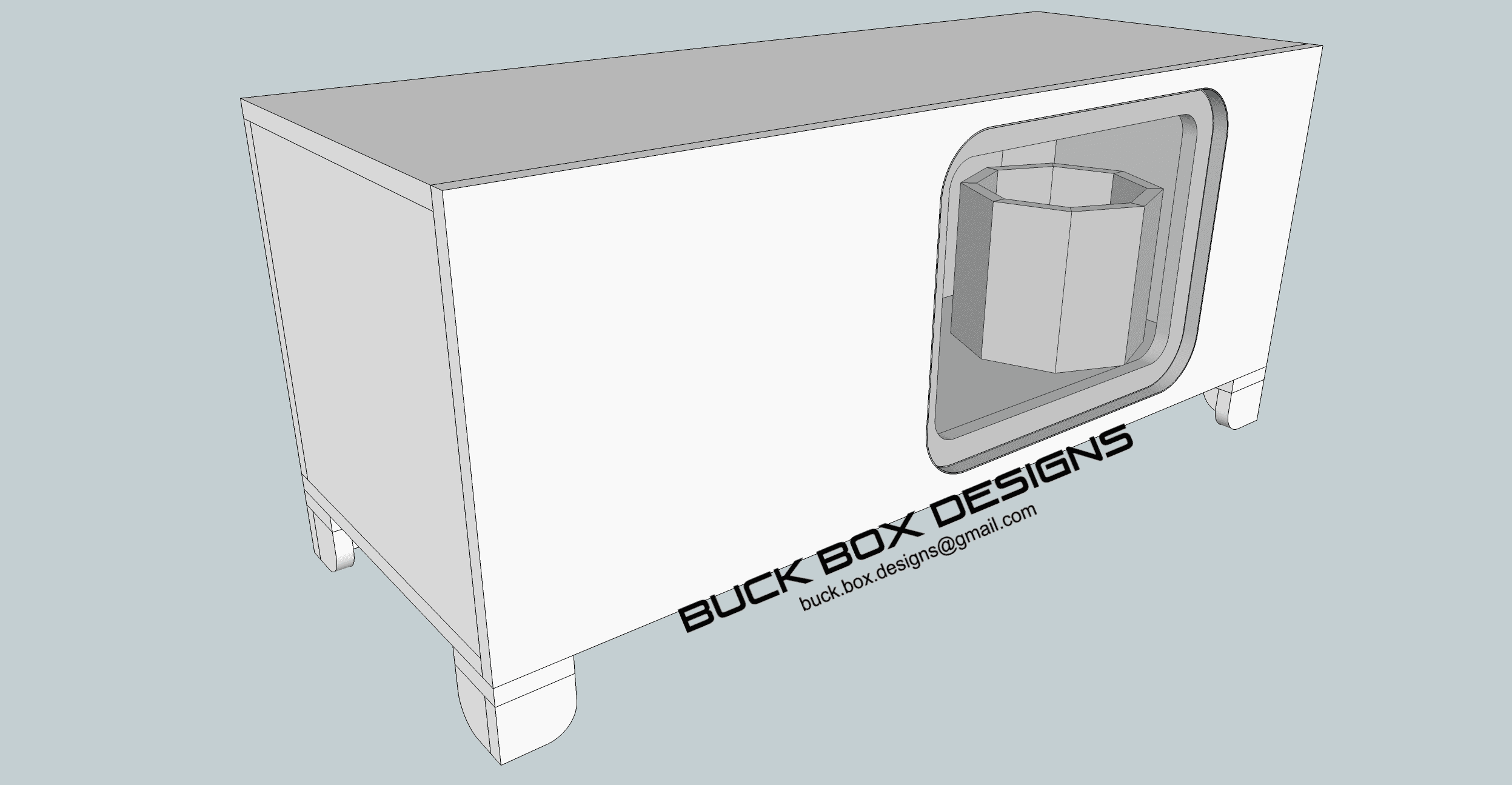

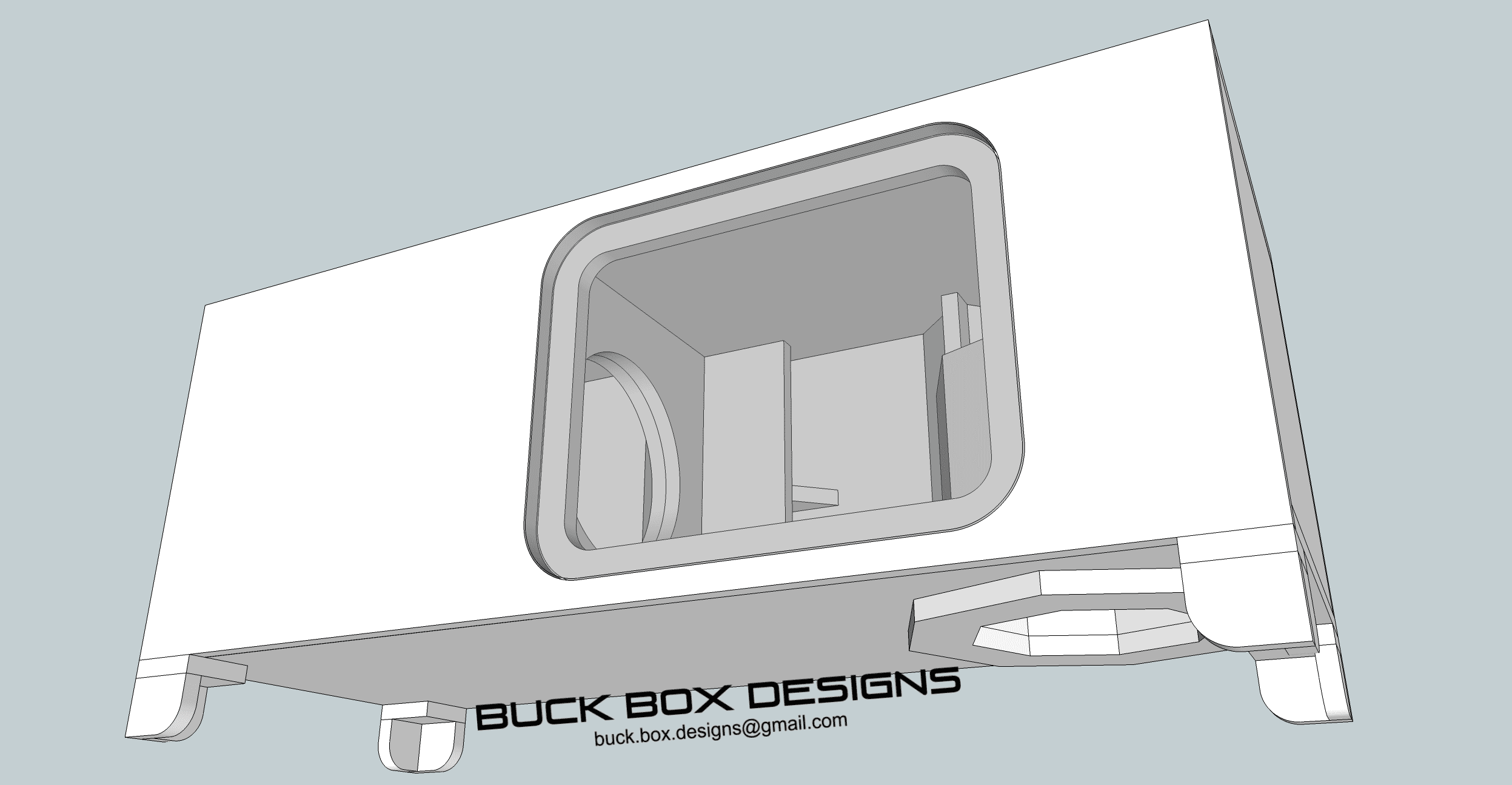

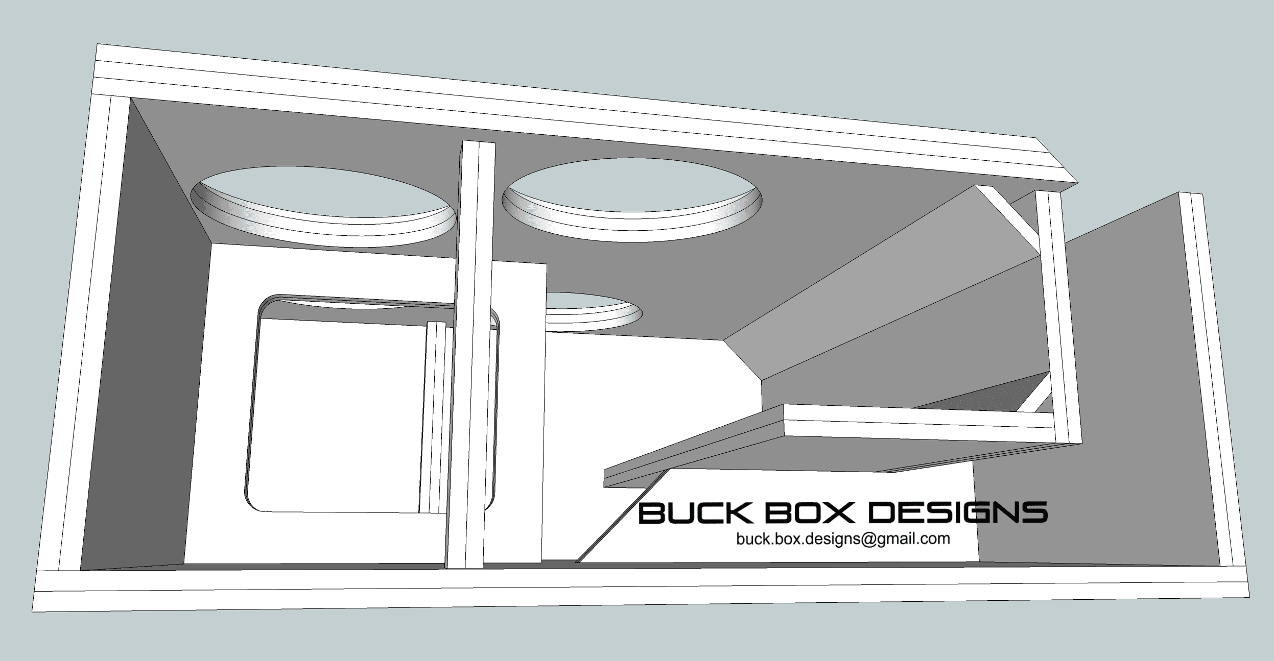

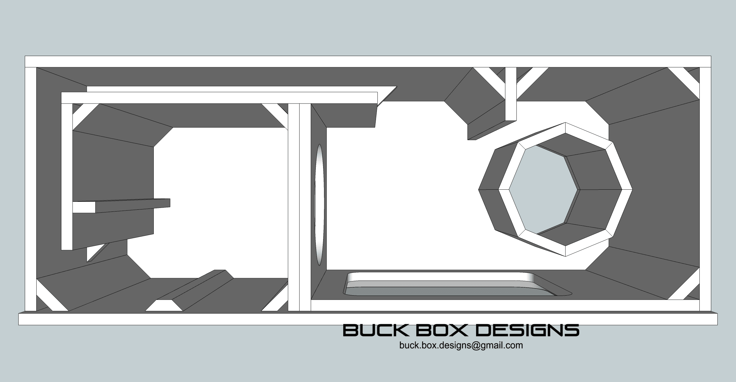

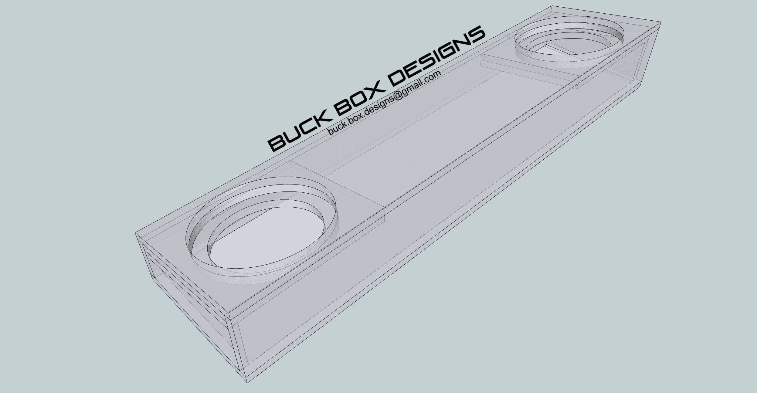

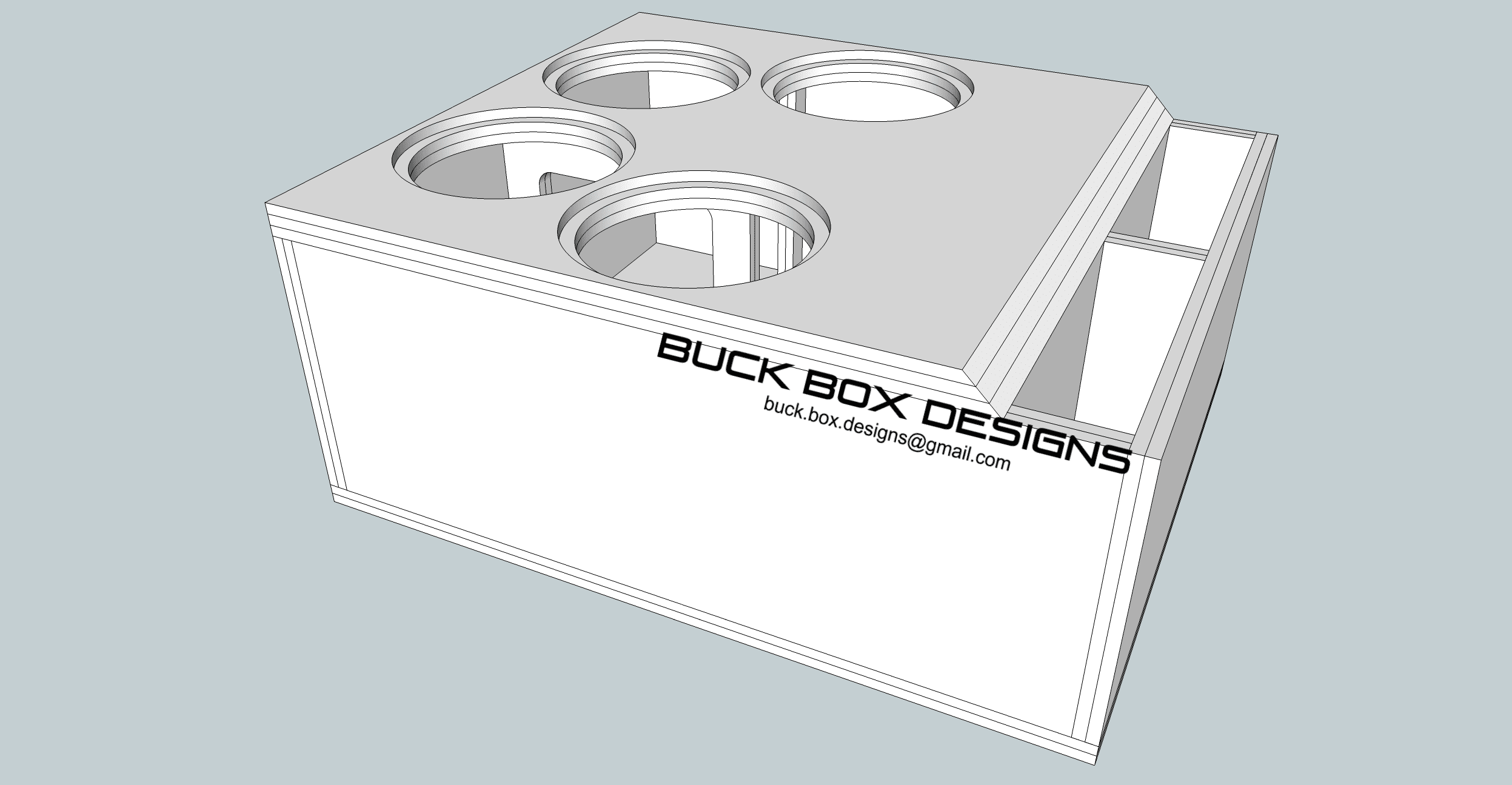

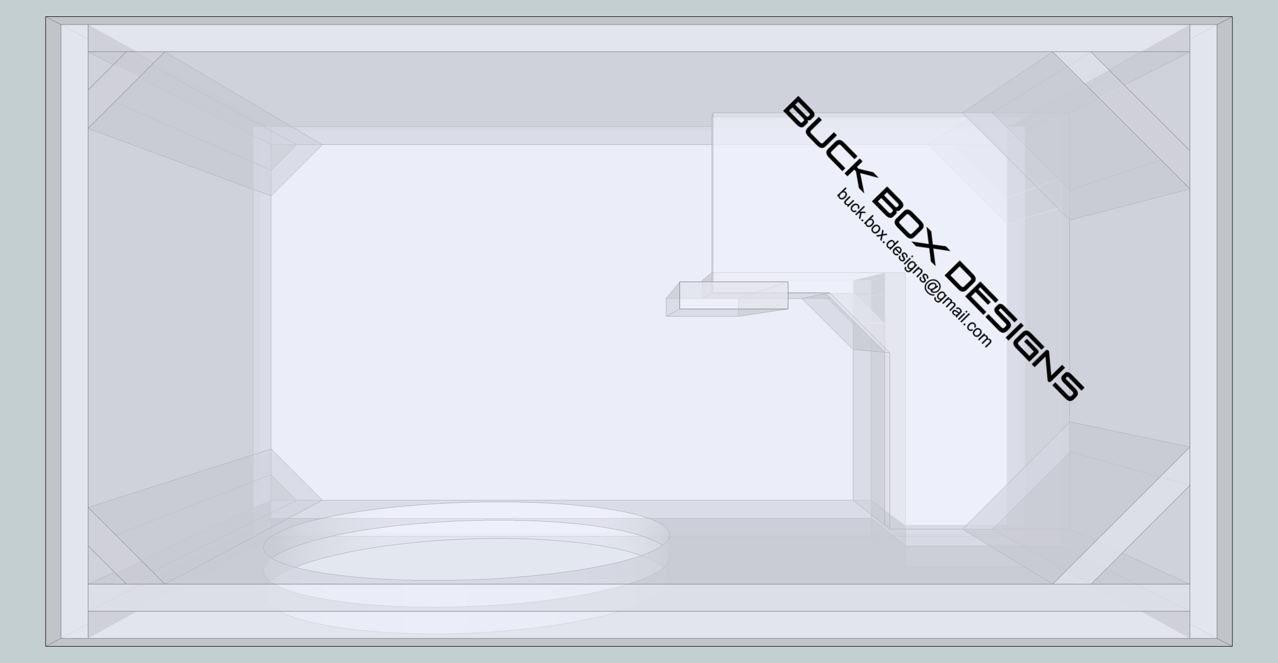

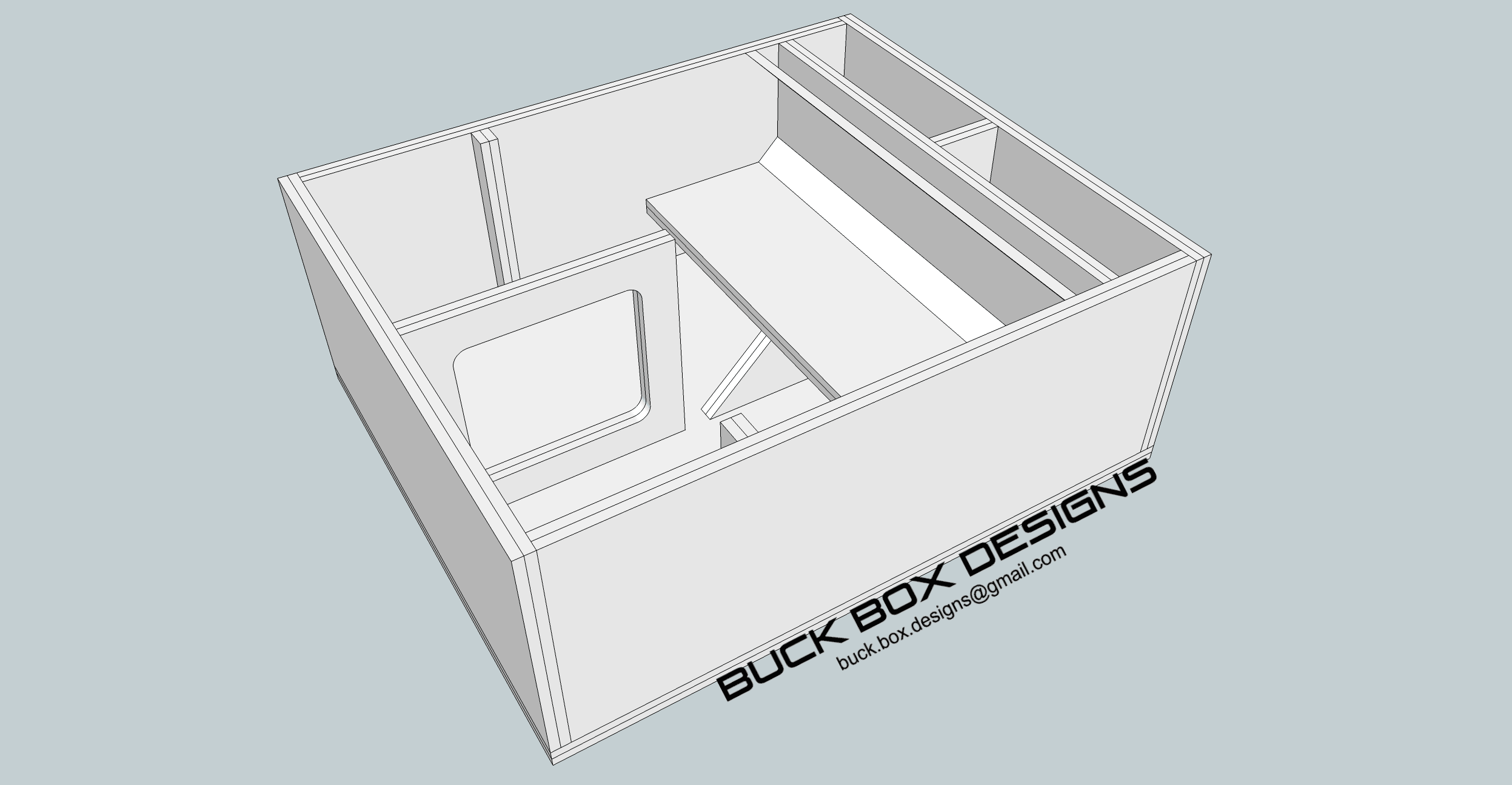

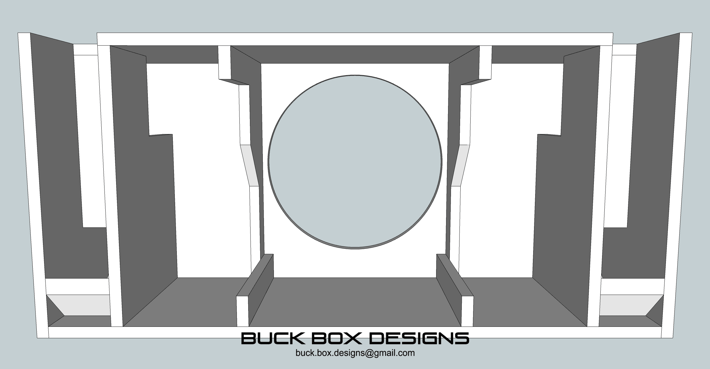

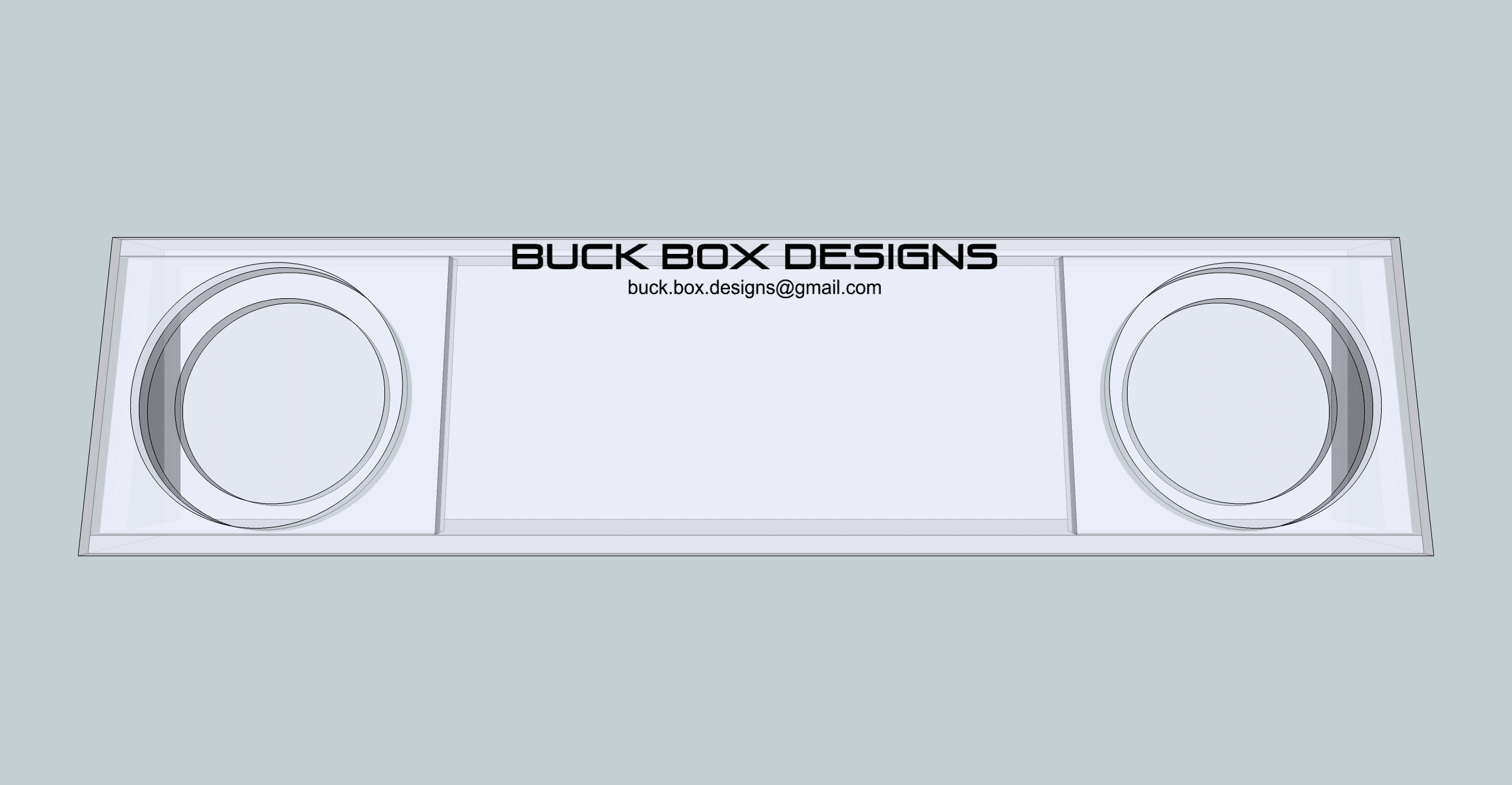

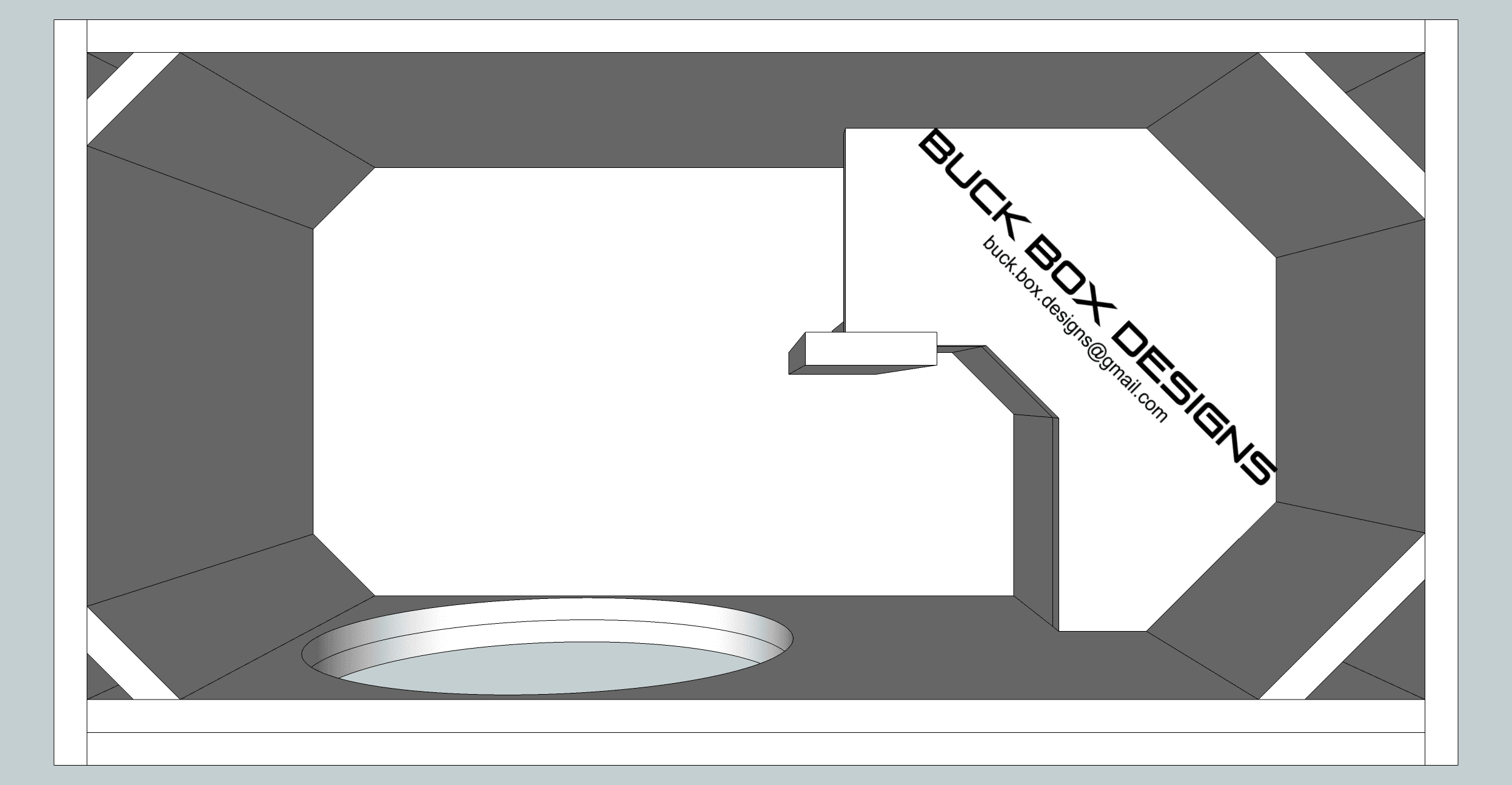

SoundQubed HDC310 series 6th order downfiring bandpass going behind the rear seats in a mid size SUV.
I want to hear this one, for sure. I got to kind of have a field day. Idk why I always try to push myself haha. Sometimes I use a lot of energy really trying to perfect a box (in my eyes), based off what's wanted for the sub system and the physical dimensions. Sometimes it's better to go a little slower with audio and let the whole situation absorb into your mind, then a picture will appear. Like, I just listened to what the owner said, and then I let it flop around in my mind until all the pieces aligned, and this box is what made sense to do. I didn't have to do the octo, but I wanted to do the octo. I think octo's are very strong with better efficiency than a square or rectangle port. I think flared aeros & round ports would only have slightly more efficiency. Octoports really aren't hard to build, if you ever want to do one. I built like a 10" diameter octoport for a 4 15's box once. The only think is, if you want a really good octoport-hole, you need a plunge router. Good luck cutting an octohole with a jigsaw.

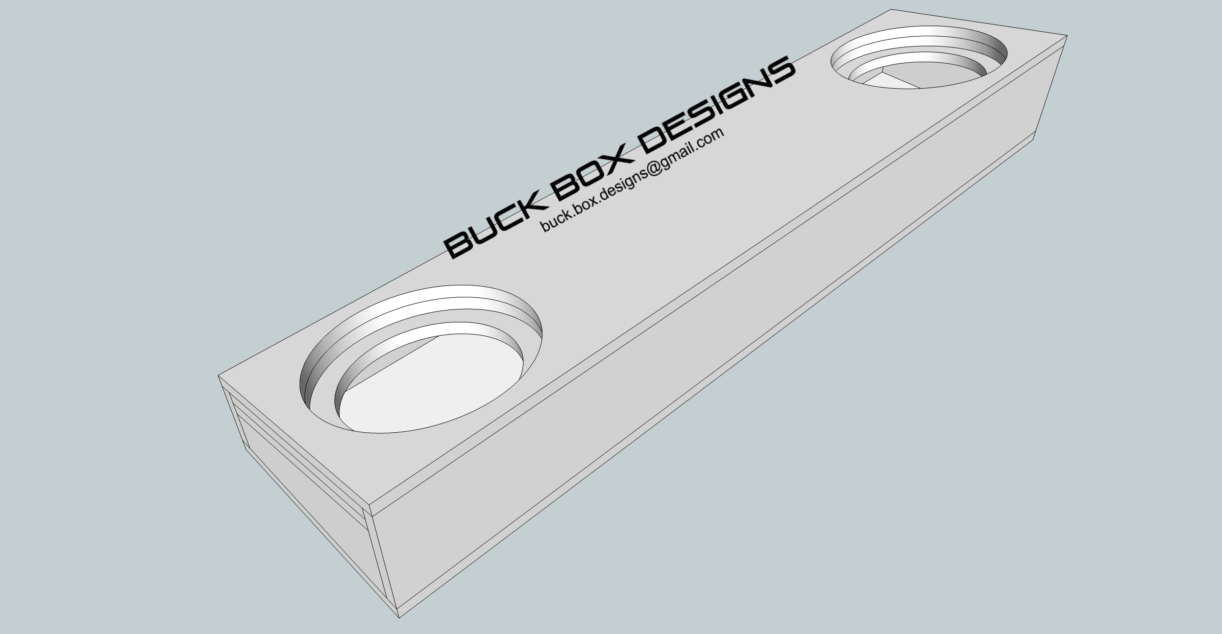

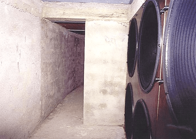

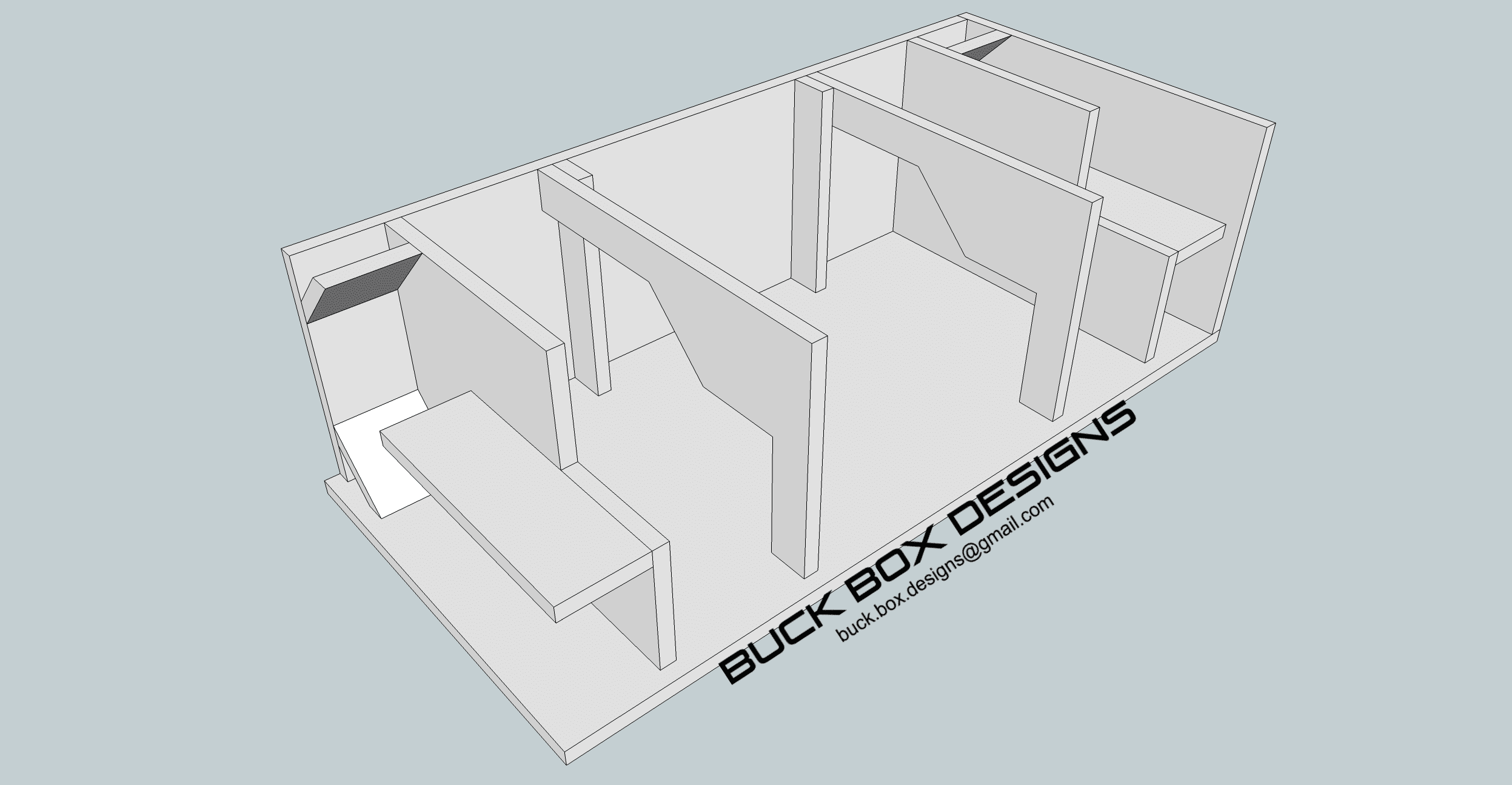

@Buck, a triple box for a stereo shop. All three tuned to 34 hz.

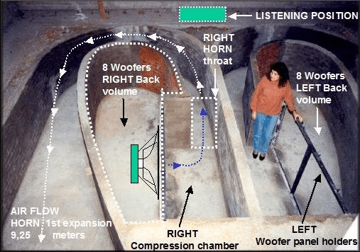

I want to get into parallel and series t-lines and horns for applications like this. My box builder and I are planning to do some test enclosures at my builder's shop, because they listen to music all day while building, basically. So, we've got several random woofers. I've got some old 500w RE 12's, we have a couple of Sundown 6.5's, some stuff like that. I want to make a bandpass-style for both a t-line and horn, and test that basically in an open-air environment. It can be very difficult getting good sounding bass if you're outside or in a very big room.
I tend to think that the larger the environment that you're in, the larger style boxes you will sound better. I really think free-air style boxes are the best way to do any big environment/HT style bass.

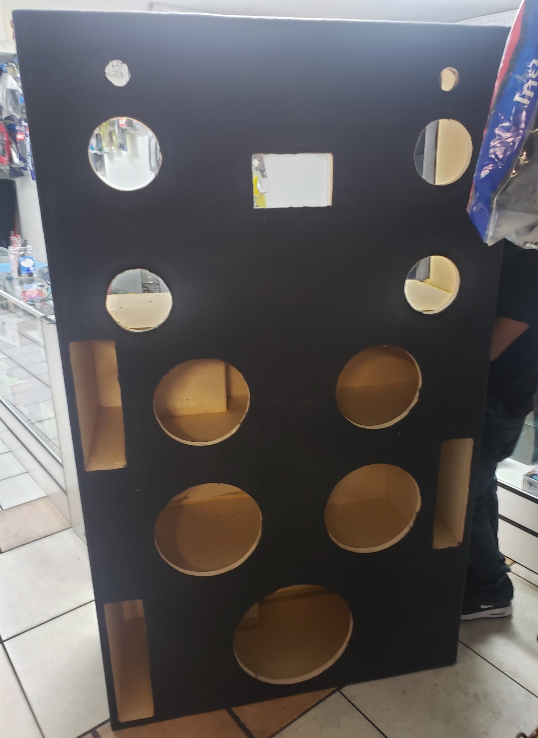

Like this box, this is how the f*ck you do a sub box for a building. This box makes me feel like I design little kid boxes:
