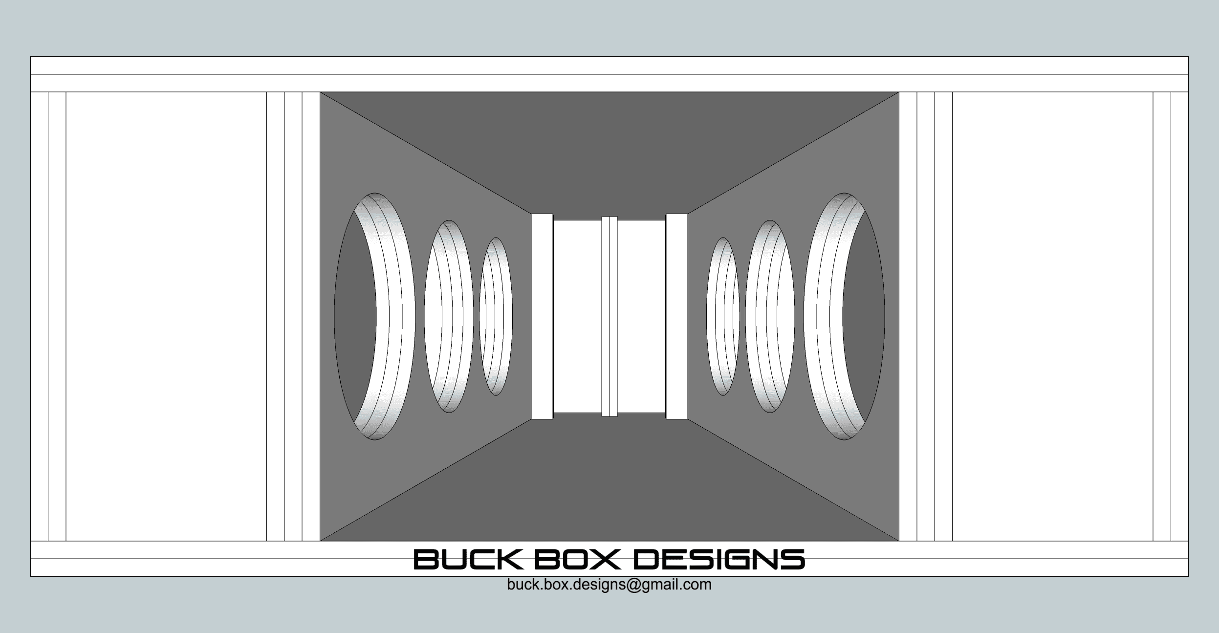

Audio friend sent me this:
Forgive my ignorance, when you aim speakers at one another does that create any cancelation? Like the air pressure from each side causing resistance on the movement of the adjacent speaker? thank you!
When a subwoofer moves, it creates positive pressure on one side of the cone and negative pressure on the other side. Cancellation is when the negative pressure meets the positive pressure. Two subwoofers facing each other add to SPL the same way two subs in the same box do; they pressurize a common chamber in sync.

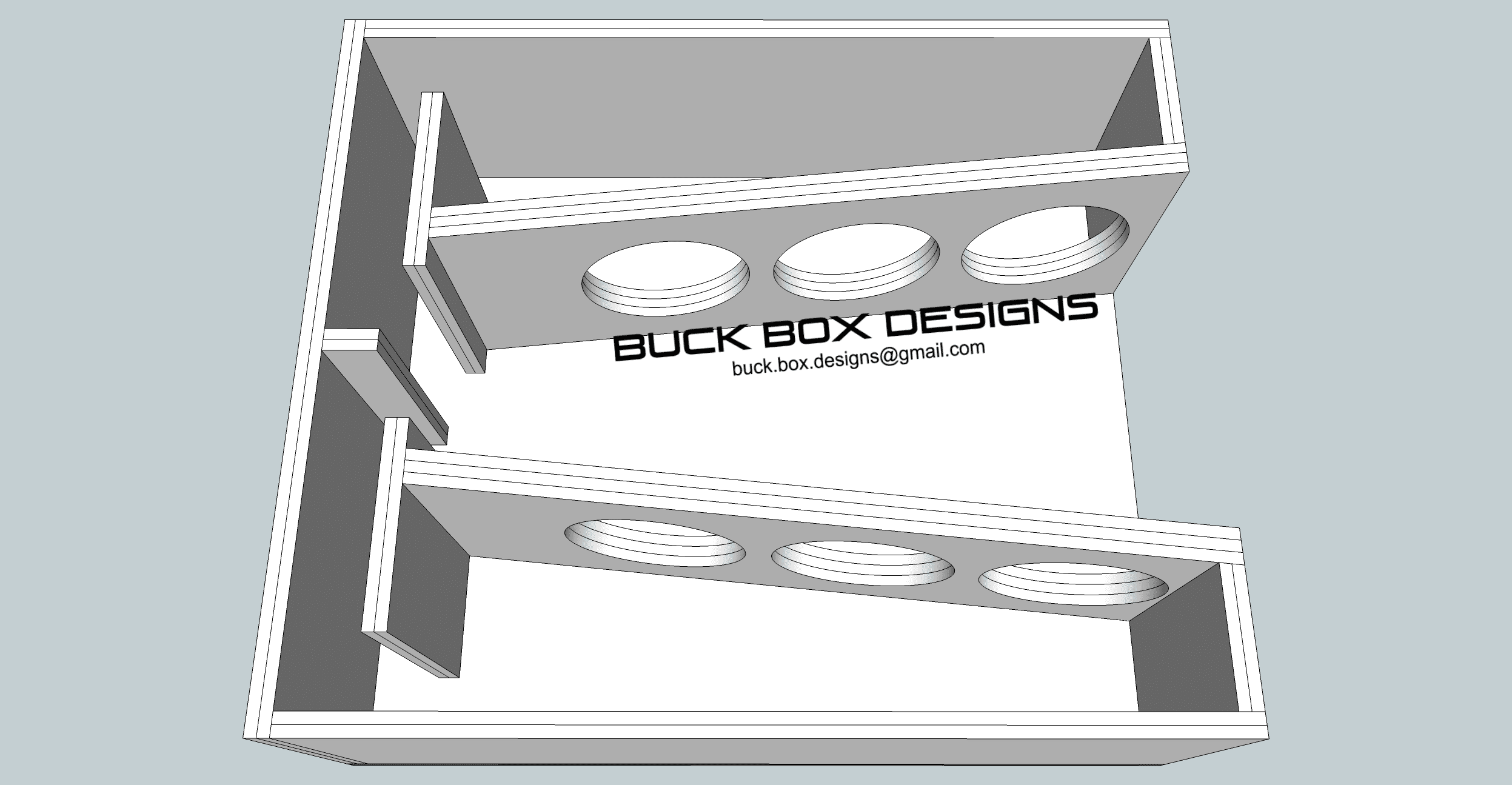

I did some very unscientific testing with some clamshell designs a long time ago and the clamshells seemed a little bit louder I think. I used 4 10 inch JL w3 s. I did 3 builds for testing. I staggered the subs and did a normal flat baffle and I did a 90 degree and an approx 120 degree angle on the clamshells. The 120 wasn’t an exact angle and I don’t remember what it actually came out to. I did it by trial and error measuring/cutting and angled it the least amount I could and still be able fit 4 10 inch subs into a 36 inch wide space. The 90 degree one seemed louder to my ear than the normal baffle. It could’ve been psychological though. I wish I would have had a meter to actually test it.

The clamshell opening itself should act kinda like a horn in reality. But as you move from the port opening in the back towards the front you have the woofers compressing the air in the clamshell even further. It's alot of energy being put into a small "cone" of air inside the clamshell.
Louder? I would almost bet money on it. But you are probably loosing some efficiency with the drivers compressing already compressed air. A wider clamshell angel would probably be better from an efficiency standpoint.
Keep in mind, I'm one or 2 steps above talking out my ***. I can say that mounting the baffle in my current setup at the factory back seat angle(some thing like 30 degree recline) was definitely louder to the ear than having it at an actual 90 degrees up and down.

I think you only lose efficiency if your chamshell is too small for the power + cone area. Some woofers now have so much motor force that you can get away with tighter distances or more extreme proximities, to a degree. It's all relative and situation by situation.
Clamshells do have horn-like properties and are more efficient, in general. In a car audio application with a really big system, say a full wall clam, that style can really have some benefits. The depth of the clam and the angle are huge factors. Basically a clamshell becomes a series 6th order when the opening mouth into the environment becomes smaller than the rest of the line.
You can take a ported flat wall, let's say for 4 15's with a center slot port, and fold it into a clamshell, then keep folding it, and it becomes a series 6th order just after the 2 clam halves are parallel to each other. I guess it's like a -clam angle lol
