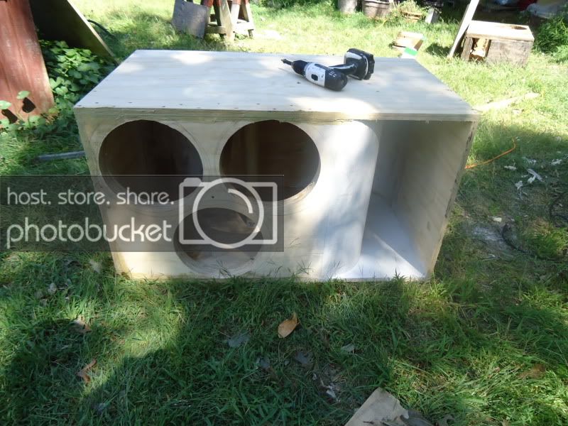

^^^^^^ Proper sized ported box for 3 12's. If you have 12 cube gross under your seats I'll eat my hat.
