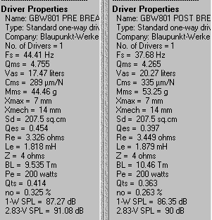

edit: further example using a Blaupunkt GBW801 pre break on the left and post break in on the right.
Break in consisted of playing 25hz free air on roughly 25% power handling for 10 mins.
Note the roughly 14% drop in fs after break in, I still wouldn't call the #'s 100% accurate due to the vas measuring method needed for the DATSv2 but there's enough data there that I would call close enough to make analysis.

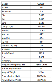

compare that to what the manufacturer provides:
26144

Ideally yes but that varies highly depending on the manufacturer.
A company like Sundown that monitors their quality control relatively closely, I would trust the tsp info they provide, esp since they pull data with a Klippel.
A less reputable company like Skar or a large company with a big production batch is more likely to provide an averaged crapshoot of numbers that in actuality will vary widely.

This is all true and the specs you have posted seem to change roughly as much as I'd expect to be consistent with woofers I have measured. Also I would say that after 10 minutes of hard play (or whatever test tone ritual you prefer) you shouldn't expect much more variance in the future. The vast majority of TSP change from suspension softening happens very quickly.
As to what manufacturers chose to publish, who knows who is doing what, but as an interesting aside I pulled TS paremeters from an old Clarion 32" woofer that belongs to a friend and got precisely the specs that Clarion published back in the 90s. I've pulled some specs from midranges as well that lined up within a very tight tolerance of published.
