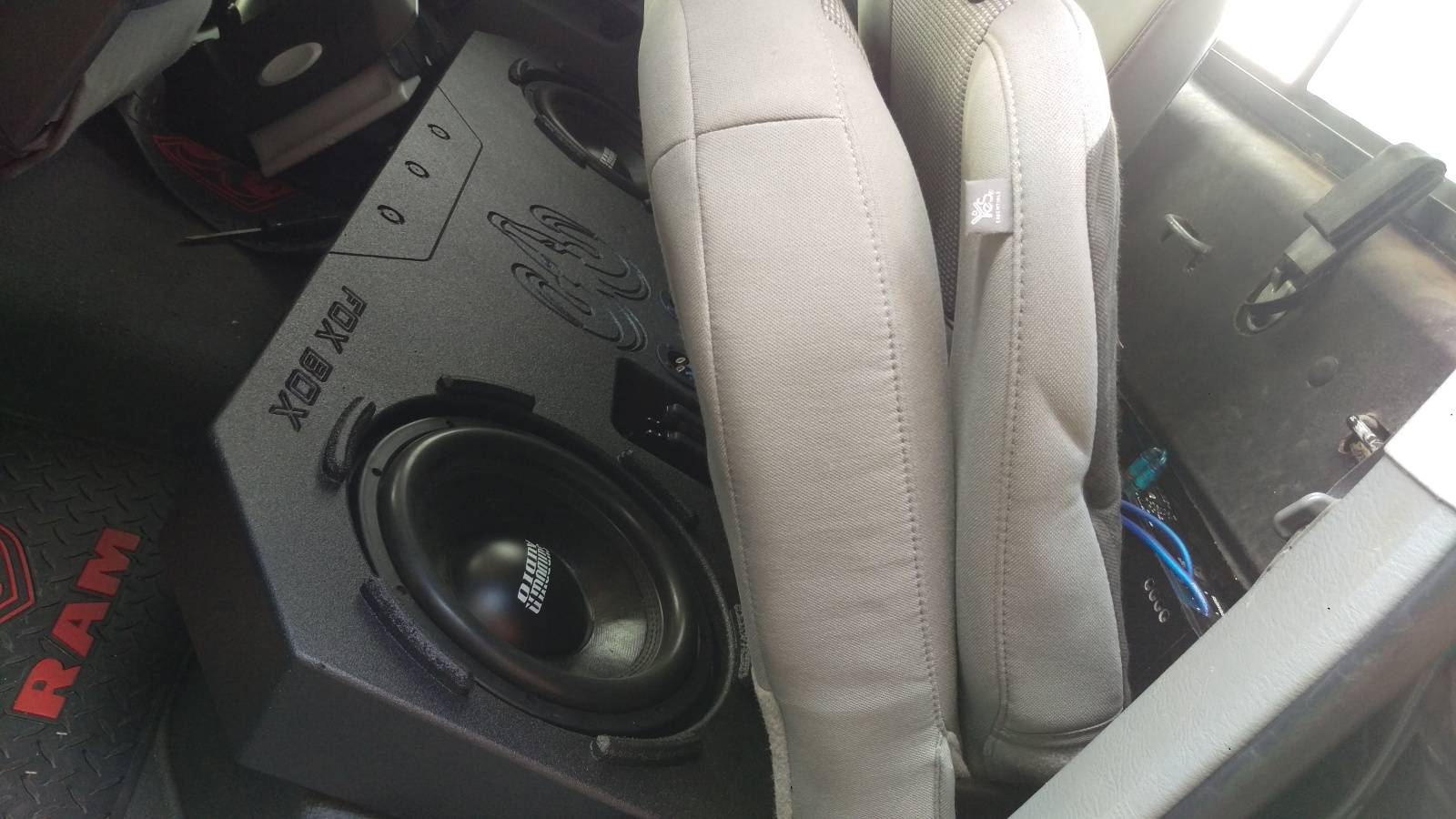

0 guage ofc is on the way, I will order a 300A fuse today.
Now my question is, where can I put a second battery in my truck , everything is mounted behind the seats in the back
