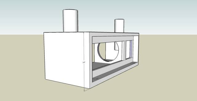

So this is what im thinking as of right now......
a 6th order bandpass aeroports going through rear deck speaker holes (little 3in tube i cut for example on the right side) with the width and height of the current box in there. 38"W x 14"H x whatever depth needed for optimal volume. Still need someone to help me with a design asked PWK and 80inches but both seem very buisy at the moment.
where the porton the left will come out ( 4in aeroport most likely) and the right side is exactly the same. i would make baffle for the aeroports on the rear deck to fit perfectly.

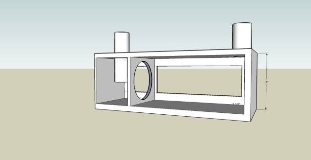

this is a design i would like it to resemble ( just made in sketch up) with the ports going in as far as needed and with as much depth as needed for airspace.
the reason for the 2 1/4" extra on the front of the box is for a Sundown saz-3000d to sit flush mounted on the front of the box. 2.25"- .75" (to close box up) = 1.5" + .75( flush mount beauty pannel with amp cut out) = ***

thats what im designing for u
but only 1 port for the 4th order..but i think u do have space for a 6th order
