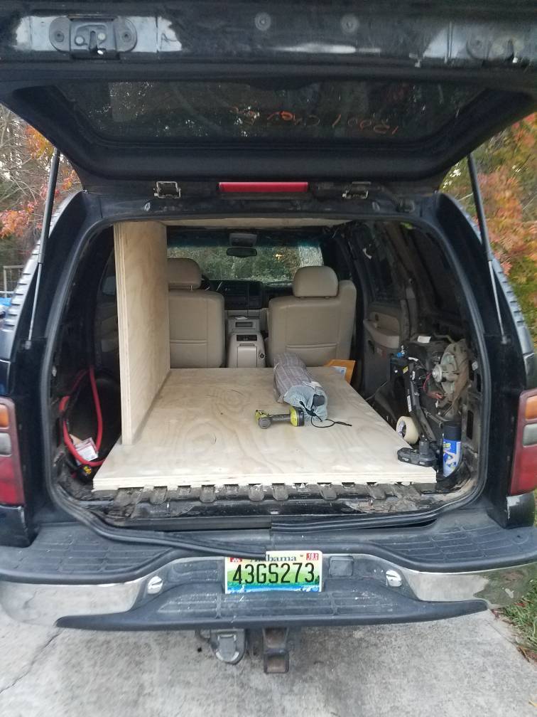

Been slacking on progress getting off with it already dark and getting cold but I got a little bit done. Still have some bracing to do on the one side, going to run 2x4's down the outside and brace them to the side, hopefully I'll get that and the other side done tomorrow.

Subs are still undecided and I keep flip flopping on what to do but I need to make a decision with all the deals going on this weekend, rough measurements are giving me about 50 cubes to work with.
