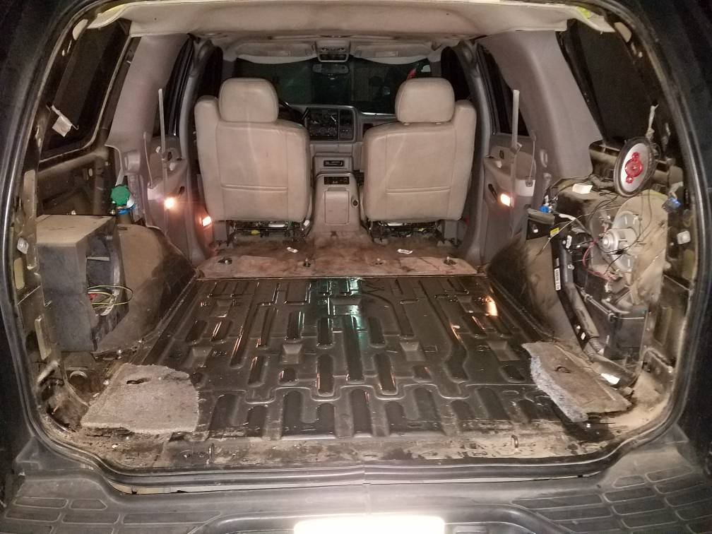

Got a little bit done after work, forgot my socket set at work so I just removed what would pop out.
