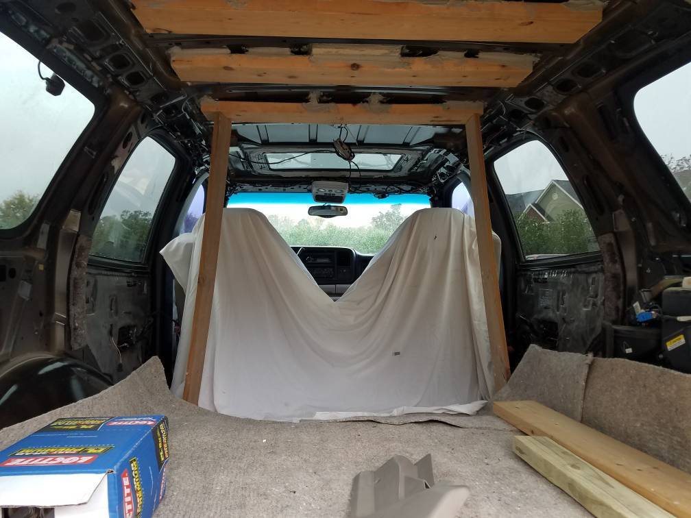

Got A few pieces of wood on the roof, one more and I'm going to put a sheet up. I have to decide for 15's or 18's because if 18's it looks like i will have to build around the corner roof supports to get the extra width, if 15's I might not have to and just build square. Also the floor should I put down 2x6's or just lay sheets down

What are you using to bond wood to the roof?
Either way you will want to build around those corners to max the cu ft on the wall. It will also help to keep flex in check on top end.
Id say frame 2x6 on bottom if 15's if not build top to bottom with sheets.

I have a case of pl x8 and filling some of the gaps with wood being it's not flat. When I put up first sheet I plan on spray foaming.
