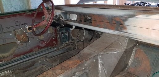

Restoring this 67 Camaro
Exterior almost complete - need to do hood, trunk, fix a booboo on the back, then paint
Mechanics - LS1 engine swap, 4 wheel independent suspension, power brakes/ steering, AC
Interior - you can see lol
So planning my SQ sound system before paint.
HU - false old school radio just to control volume of Bluetooth reciever straight to amps
Front - hopefully find crystal sscs6 in kick panels and tweets in pillar
Rear deck - to be cut out and fiberglass a sealed box for a shallow mount 10".
Amps - find old school amps, probably mount under rear seats.
Trunk - fuel cell (gas tank) and battery.
Sound deaden whole car, foam in little pockets that serve no function, silicone in gaps that can rattle
Should I place mid range in rear deck? Used to be a consensus that it messes with SQ
Should I place mid bass drivers in doors, rear quarter panel, or rear deck? Sealed or IB?
Tweeters in pillars and kick panels?
Any suggestions?
Please don't ramble "could", "IMHO", "heard from a guy", etc.
Thanks guys and gals!
20180804_191435.jpg20180804_191511.jpg20180804_191606.jpgView attachment 353View attachment 355
Wow, looks like you got a big job ahead of you rebuilding that car.
First and foremost you're in a perfect place to do some serious deadening.  There are some great options for products these days and you could really have a Cadillac quiet ride if you wanted.
Definitely don't put any mids and highs behind you.  It is still an acoustic nightmare.  Kicks or a-pillars for mids and highs, midbass can go into the doors just fine.... really mids in the doors can be OK, but if you can keep them on-axis (pointed right at where the dome light would be) you'll  generally have better results.
Unless you really love nostalgia I'd avoid old school amps.  Anything worth owning is OLD.  And I mean old to the point where electrolytic capacitors are due to fail.  So if you do buy an old school amp, make sure it's something that's really worth the cost of being professionally restored.  Even then modern class D technology is very nice.  You can get big power in a small footprint that runs nice and cool that you can stash in some out of the way places and not run into overheating troubles.
So if you can get some really rare old school amp to put it on display, that would be pretty cool, otherwise if you just want good sound from something hidden you should definitely lean towards modern options.

So narrowing it down for SQ:
Sub: 10" sealed rear deck. Currently can get a great great deal on a single shallow typeR for 600rms. I can even do 2x Image Dynamics 10" but would look tacky.
Midbass - 6" or 8"? IB or sealed? Range? Angled up to doom light. Or forget completely?
Mids - angled up to doom light and IB.
Highs - angled up to dome light
Some nice metal work going on in that vehicle.
This deserves a full-fledged 3way+subwoofer install, something powerful to drown out some of those sweet exhaust notes when you want to. There's so much possibility for massaging in large midbass drivers in that front area while you are doing the fabrication, it would be shame to miss that opportunity. You might also consider running mics in the tire wells and firewall area so you can feed that signal to the amplifiers with the opposite polarity. Noise canceling, ya dig?
