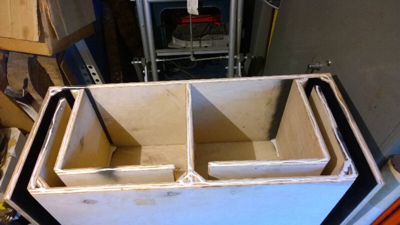

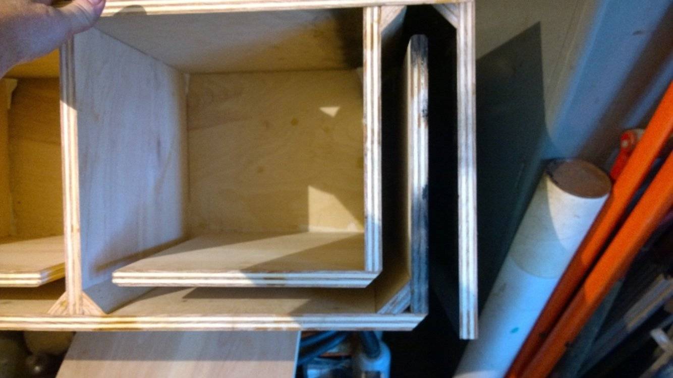

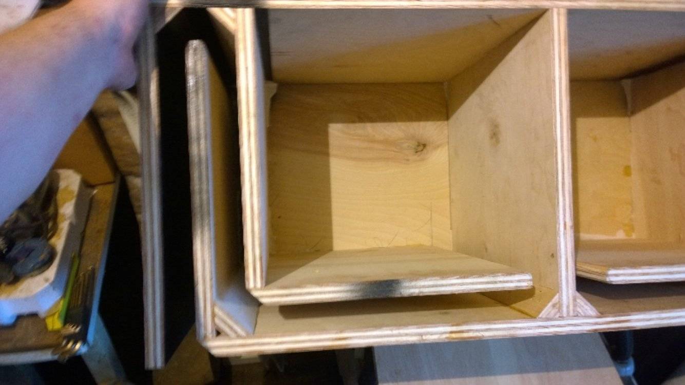

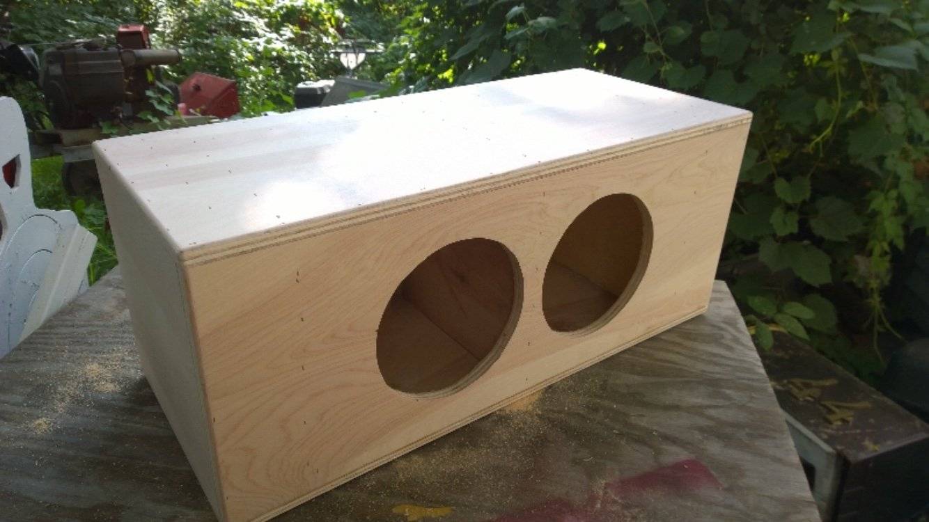

Enclosure measuring 36x15x15 for a pair of Dayton 10s..
Woofers firing forward and ports to the rear..
Any paint recommendations? Ports are already black.

What vehicle is this going in? This just doesn’t make sense to me. I can’t see this going well. I really hope it works out for you tho. Otherwise you might have to get another box made.

4door sedan.. Firing from the trunk through a ski hole opening..

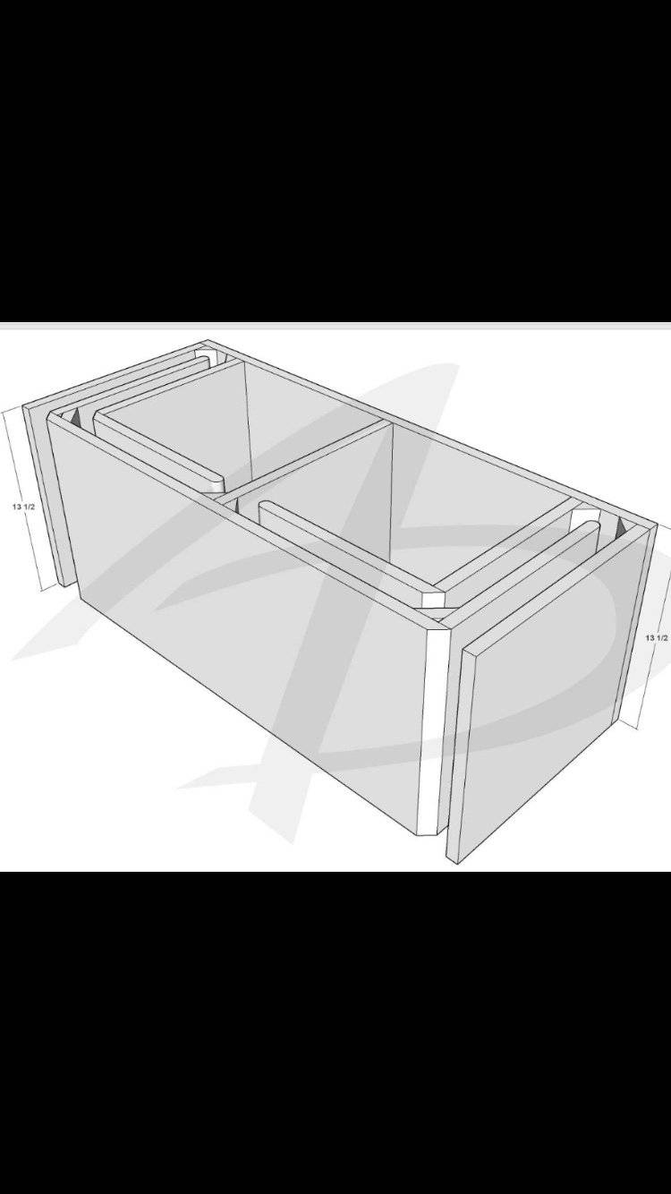

Box Design by Peter Kulicki @ AD Designs aka Hexibase.
The box looks good man. If that is a Hexibase design, then I imagine he had his reasons/calculations for doing the port direction like that and it's going to sound good. Can't wait to see some vids.

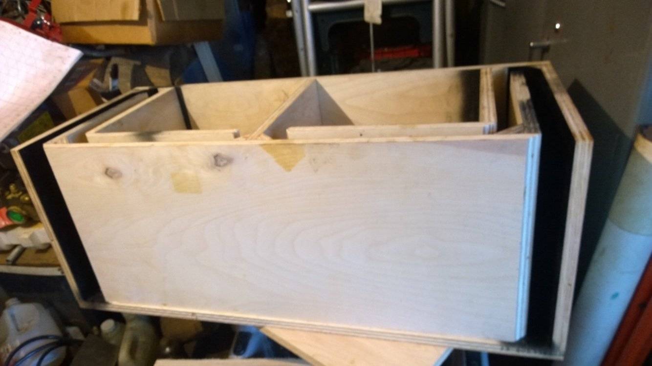

I hope it sounds great too.. Building boxes is pricey, super dusty and time consuming..
Priming the enclosure now.. Slapping two coats of Matte Royal blue with black ports.. And all black Dayton’s to match..
Peter Kulicki usually does good designs so I'm sure it will work. But traditionally I wouldnt ever put port and sub opposite. Unless It was like in a crx hatchback in which the cabin is so small cancellation doesn't have time to happen
