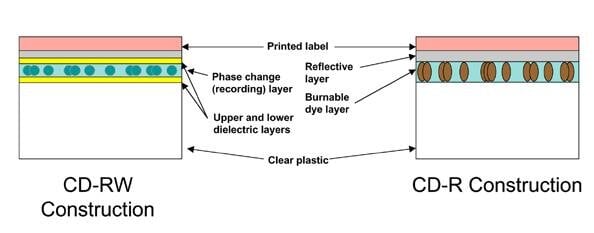

I am curious if the CD's are thinner now as well.
Here...

Which is more reflective, Aluminum or plastic?
Go to the link and read the section titled 'Mechanism of Action'.
In this case neither since "the reflective layer is, however, a silver-indium-antimony-tellurium (AgInSbTe) alloy with a polycrystalline structure and reflective properties in its original state." I actually did a report on CD-RW many decades ago and remember the laser altering the structure, but didn't remember the specifics. Did a little research on Mini Disc to see if perhaps I mixed up the two technologies, but Mini Disc also used an alloy to store data. Too bad Mini Disc died - yet another superior technology from Sony that Sony let die trying to horde it to itself. Sony was almost (iirc) 5 years ahead of the curve and yet managed to lose out to inferior technologies.
