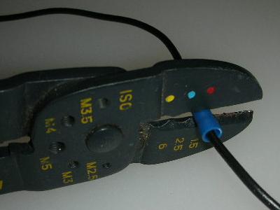

Crimping a terminal onto a wire is the process of smushing the metal terminal onto the copper wire to attach the two. Here is a picture showing the process of crimping a small connector onto a small wire.
edit: omG I've committed a crime //content.invisioncic.com/y282845/emoticons/eek.gif.771b7a90cf45cabdc554ff1121c21c4a.gif
http://www.ultimatehandyman.co.uk/bc6.jpg
Ok now im SUPER confused //content.invisioncic.com/y282845/emoticons/confused.gif.e820e0216602db4765798ac39d28caa9.gif What the hella am i trying to make it fit onto again!??!
