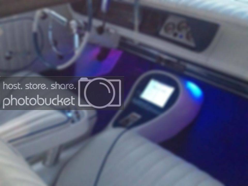

A couple photos so you get the idea.....
Thank you!
They are tucked into the very top corner behind the boarder tint, so you can't really see them... But they can be aimed...I have been running the tweeters and 4" and 6x9s off the head unit for the past couple years.. And the front stage was surprisingly decent/very wide... Lacks midrange for sure... That's what I was hoping to get using the 6.5s in the kicks. And them using the amps crossovers to equal everything out. At least that was the plan in my head.. Hence getting the autoteks that have full crossovers... I know they are not great, but since they were going to be hidden.. I figured anything is better than off the head unit.
