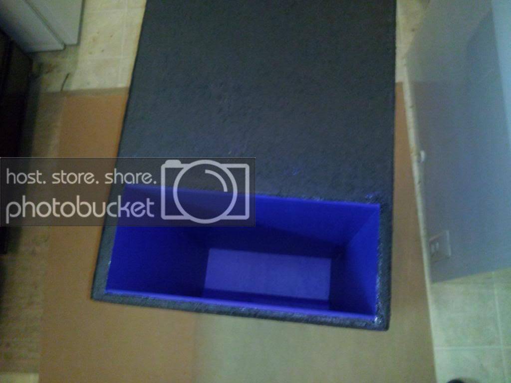

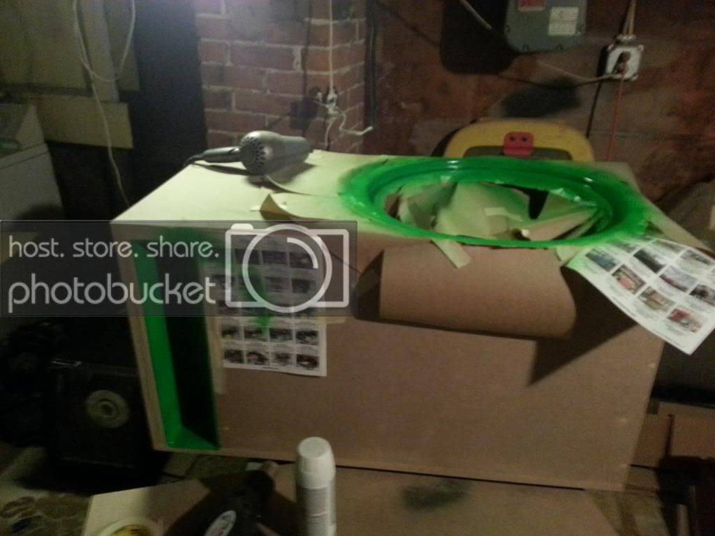

what is port area per net cube? Seems kinda small, but hard to tell from a pic.
If it's 16-18^2 per cube you can always do a port reducer to shrink size/lower tuning. Not idea but will work if you wann play low stuff with a lot of power...
That was my first question too! Judging by those magazines next to his port, it that's more than 4inches wide I would be suprised. A dollar bill is 6inches long for reference and it barely seems to be more than half that.. At least from pics. No way that's enough slot area, even if the area works out, it's going to be too tall and skinny, which still leads to noise.
hmmmm just hmmm with this build, i do like all the pretty pics tho //content.invisioncic.com/y282845/emoticons/smile.gif.1ebc41e1811405b213edfc4622c41e27.gif
OK like an idiot i didn't check to confirm the port size. The 5" wide i said earlier was from the original drawing plans I had and just guessed, but the actual measured is 3.5 wide, 17" tall, and 13.75 in deep. The box is 5.6-5.7 cubes which is perfect because that drops the tuning to about 38hz, not too bad I think for the lows. I post a video once Im done which shouldn't be too long here are some more updates:
