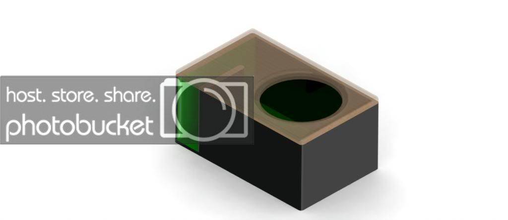

Decided on a box and did the rendering. Here are the specs: 6.cu.ft. port length 12.5 long, 5" wide. Tuned to 41hz. No bracing because sides and port are double layered (1.5").

Is that 6 cubes after port and woofer displacement?
It looks good, how much room is there from the port to the tailgate for loading? And what is the port 5"×?"×12.5"

Thanks. and yes its before displacement, and it's 5Wx15Hx12.5D on the port. Im not sure exactly how much loading space i'll have because im making an amp rack to sit behind it so it will take up more space. I have to measure later and I'll post. But here is the amp rack on the box. The holes in the rack are for fans.

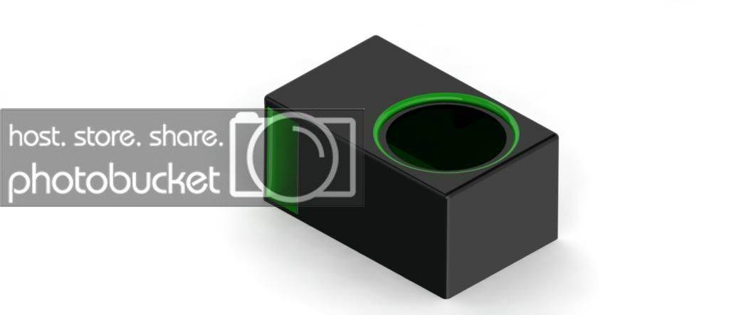

ok I had to make changes to the dimensions because I found out I only had 1" of loading for the port. NO GOOD! so decided to make the box 36W/18.5H/19.5D. The box is 5.6 CuFt after displacment of port and thick sidewalls...NOT subwoofer. tuned @41hz. and the port width was changed to 4.5 instead of 5" Because of the power I'm running. here is the final renders before I start building

i would make the box 6 cubes and keep the 2 6" aeros IMO. I did a single 18" hdc3 recently with about the same power you have and used 2 6" aeros as well. Mine did fine when i went to comps as well. i did a 147.6 on a 30 music average, with 1 hdc3 18 and stock electrical. I know you said you dont compete but this was also my daily driver

again use areos they take up way less space

Well im already half way into the build but I'll always have the boxx and aero ports.. but quick question, are your aero ports facing up or rear and what about the sub??

Mine was sub firing up & port to rear. In SUVs thats proven to wield better output in most scenario's.
If this is for daily why are you tuning at 41hz again.. I have a single 21 in a cadillac SRX. I'm using passives so I can adjust my tuning on the fly. 40hz tuning def doesn't do great at 25-30hz region, although it's fine above that. Still not worth the tradeoff and a mid 30's tune is a much better compromise if you looking for boom in the 40's as well as good LFE.. (personally I tune around 25-30hz, but that's my preference)
