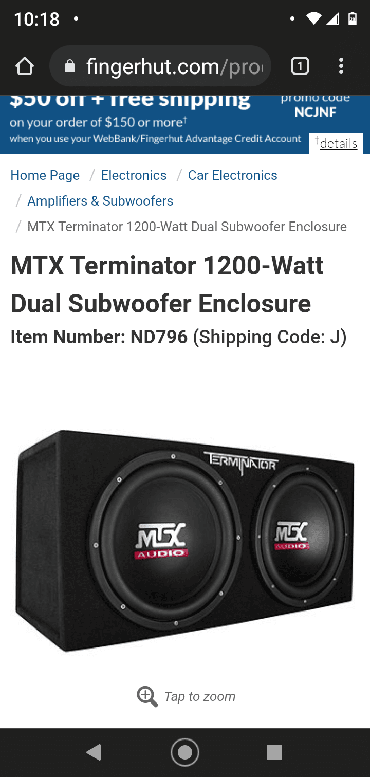

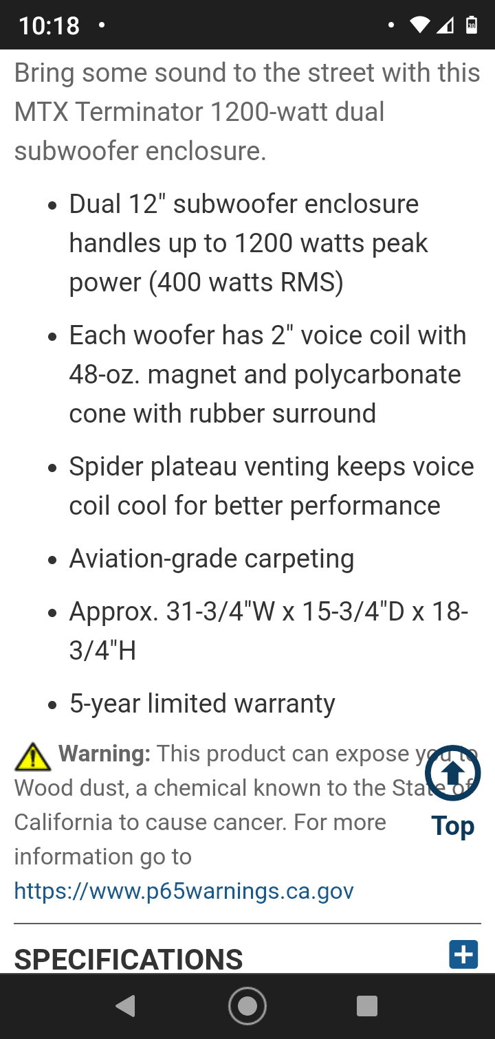

What subs exactly? Are they all identical?
Are they dual voice coil (DVC) or single voice coil (SVC) 2 ohm subs?
Those are single 4 ohm subwoofers. All four subwoofers will wire to 1 ohm.
Get a 1000 rms monoblock amp.
