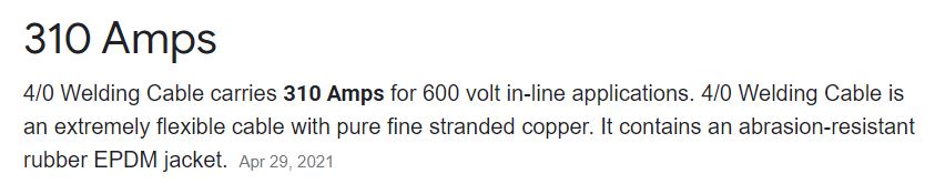

Google says 4/0 can carry 310 amps. Although, I don't trust those numbers. IIRC, 1/0 oversized car audio OFC wire is rated for 300A. So, I'd say reasonably, it should be good for 500-600ish amps.
