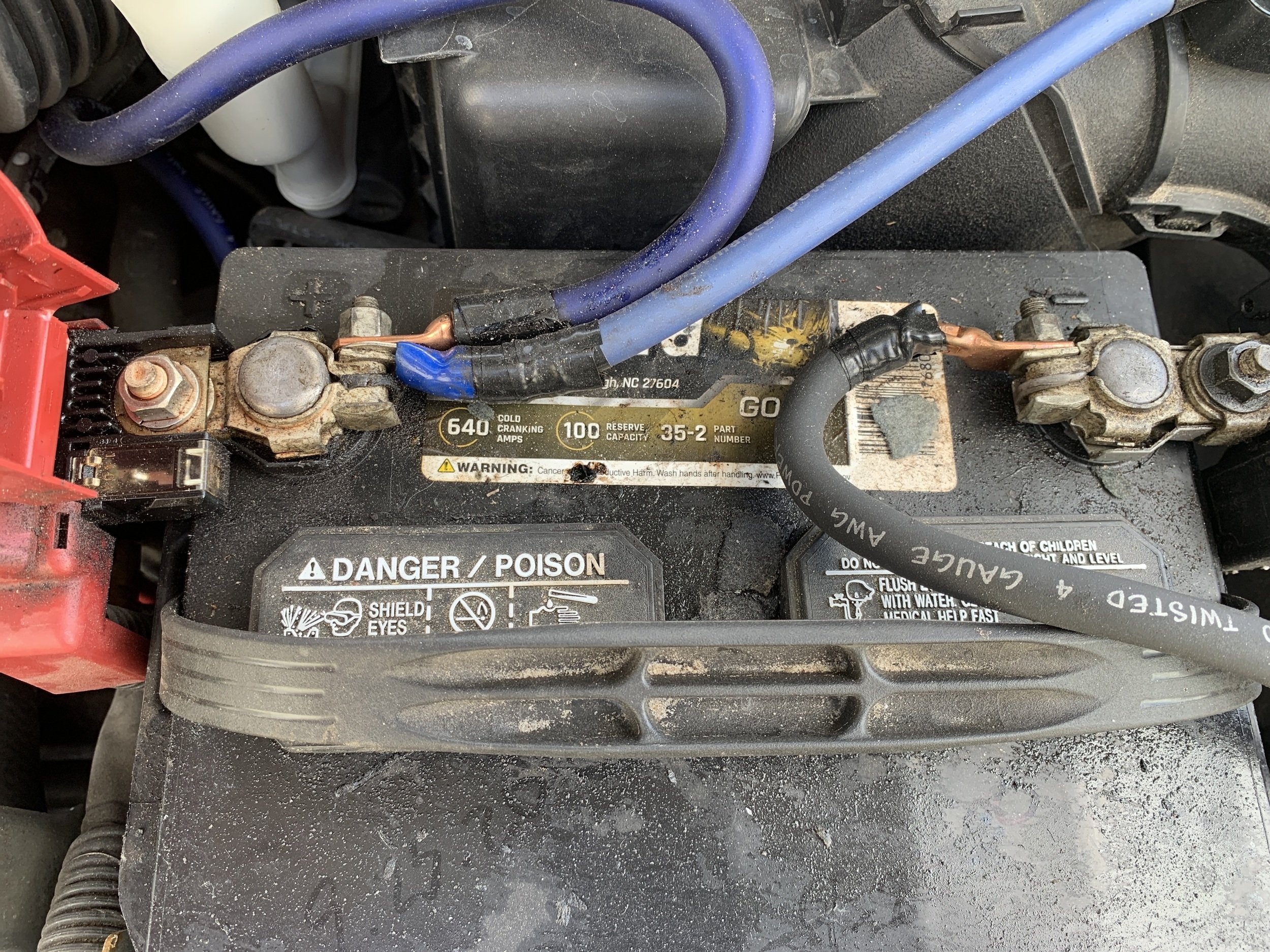

what is the best type of terminals to use, so i can hook up all of the stuff from the car and still have room for all the stereo stuff?
I use these to stack Ring terminals. You can get a longer bolt later on if needed at H.Depot or Lowes.these are cheap and work just fine for Post.Just make sure you get Brass,not Alumn or Lead
