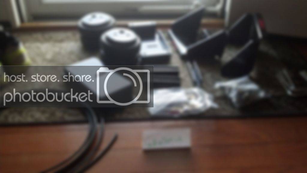

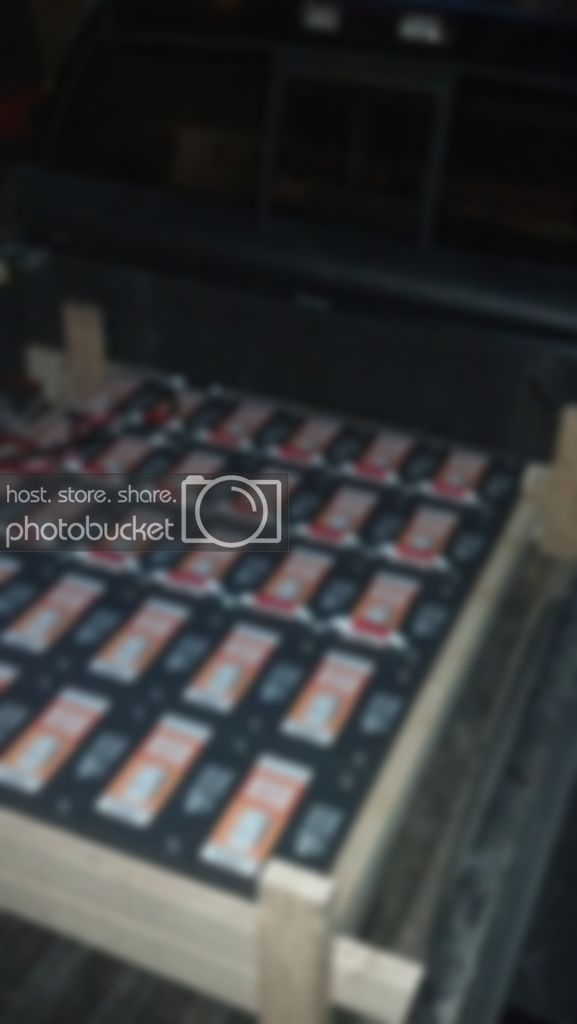

Got my airbags installed and loaded the batteries up! Worked until it got dark outside, so I'll hopefully finish everything up tomorrow. Here's what's left to do for now:
1. Finish connecting batteries
2. Seal some small holes in the wall with caulk
3. Wire subs each in parallel to a pair of 8 gauge OFC wires
4. Mount 2x4's for amps across batteries
5. Add more side bracing to battery rack
6. Install amps
7. Add port length and slightly decrease port area
8. Plug relays back in
Then one of my friends wants to re-do my door pods for me

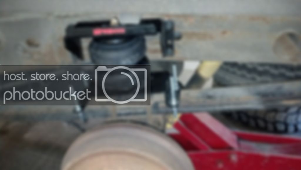

i was about to say, idr you doing any work with suspension before lol but the airbags dont have any load or anything you literally just bolt them in and clamp to the springs huh?
**** ***** on my truck, every time i want to drop the axle from the leaf springs i have to pull my tires off and drop my entire axle before my lift is tall enough to reach the truck lol
Yeah, I would definitely recommend airbags to people.
Only difficult thing was that I had to drill new holes in the bracket so it would line up.
Everything went on too easy at first. Went to bolt my wheels back on and the tires rubbed on the bags!! My tires are 3" wider than stock and I just have the stock rims that aren't ofset. I had to modify the bracket, then added 1/4" wheel spacers to give a little extra clearance for peace of mind.
Since I've got torsion keys in the front and bags in the back, I can adjust my ride height on the front and back to get it to sit how I like
i got my aftermarket rims with some offset for $400 shipped to my door but theyre 16s... and i have 35s lol
if that spacer isnt the lug centric kind you might want to consider changing it out for the long term. they shatter..

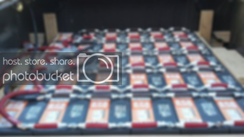

All the batteries are in and hooked up //content.invisioncic.com/y282845/emoticons/smile.gif.1ebc41e1811405b213edfc4622c41e27.gif
I like the duct tape for extra support!
Seriously though what is that for on those couple terminals lol?
Looks good for sure. Still looks like you even have a little room left in your bed?
Those were on the positive terminals near the last ground connection.
I hooked all the positives up first, then all the grounds and that was the final connection that tied all the grounds together. Didn't want the other end of the wire hitting any nearby positive terminals
That makes sense. Good deal.
How much space do you have left in your bed?
Roughly 14 inches between the bank and the tailgate //content.invisioncic.com/y282845/emoticons/crap.gif.7f4dd41e3e9b23fbd170a1ee6f65cecc.gif
Enough room for me to store my small air compressor
