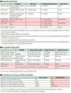

Ahhhh. I have the answers I was seeking!!
The eXcelon double din head units I have been looking at (DMX905S, DMX906S, DMX907S) will all do NTFS with unlimited music folders. They accept USB "Mass Storage Devices" so the portable SSD's will do fine and they do not say there is a limit on the GB size of the hard drives.The USB 2.0 powered USB inputs will power the SSD's 5v 1.5a which is what they ask for.
So, to answer my questions in post #1, at least the Kenwood eXcelon's I have listed will do multiple Mass Storage Devices (SSD's). So yes, if anyone wants all their music in their vehicles, go for the head units that accept NTFS.
Also... The manual does state it will do video as well including .mkv
Kenwood DMX906S manual listed below. Highlighted in red are the key points.
Even though it says there's no "limit" I guarantee you there is.
