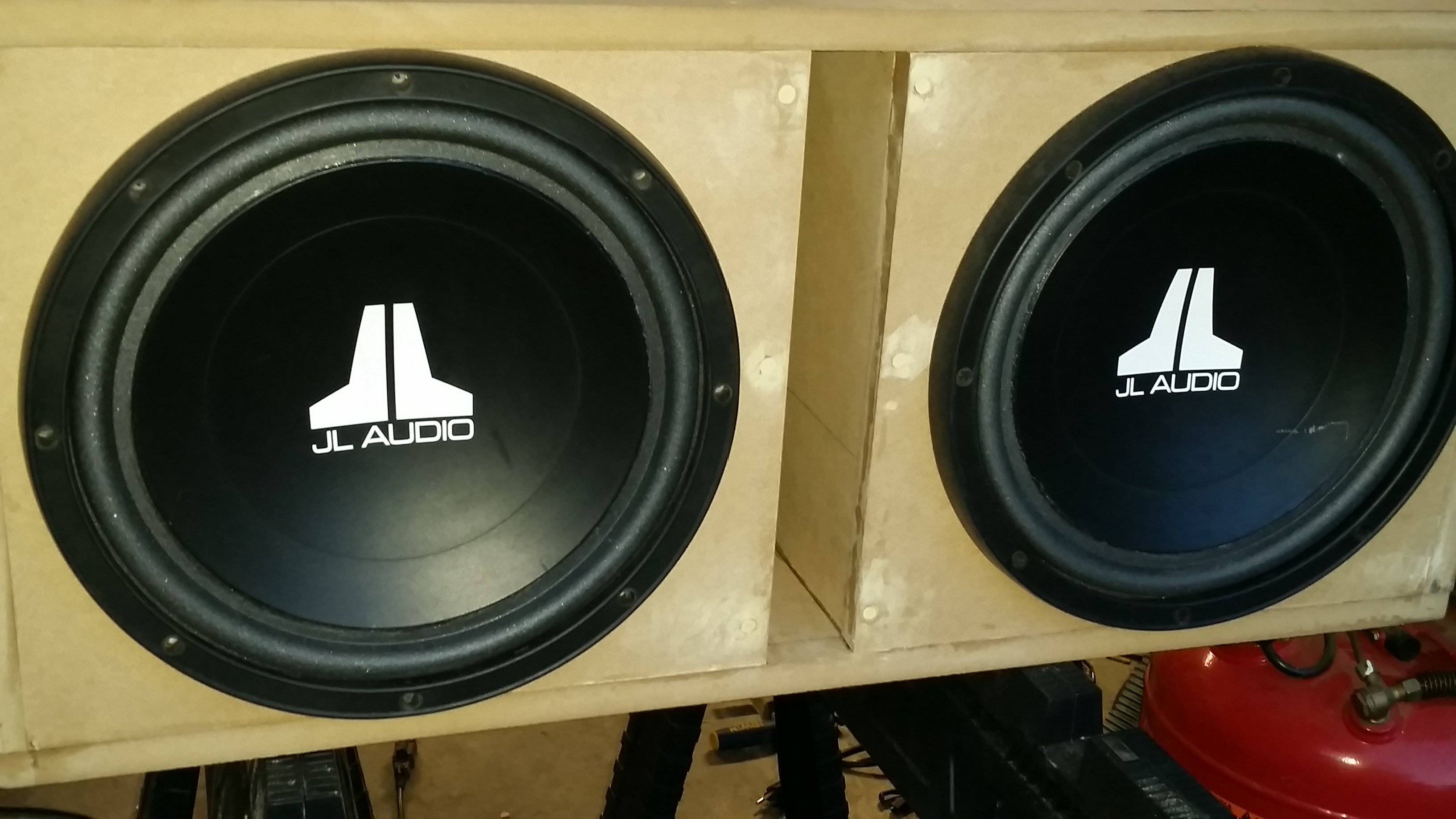

Are those og w3s?
Sent from my LG-H910 using Tapatalk
Yes sir, sat in a closet a long time and my son got his first car I dusted them off and built that box, refoamed both of them and they hit like they did brand new
Those aren't o/s w3's. the old ones used to have hard paper gaskets whereas these have the rubber gasket ring were all familiar with. Another thing...o/s w3's used dustcaps, these use a 1 piece cone assembly.

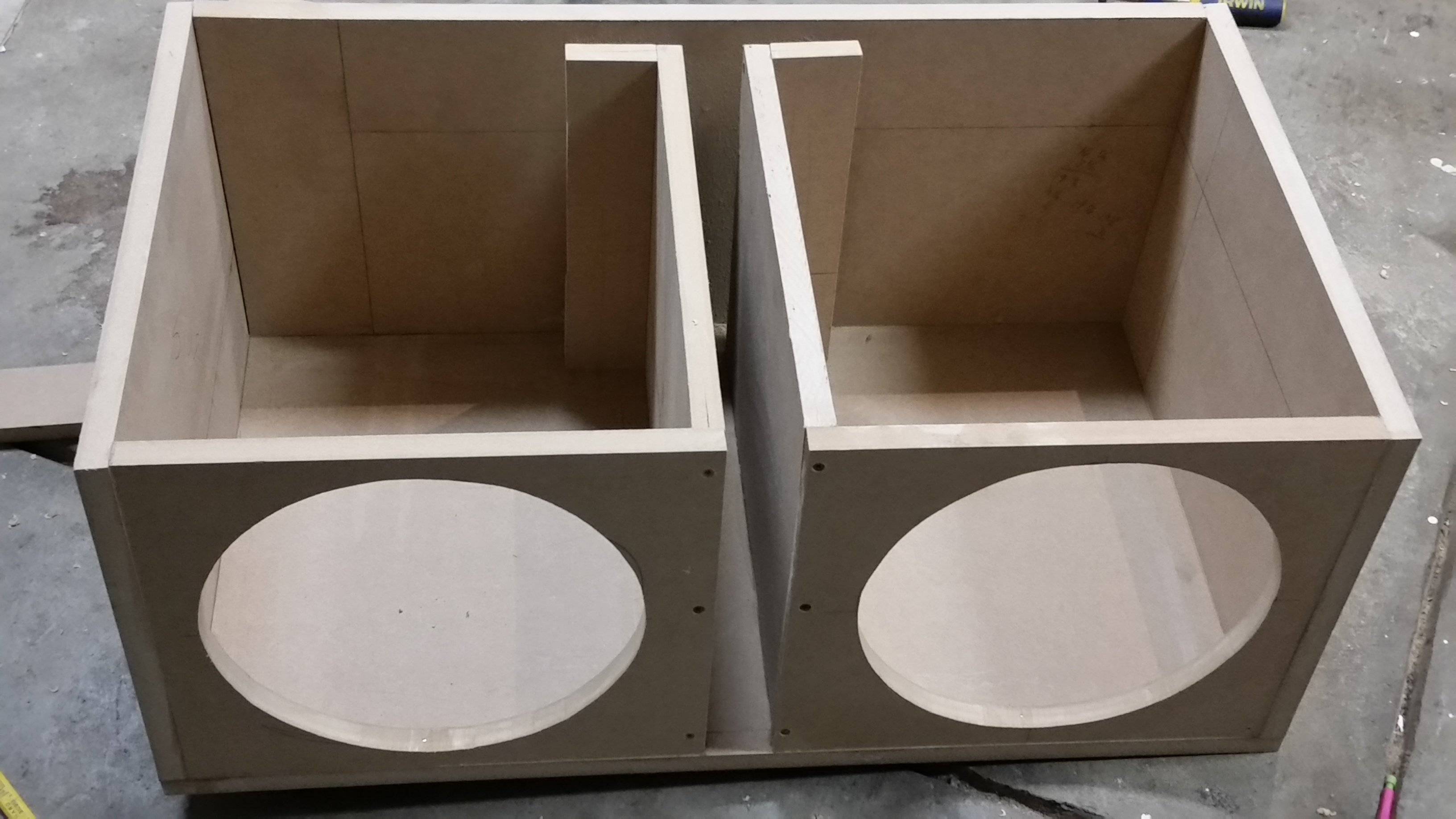

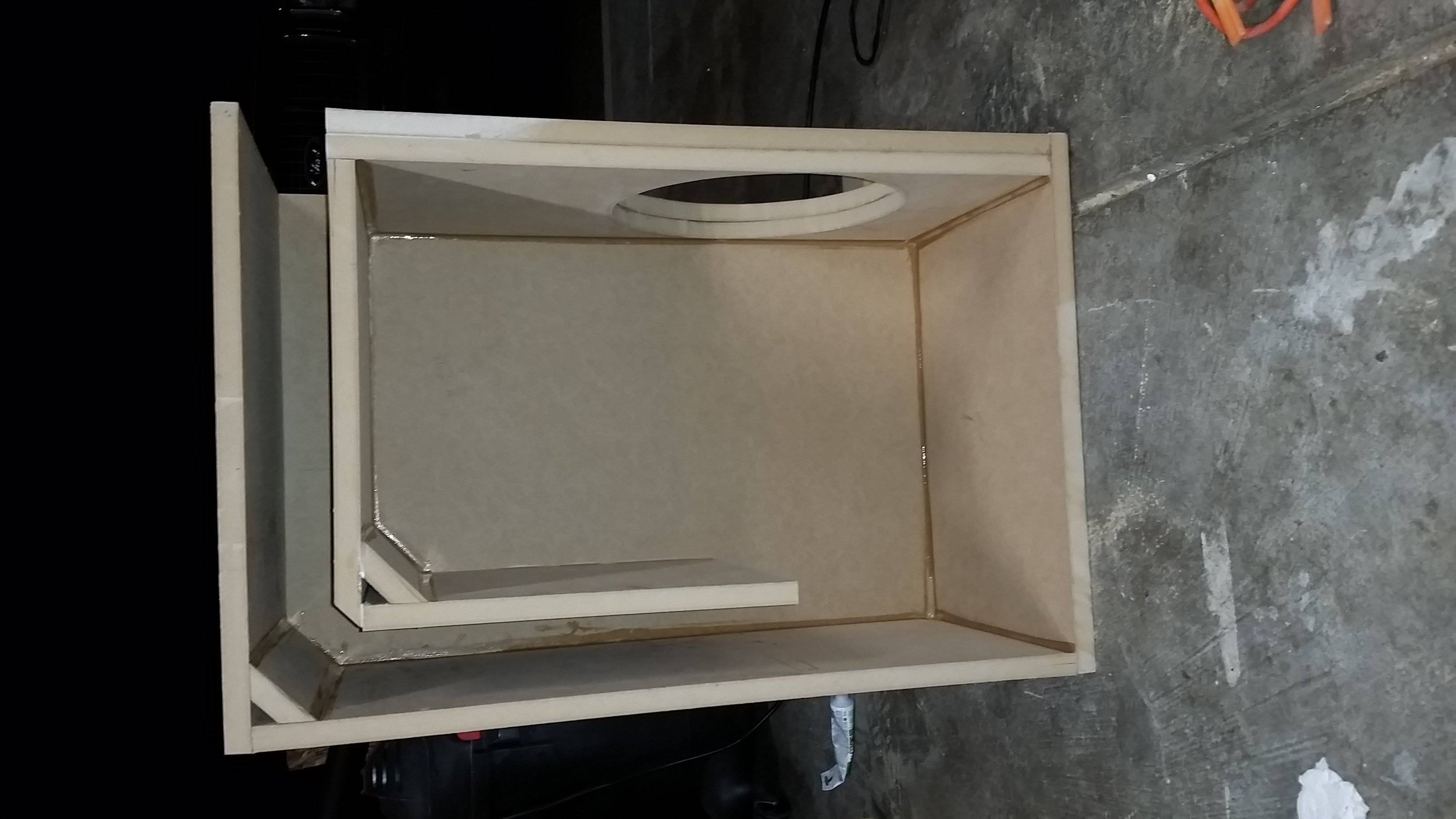

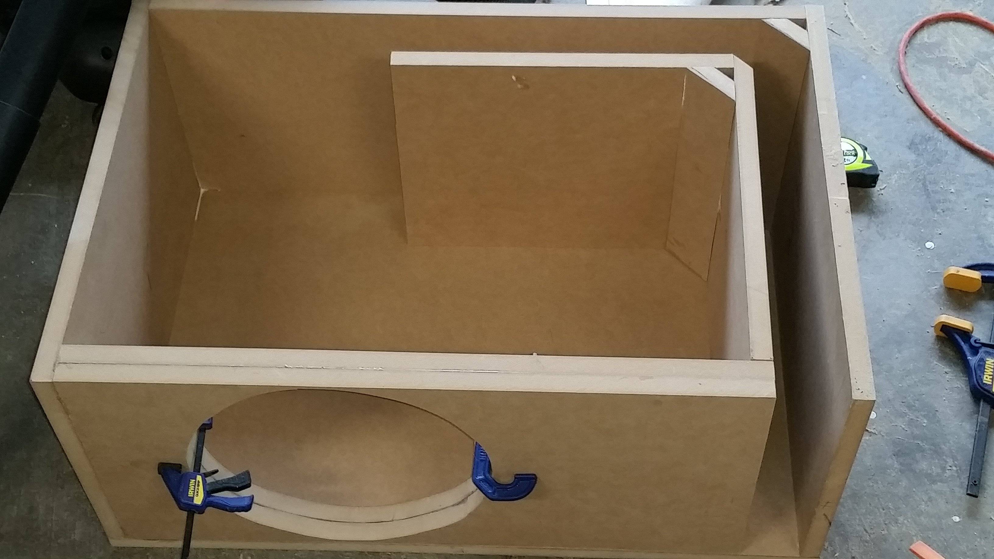

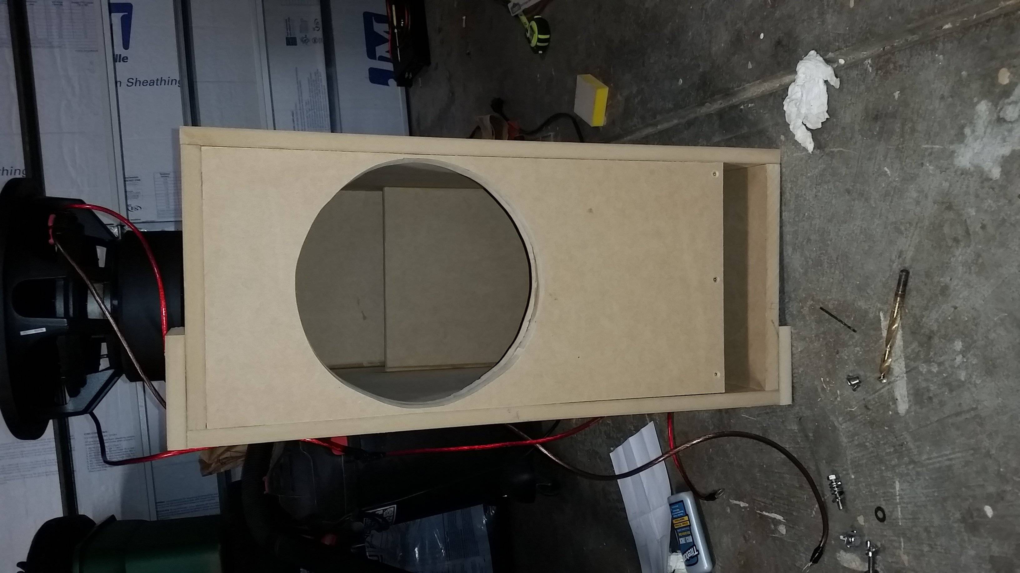

Ended up putting 1 xfl 12 dual 2ohm due to the size of the box on a vfl444801d. I know there are a lot of die hard jl guys around but there is really no debate about this 1 AB12 hits harder then the two 12w3's (which slammed) especially on low notes. The jl's were punchier on real drums like rock country etc but the AB moves way more air and sheet metal! Here's the box if anyone is interested in going AB & the jl box it replaced (almost the same size btw). It is tuned to 32hz and the mofo kills a low note. I metered the amp on a 50hz sine wave and I am giving it about 1600 watts and I swear it wants more..
FYI sir..Nice box built for the XFL..Yet..I do recommend using some 3" screws to keep that box secured and keep sealed as that XFL will place alot of flex/movement creating leakage/if not damaging the enclosure by just being glued in place over a period of time.Ive beat the hell out of my XFLs,and they are hard to beat for the $, and really sound great at lower volumes too.Excellent choice for SPL for the $..2.6@32htz seems to be ideal on approx 2k clean rms:yumyum:
I know what I have //content.invisioncic.com/y282845/emoticons/smile.gif.1ebc41e1811405b213edfc4622c41e27.gif these aren't the original w3''s they did have the dome dust caps.. these are 12w3v2d4 which was the first of the inverted cap
I guess it depends on what you define as old school 14 years for subwoofer is what I would call old.. but we can maybe agree they are far from new?
Thanks and yes I glued it, screwed it, and then clear siliconed the interior for good measure although most believe if you glue every joint you can skip the silicone. I didn't want to take any chances and don't like removing subs over and over with an mdf box so I ran the 8 gauge to ring terminals on stainless bolts running inside out and I can change just about anything without removing the sub
IMO most of these newer woofers do not do well tuned so low. They're not like the old stuff where you tune super low to get flat response, they really have limited bandwidth so you typically either need to do a lot of experimenting or just pick a place to compromise.
Anyway the box looks good (the old man has still got it) with the possible exception of the port wall. You may want to reinforce the port mouth inside the box (with a brace) and double up the side of the box that makes the port wall when and if you decide to get a beefier sub and double up the power.
