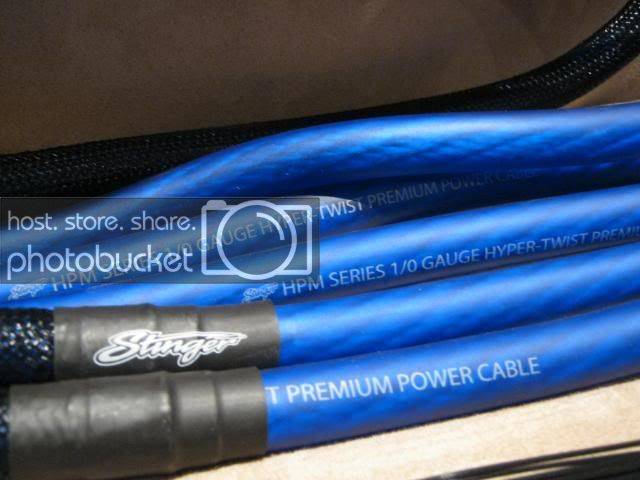

Since I already have a system in my ride.......I just decided to beef up my power by adding
another run of 0ga wire. Stinger 0ga kit....

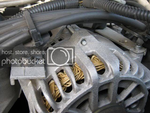

Mechman 6G 270amp alt wit some lil custom brackets I made for it lol
Gotta have that power plant

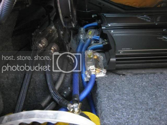

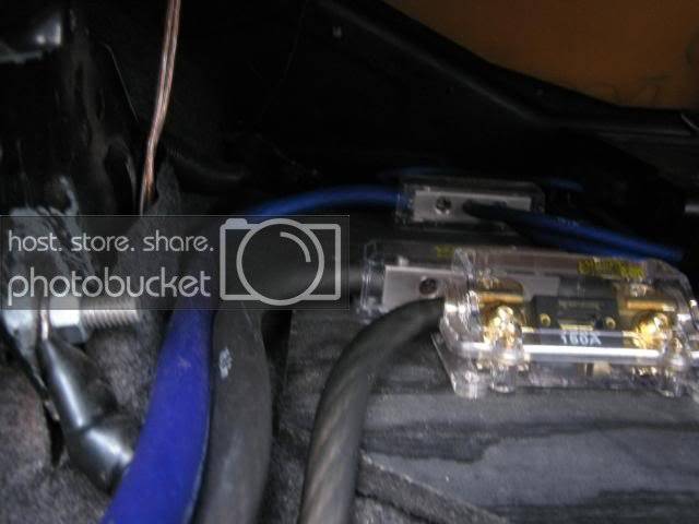

Some random pics of the wiring up front

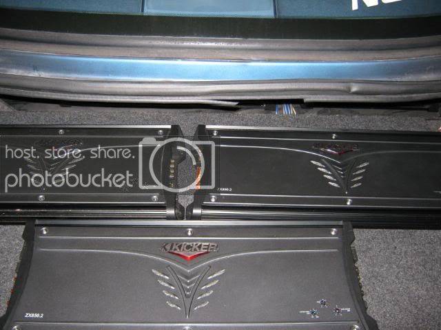

Got 2 new Kicker zx850.2's (in the plastic) and one more new kicker zx1500.1
All together I'll have 12 kicker 6's, 2 kicker 6x8's and two kicker 6x9's and a few kicker tweets
Swapping out and already sold 3 of those amp in the back drop

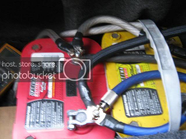

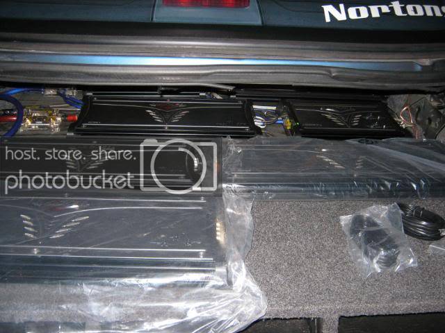

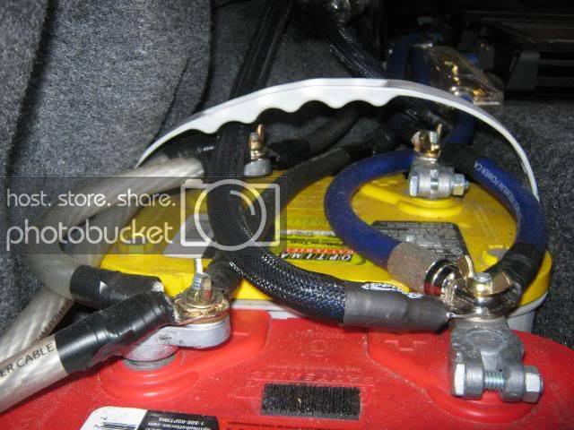

Couple more pics of the batteries and the wiring....everything wired up
Lol.....yeah I know i need get identical batt that'll be later tho.....
Back batts grounded to the frame

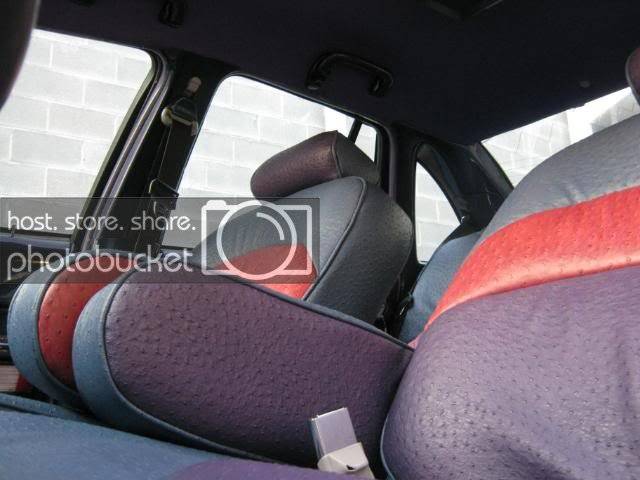

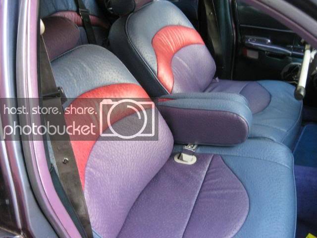

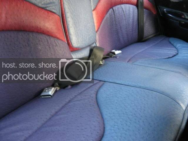

Interior is in.......
This color was darker than the swatch i had so it didnt really look like the paint
when it flip red.....but when its cut yards you cant send it back so i had to use it

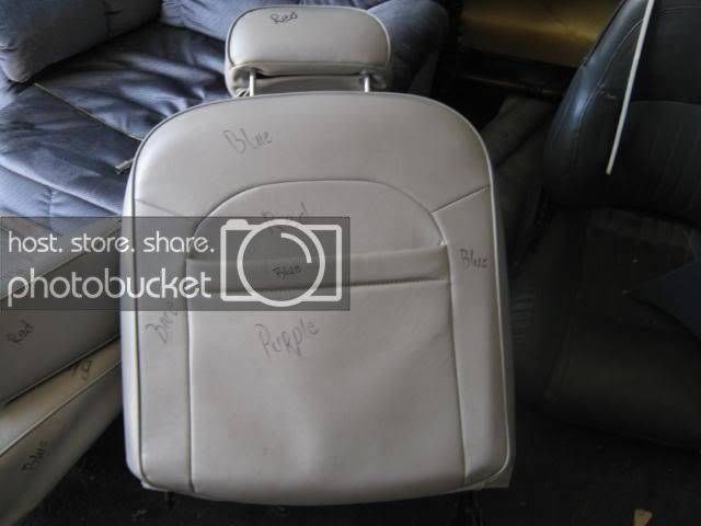

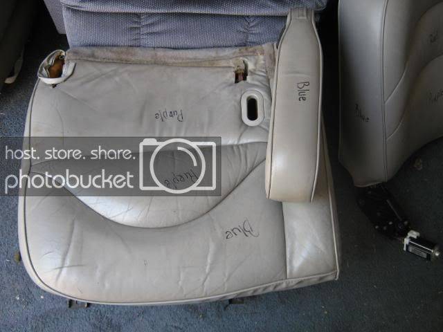

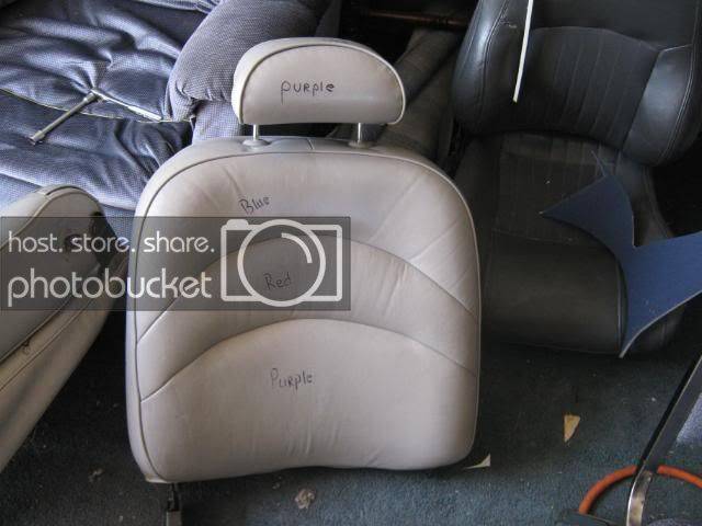

Seats dropped off the upholstery shop and marked for colors
Say good bye to my grey leather
Everything looks good so far
