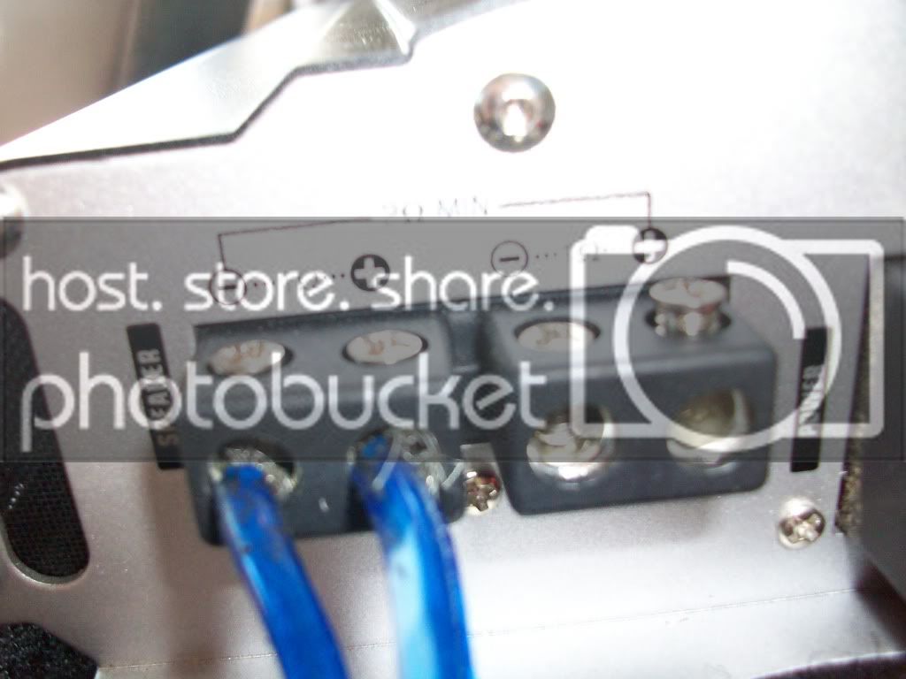

It works when I have it set up like this...

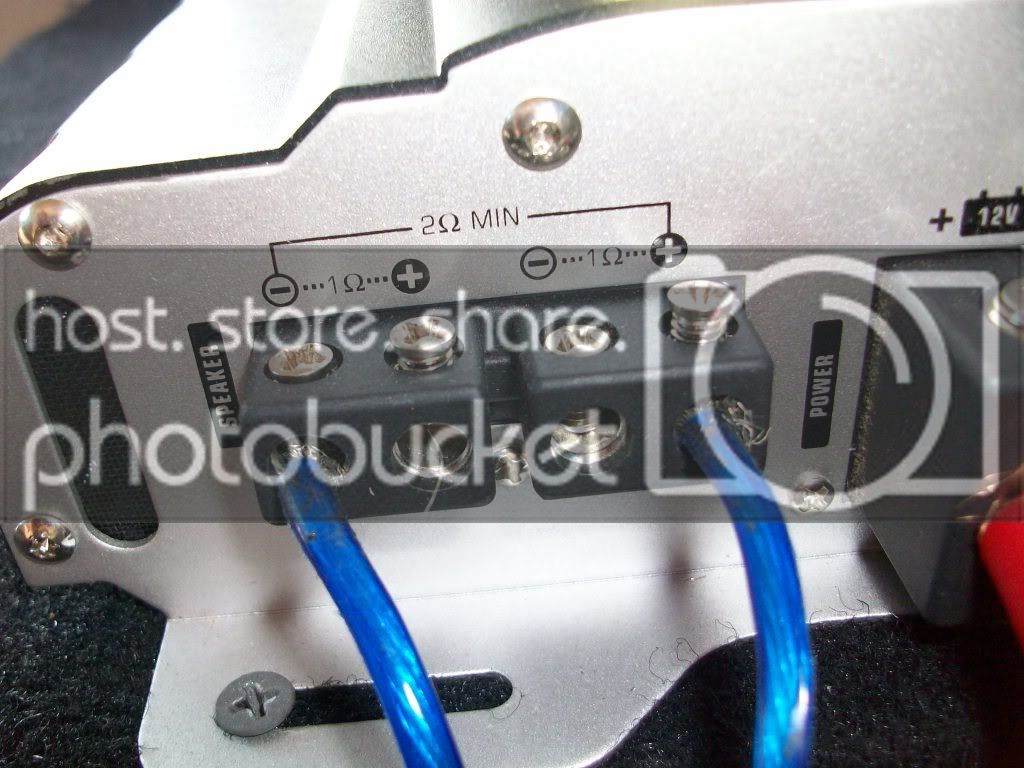

When I have it like this its loud but goes into protect when I crank it or when hard bass hits.
My voltage stays at about 13v when I have it the way the first picture is, but when I have it the second way pictured my dmm goes all over the place and isnt accurate at all.
Bro, you don't have to be a rocket scientist to see why it doesn't work in the second pic. It clearly says 2ohm min, when bridged. And you just said your sub was a D2. lol, hope you get it figured out.
