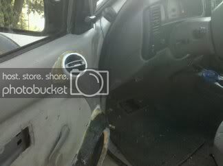

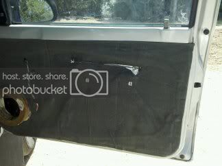

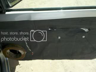

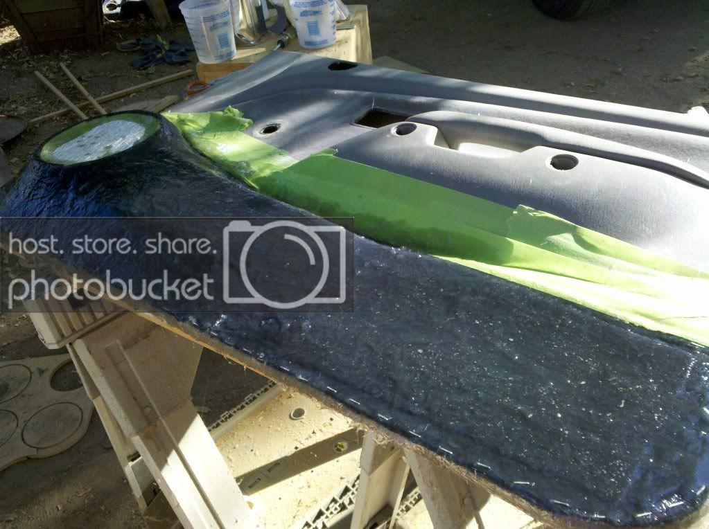

Alright got the door trimmed and semi-sanded.
Put the speaker in and attached the panel to check for proper fit. Looks alright to me.

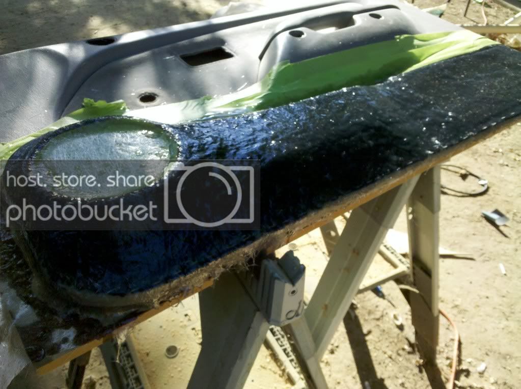

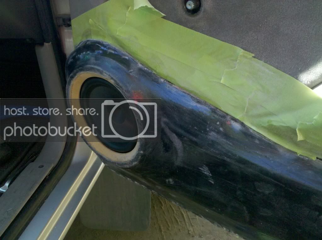

First layer of 3/4oz Mat
Doing more work. Taking long just for the mere fact that I'm working on it on my days off.

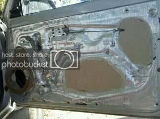

Sealed up my doors. Tomorrow throwing on some Ensolite IUO to finish it off. Was actually impressed with the mid-bass improvement.

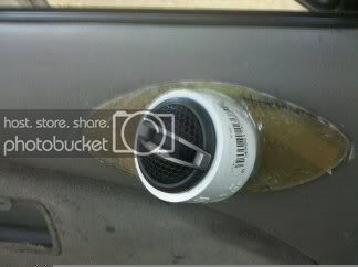

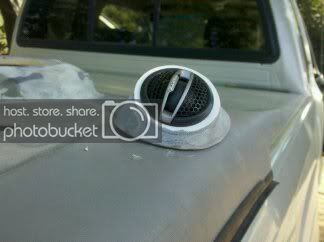

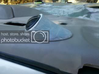

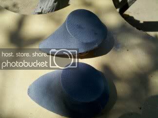

Messing around with tweeter placement. So far I like this shot of them shooting towards the dome light. The frame will be covered with some cloth and glassed.

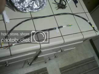

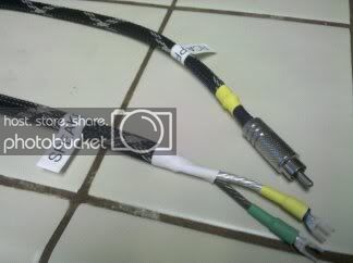

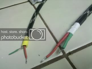

Made some hookups for my oscilloscope to make secure connections with the prob. I'm using a DSO Nano v2
One for RCA and one for speaker
