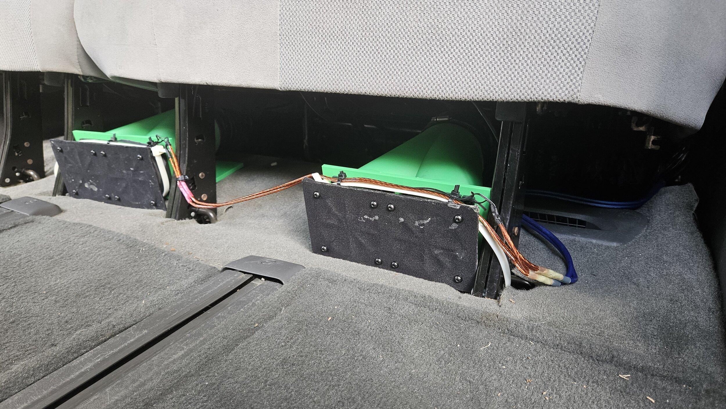

Under the rear bench seat.

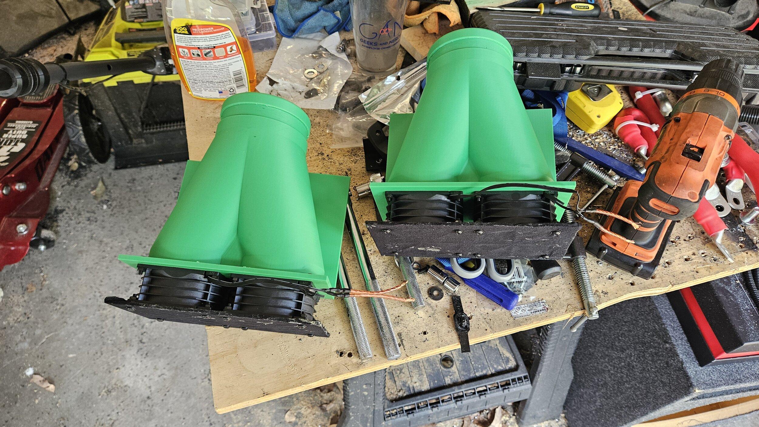

Here's the ducts. They don't really fit. It's definitely pinched around some of those corners, but thankfully the server fans still force a lot of air through.

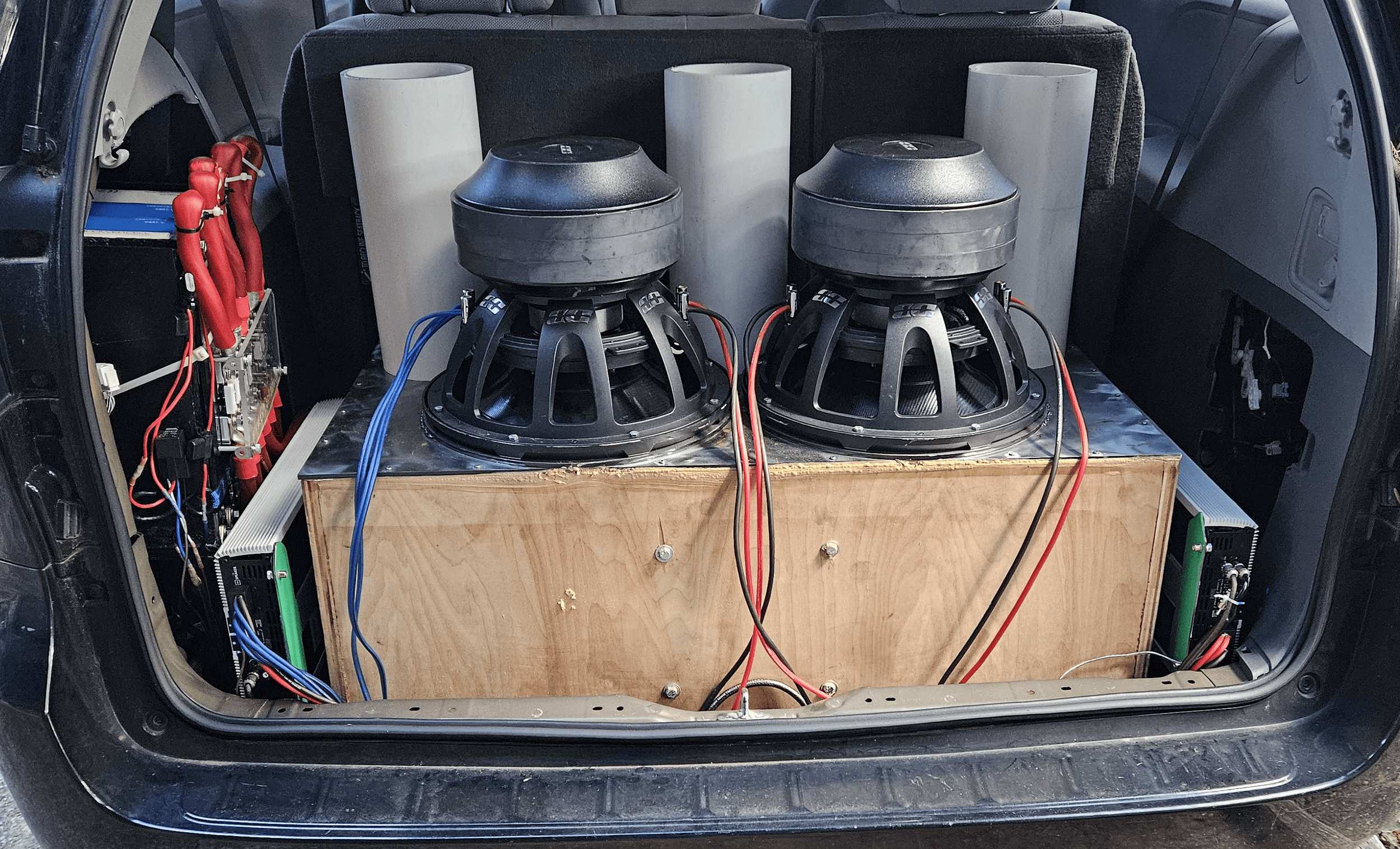

Finished 95% of the work adding a relay for the fans, balancing and putting the new cells in, wiring for the second amp - and then realized I'm short like 2 or 3 feet of 4/0 cable 😂
On the bright side, there's not much left to do to get the second amp, and the wire should show up this week, so I ought to have the second amp in very soon. Then the system will be complete. I've been pretty happy with just the one 8k; I can't wait to see what these subs can do with double the power.

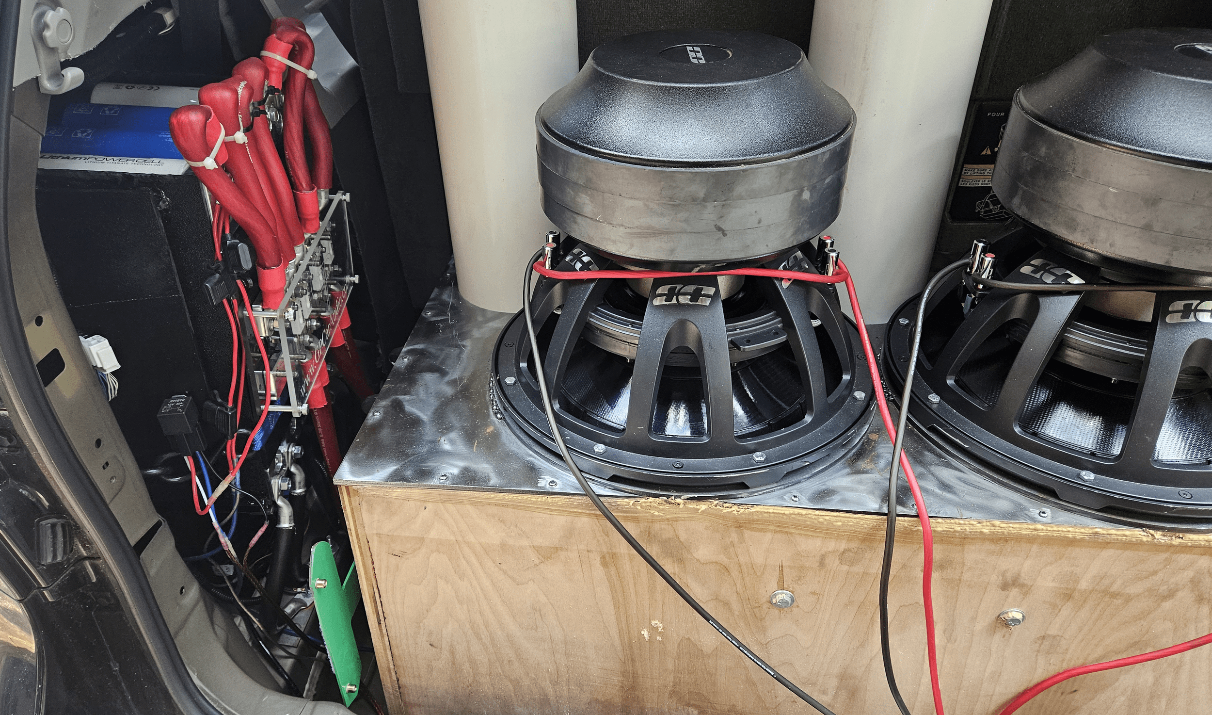

You can see in the pic I have all 24 cells now and I removed the top of the box to make it easier to slide the bank in and out.
Don't mind the mismatch wires, I ran out of 8 awg and made do with two 12 awg
I also wired one coil from each sub in parallel to the amps. So each amp powers one coil of each sub. Mainly just so I don't have to worry about keeping the gains exact.
