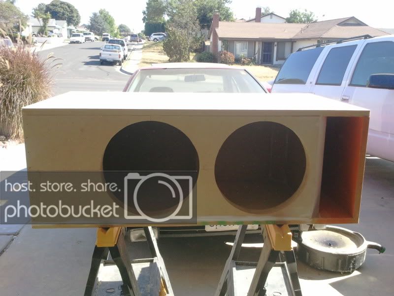

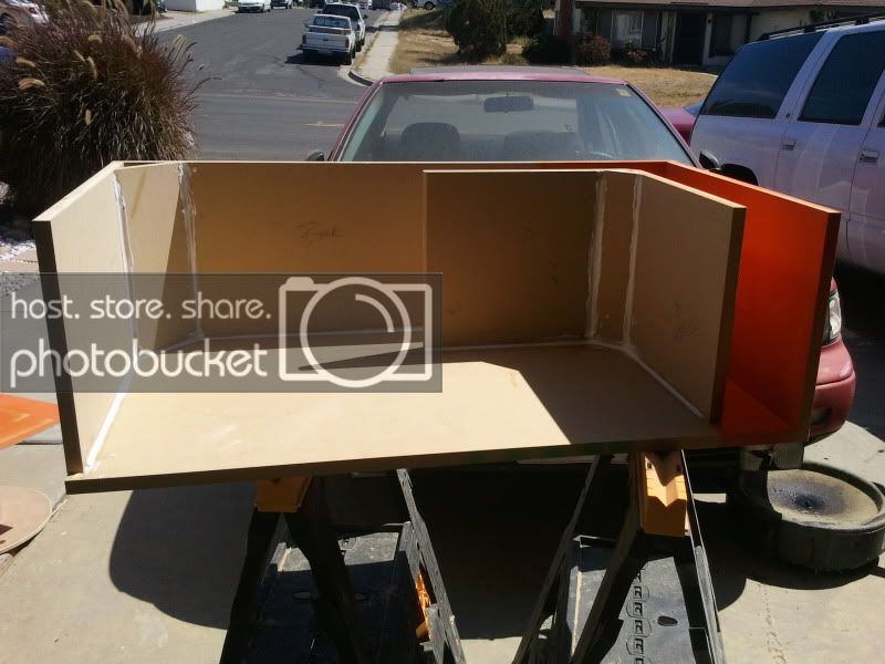

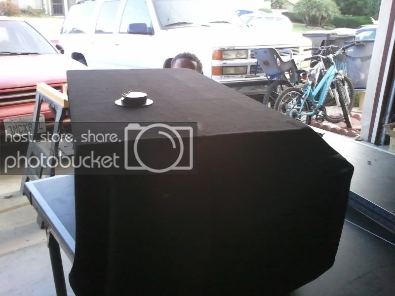

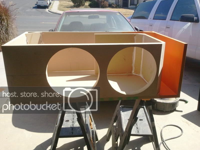

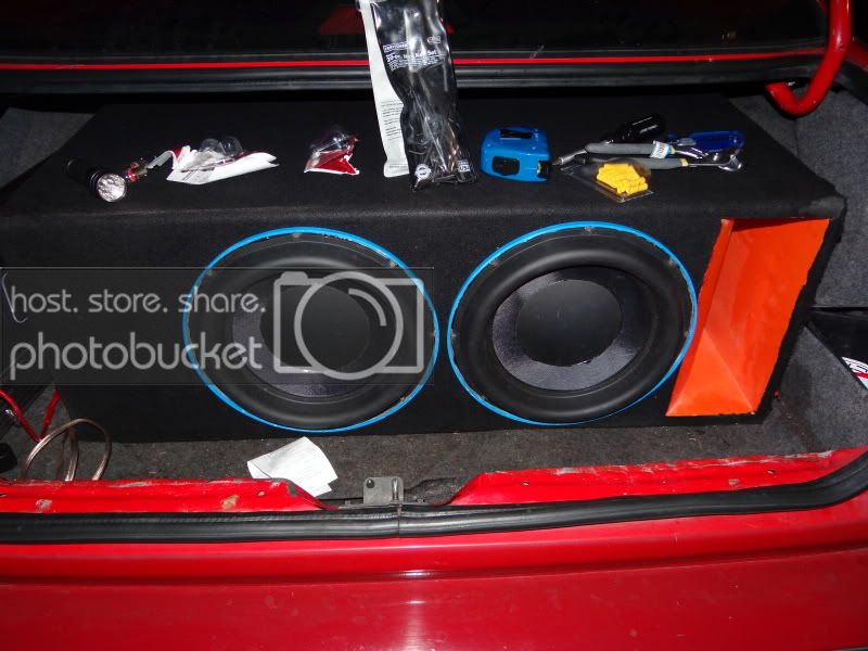

Box is 3.8 cubes after Disp. tuned to 28hz....wanted a nice amount of low end from the subs...have them right now off an Oriond 2500d at .5 ohm
ididnt get as many pics as i wanted......my bad but i will be getting vids up today
here where the double baffle meets u can see the 45 degree cut at the port mouth.... we used bondo to cover the lines and such...came out clean and smooth
