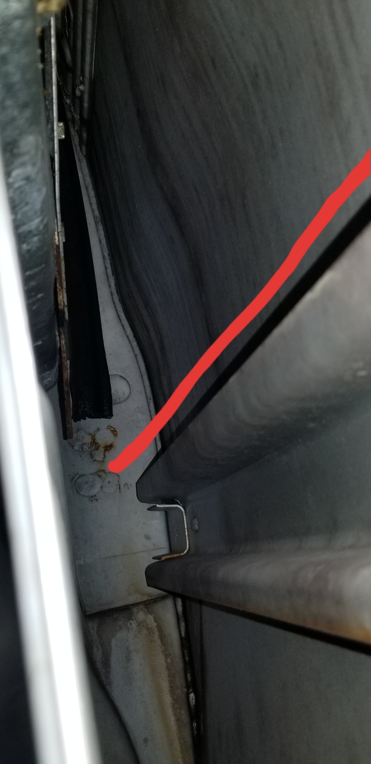

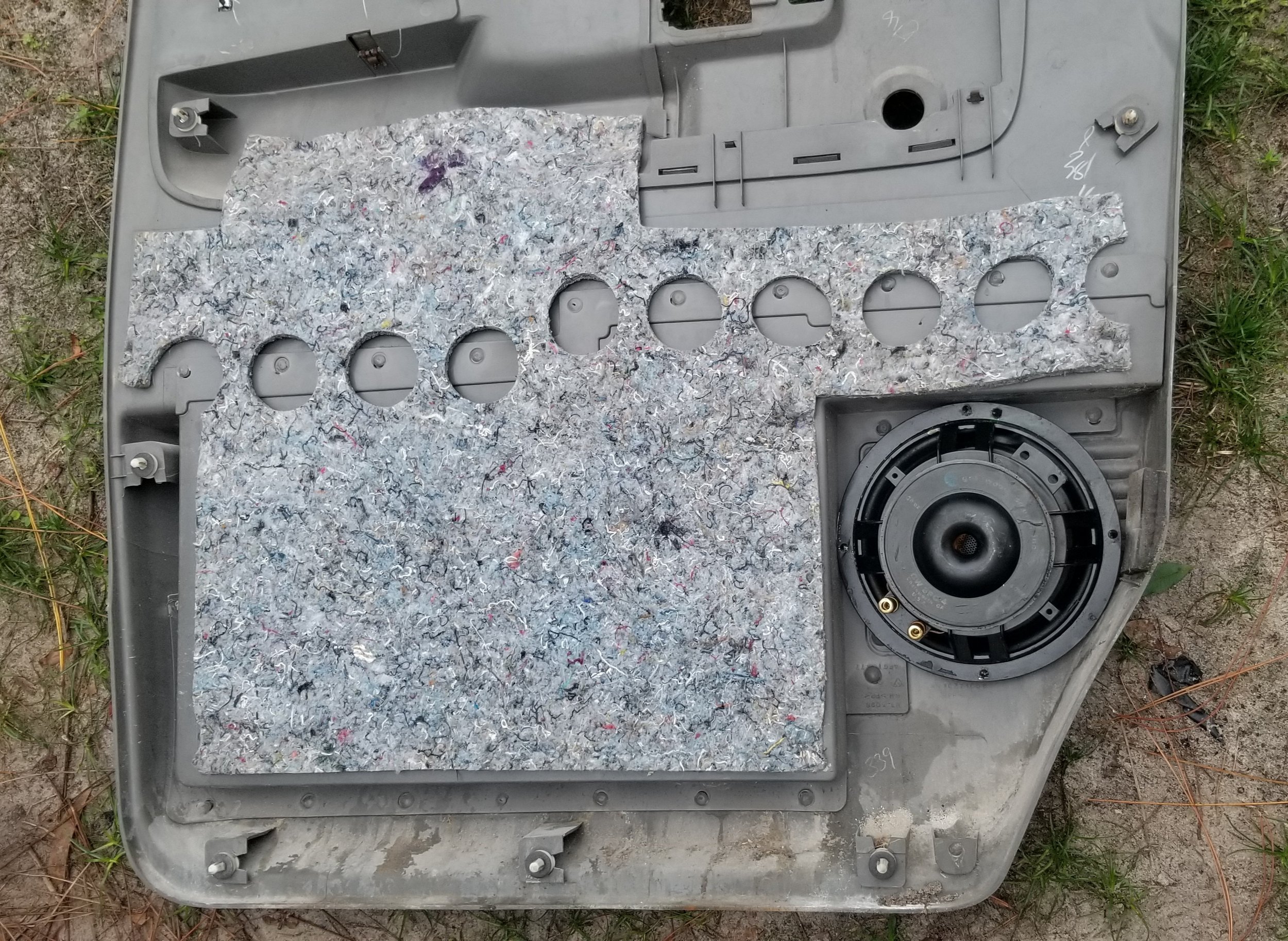

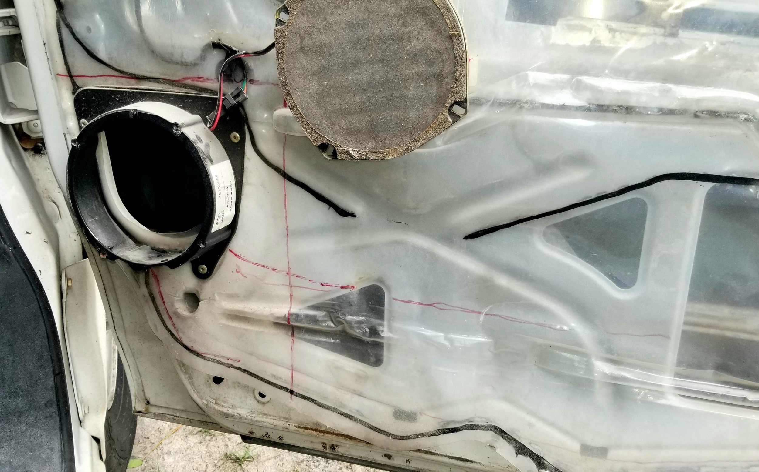

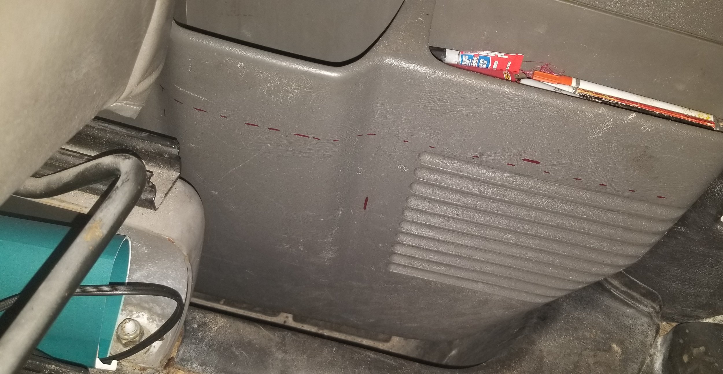

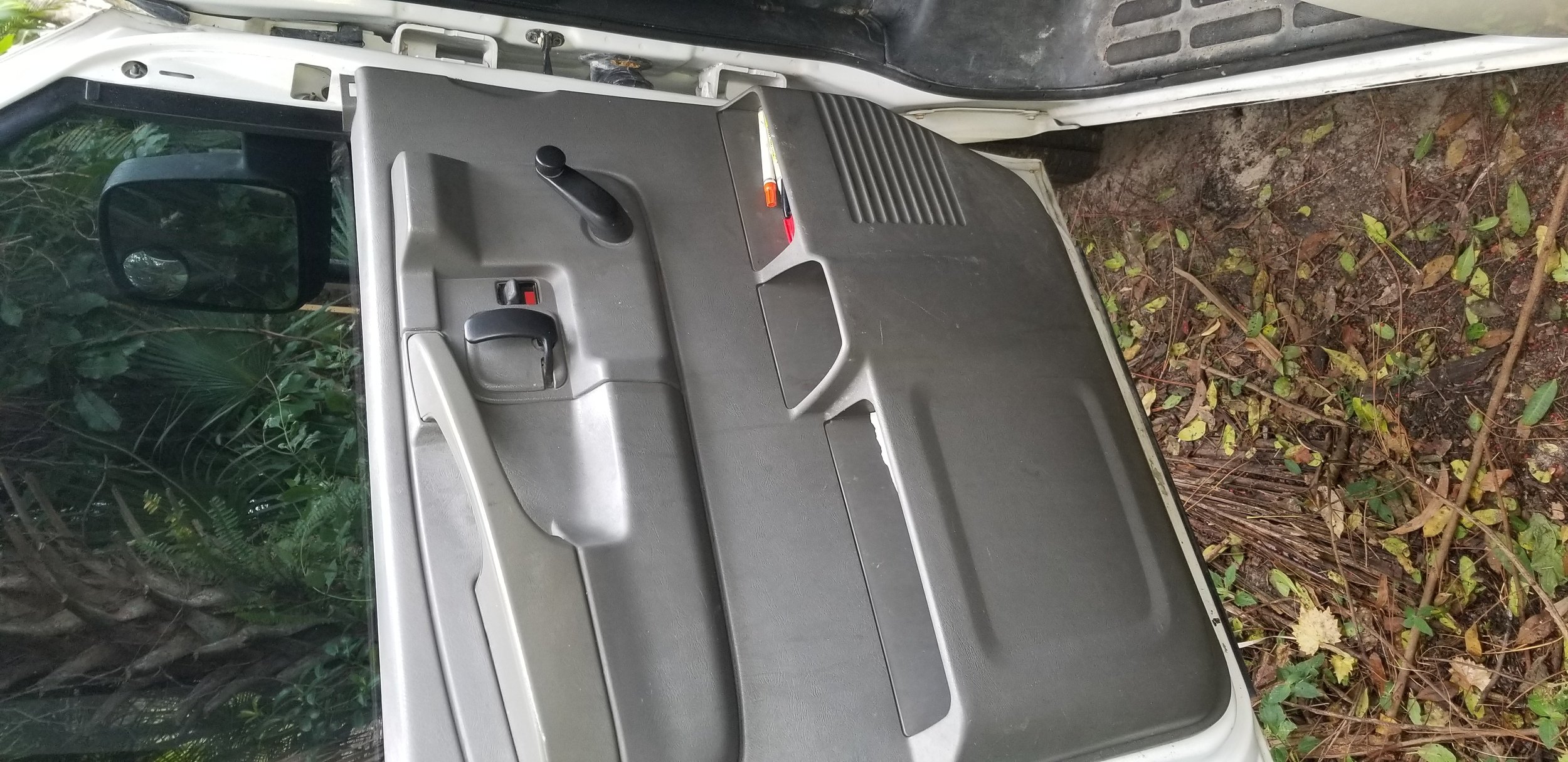

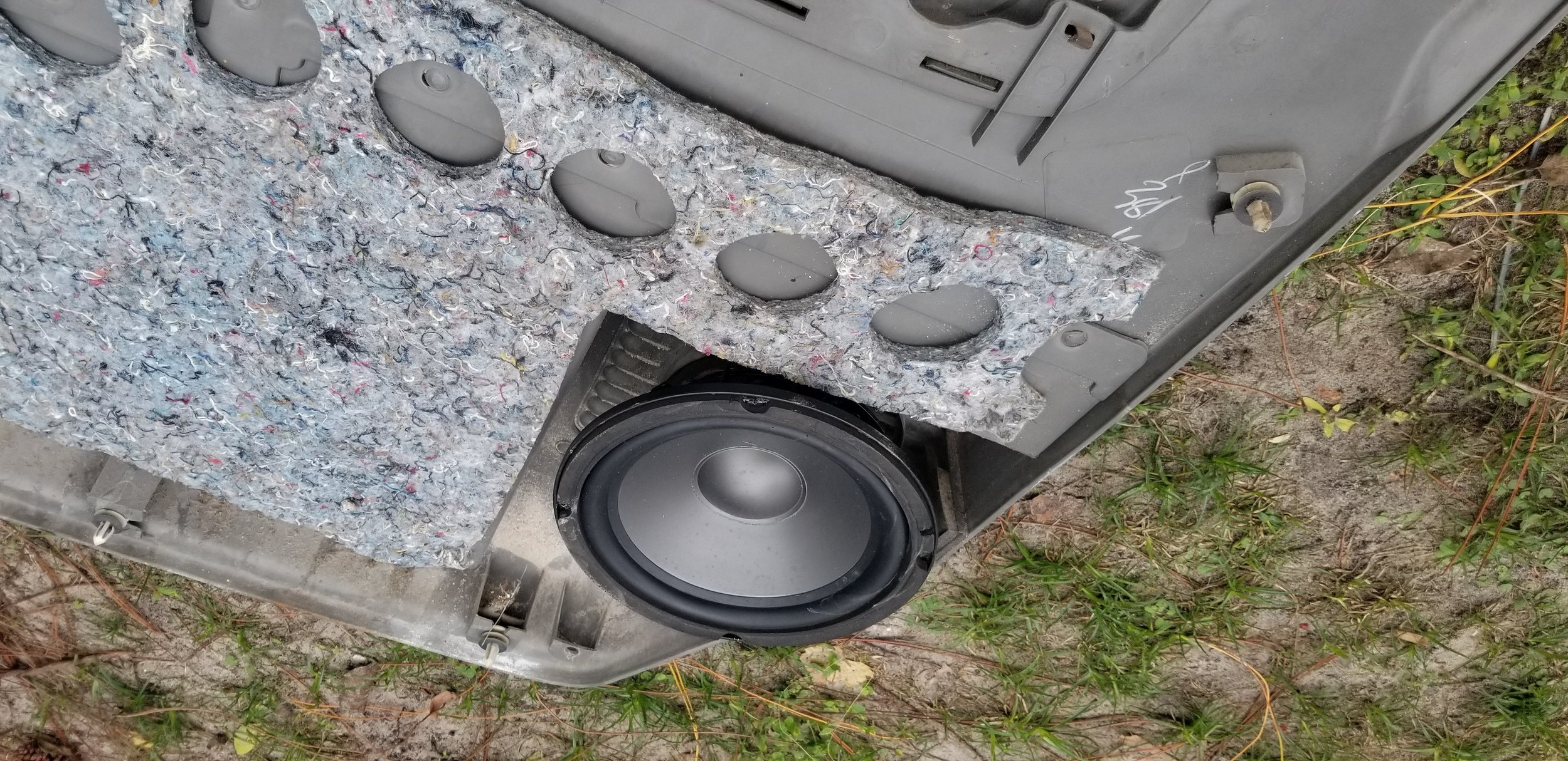

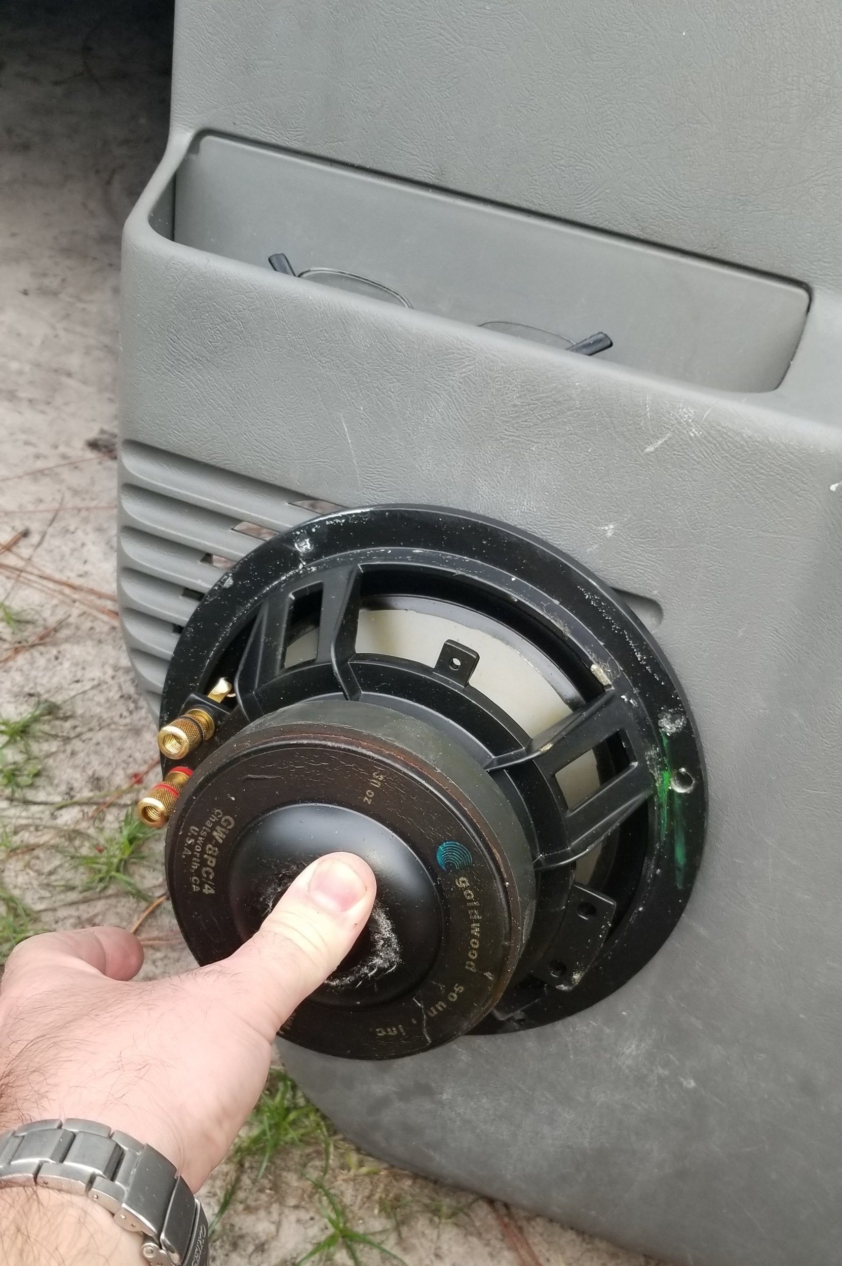

Alright, heres some pics of what were working with.
The red line is about how low the window glass goes
The verticle sharpie lines on the door skin correspond to the open part of the panel where the speaker goes, horizontal lines are where I could cut the door sheetmetal and have the pod slip under the window glass.
The plan would be to top mount some 1/2 MDF outside the door panel for the speaker to front mount nothing fancy in the looks dept, then make the pod in the back out of 2 or 3 layers of 24oz woven roving.
Can you picture it? Its gonna be a hack job lots of sheet metal missing ect. This is my work truck btw guys looks dont matter at all it's just a white van with my company logo on it no one ever rides in here but me and an occasional helper so no need for a full custom door panel or nice looking pods, just flat mdf screwed to the outside is fine.

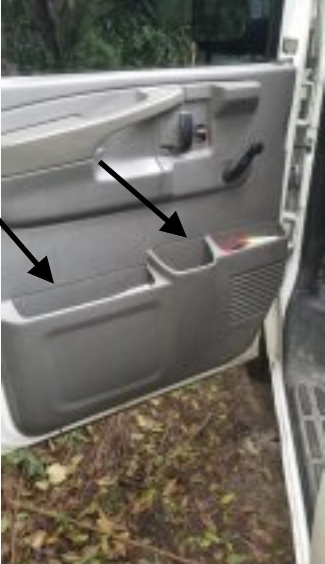

here is what I would do. Attached is the pic you took of the entire door panel. You see the line I put arrows pointing too? I’d cut on that line to get rid of everything below it. 1/2” mdf mounted to the door skin use bolts and washers and I’d use mdf rings and build them out using dowels or 1x2 pine etc. Staple the fiberglass cloth over it to give me my shape I’m going for and start glassing it. If you know how to work with fiberglass this ain’t hard to do at all and you can actually make it look nice just by covering it with carpet. You will easily get the most airspace this way and you can run dual 8”, 7”, 6.5” etc drivers if you so please! Now what drivers? Gotta settle on the size, with a budget of $300 the choices IMO are pretty wide especially since it’s an enclosure involved now.

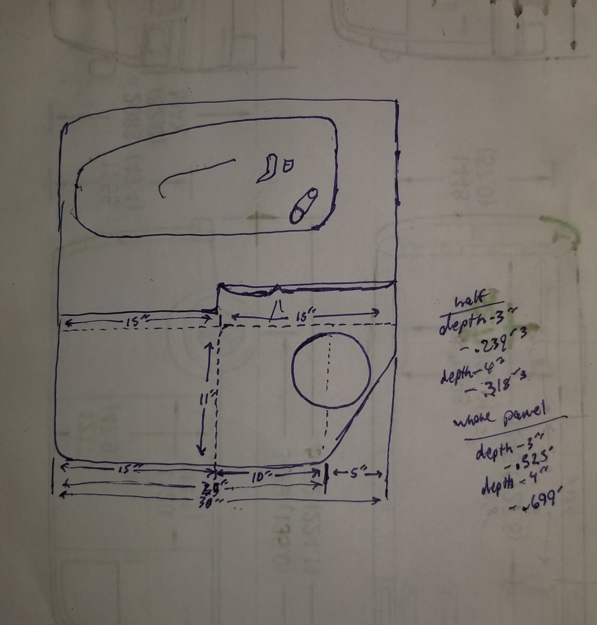

Damn that's a good idea. I'm thinking I'll hack it a little lower so I still got some shallow door pocket action. Heres some rough specs, if I just do half the door without it popping out any (3" depth) I'll get .23' if i make it pop out an inch, or cut the door and send it back an inch (4" depth) I get .32'. If i wack the whole door panel front to back i get .52' at 3"depth, .69' at 4".
I'm leaning toward the 2nd option at .32' and I still have a door pocket, pretty good. I'm assuming the box is gonna be 1/4 to 3/8 thick solid fiberglass, with some bracing I think itl do.
