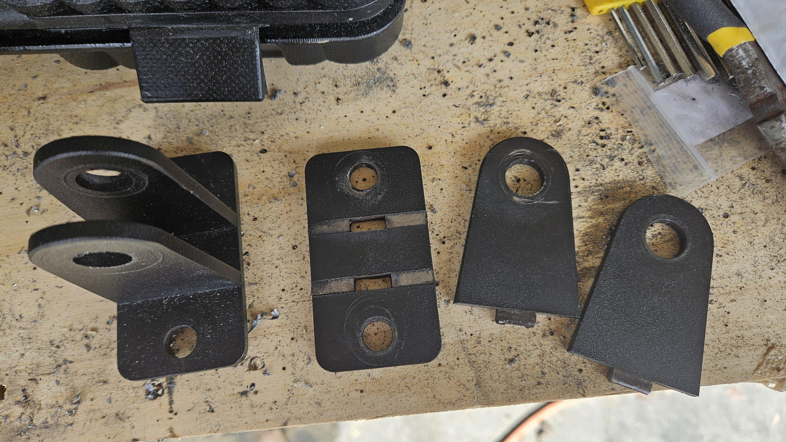

They fucked this part though.
These are the brackets at the end of my stripper pole. You can probably see why it failed. Those pieces that attach to the base plate were only welded at the bottom of the tabs. And poorly.
The broken one in the picture failed naturally. I tested the other one afterward by whacking it with a hammer. It bent lmao. Yeah, the metal pieces are 1/4" thick, I shouldn't be able to bend it with a normal hammer. The welds just stank. broke them by hammering to bend, prying back, hammering again a few times.
Very annoying because the part cost about $160. I shouldn't have to redo it myself. Removing the powder coat, breaking the pieces apart, welding everything...
And also sucks because now it has simple spray paint covering I did instead of the powder coat.

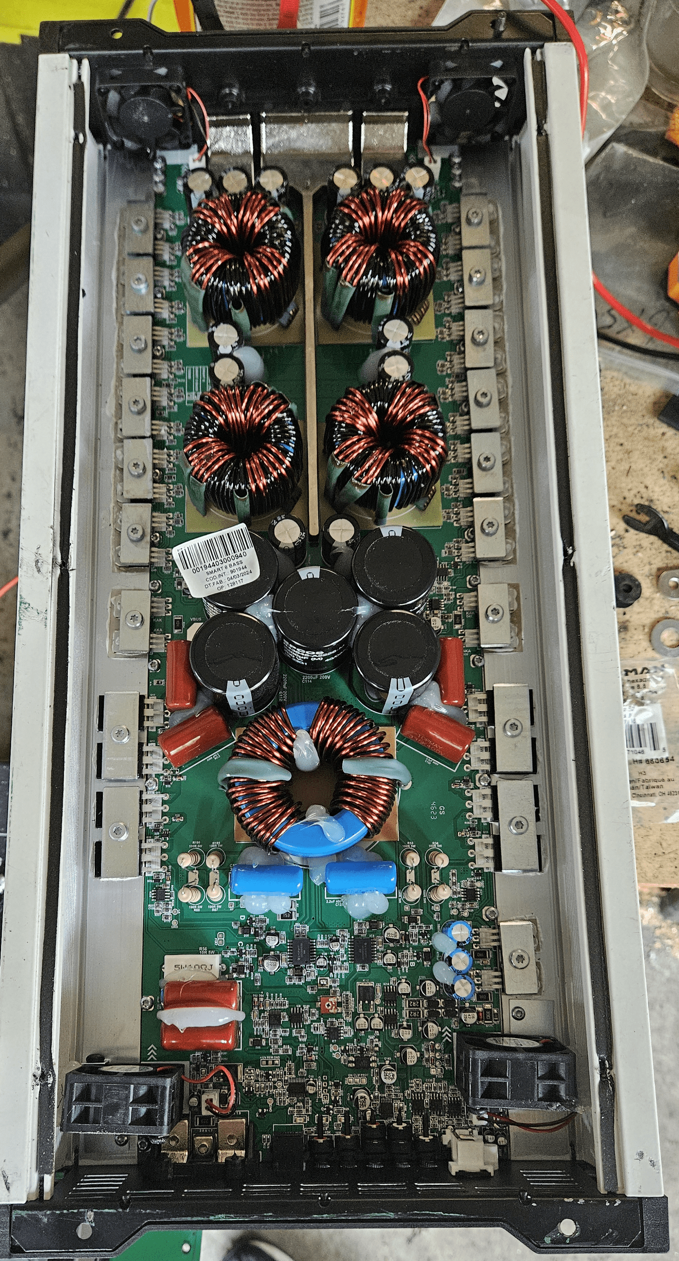

I ordered 12 more LTO cells and another smart 8k last week, and then... my first amp died a couple days later 😂
I think it died from heat, but I'm not sure. The amp went into thermal protect a couple times this summer. I turned it down whenever it happened to let it cool off a bit, but I think there's just not enough air circulation in/out of the trunk. I crammed a lot of equipment in there and I think the hot amp is just circulating the same hot air over and over through itself.
When it failed, it failed suddenly, but there was no smoke or anything cool, it just quit working lol.
The smart amps have fans that only turn on when the signal is high or the internal temp is high. It's been so hot here the amp fans would just turn on and stay on even if I wasn't playing the system. That's what makes me think it was heat.
This is the first amp that's died on me without fireworks lmao. Maybe taramps has really good protections built in.
Here I am testing it on a benchtop power supply, it just goes into protect during the start-up health check:
So I have to setup something to improve the airflow in the trunk.
The easy move is to replace the internal amp fans. I got some 40x40x28 mm server fans for the new amp. They move a crazy amount of air for a fan that small because they do 15k rpm. And taramps put fins on the inside of the heatsink too, so that internal airflow will help.

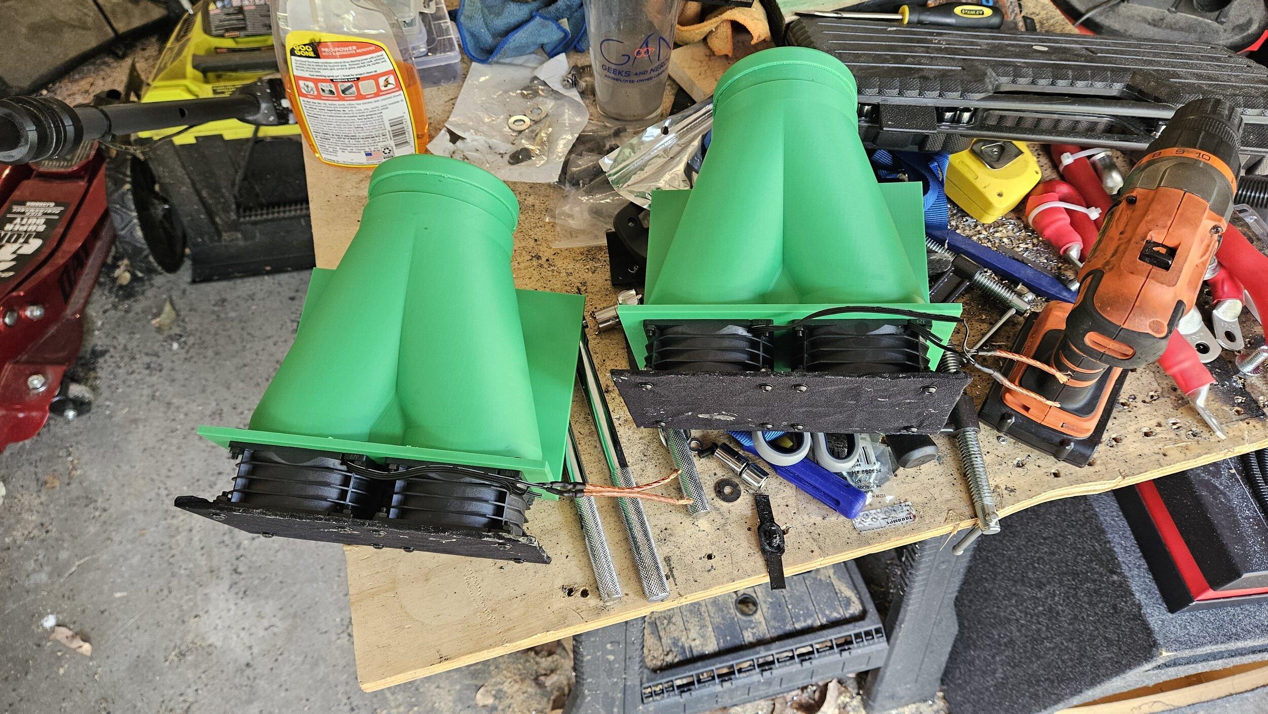

To get fresh air for those fans to move, I'm going to use some 4 inch air duct and fans under the rear seat. I was going to get a 4 inch duct blower for ventilating an on-board boat bilge, but I wound up deciding to 3d print a case that'll hold 2 80x80x38mm server fans and mate them to the duct.
There's barely enough room for that duct to fit from the rear seat to the trunk, but those server fans have high static pressure, I'm hoping they'll be able to just force their way past bends in the hose.

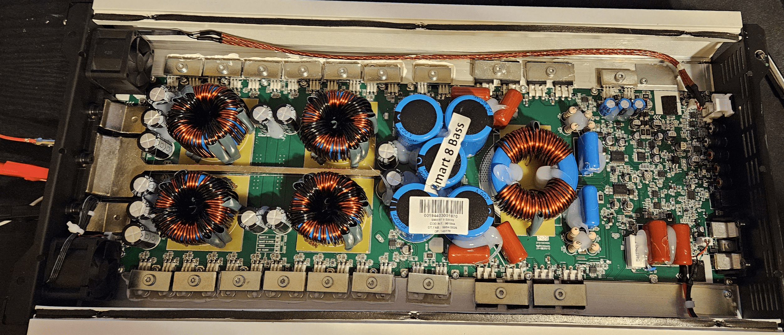

I'm also going to run a wire from inside one of the amp fans so I can use it to activate a relay for the under seat fans. That way, the amp will turn them on and off, so it'll use the smart circuitry taramps built in. I like that the fans only run when the system is bumping, so I don't hear it. In my last car I had an MD 12k, the fans were always on and I had to replace the fans with some quiet Noctua fans because the stock ones were annoying. In the smart lineup the fan noise doesn't bother me so I can use the loud but far more powerful server fans.
Here's the new amp, with 40 mm server fans. One of the fan plugs is blocked because the new fans are deeper than the stock ones and it covers the plug. I just ran a wire to one of the fan plugs on the right side. I'm running 2 fans instead of 4 now, both on the exhaust side. I also hooked up a wire to the other right side plug, which runs outside the amp to trigger the external fans.

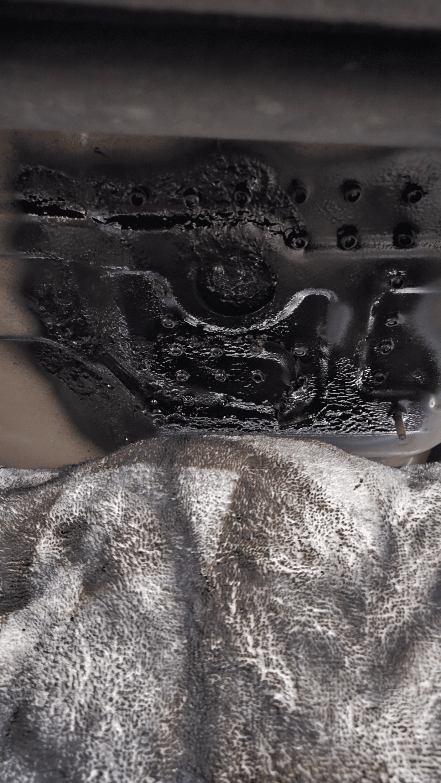

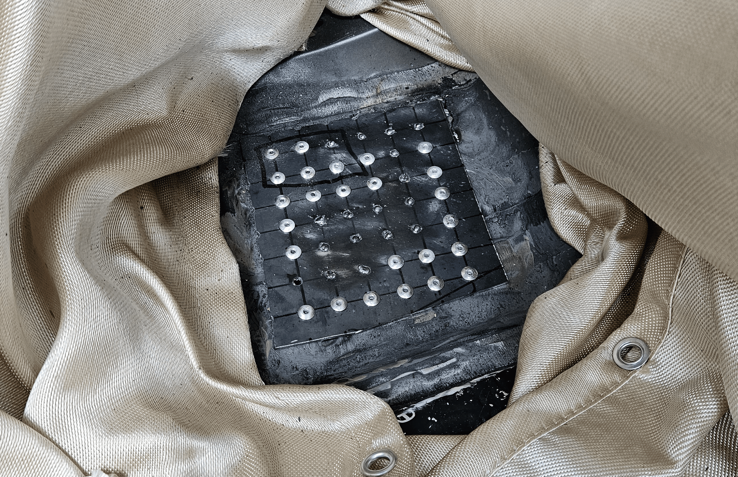

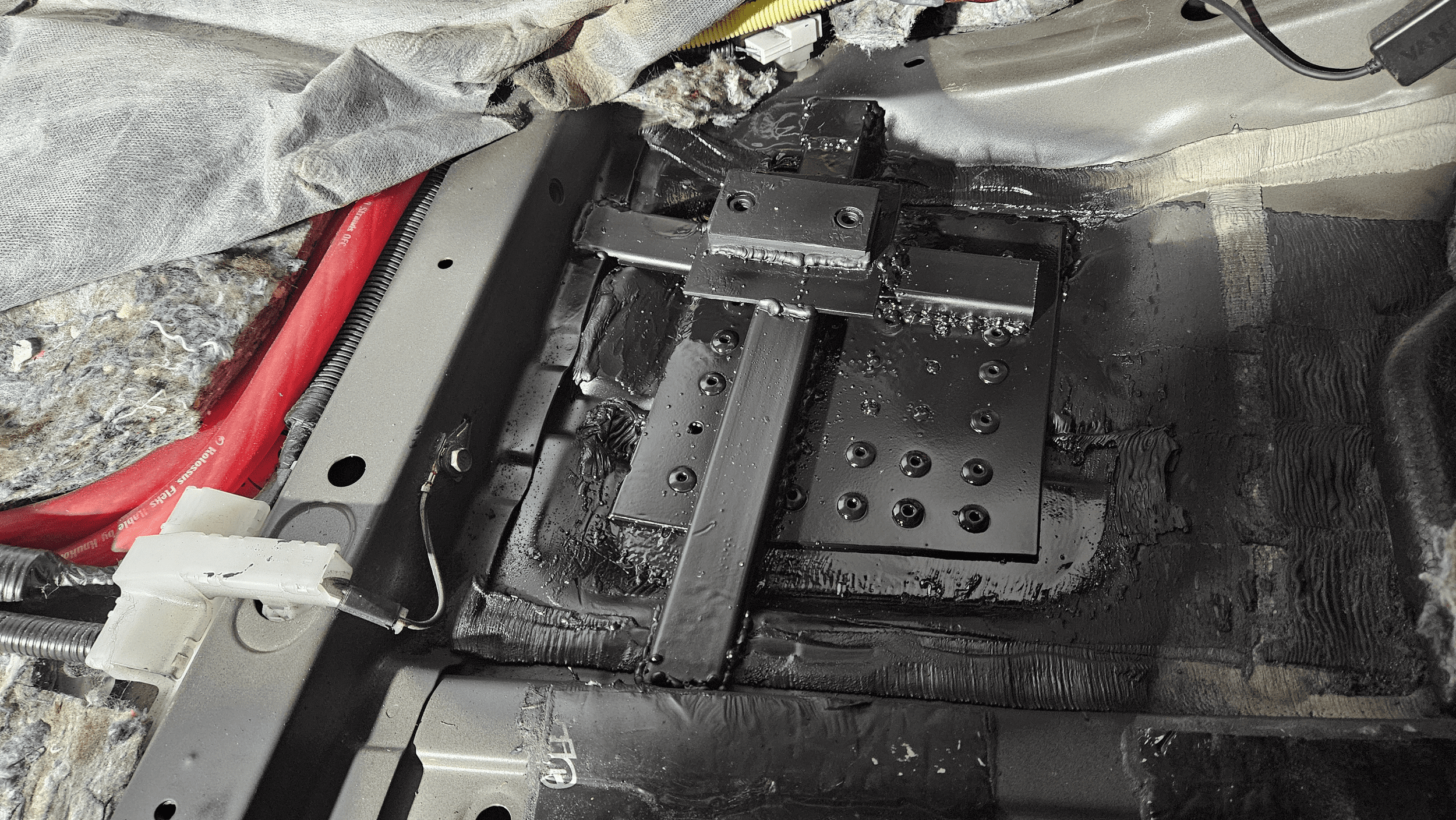

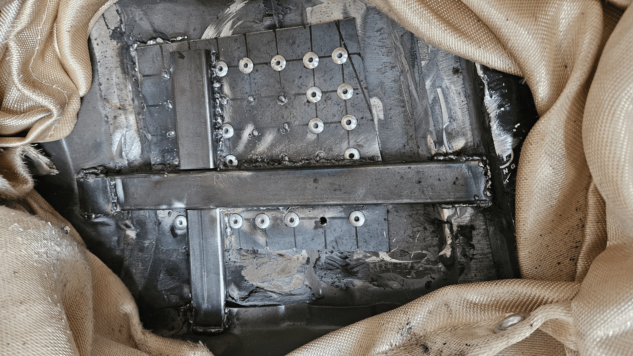

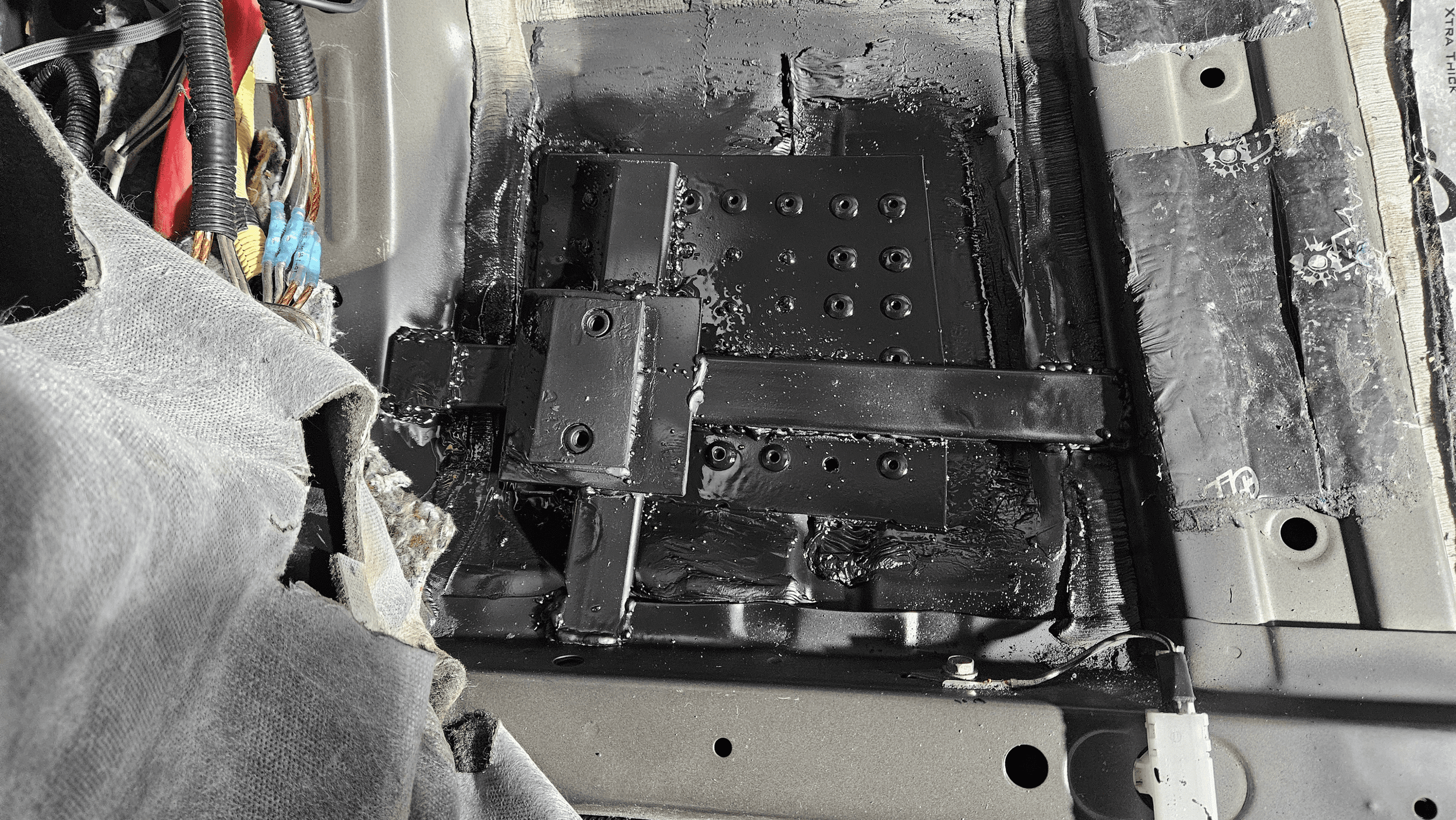

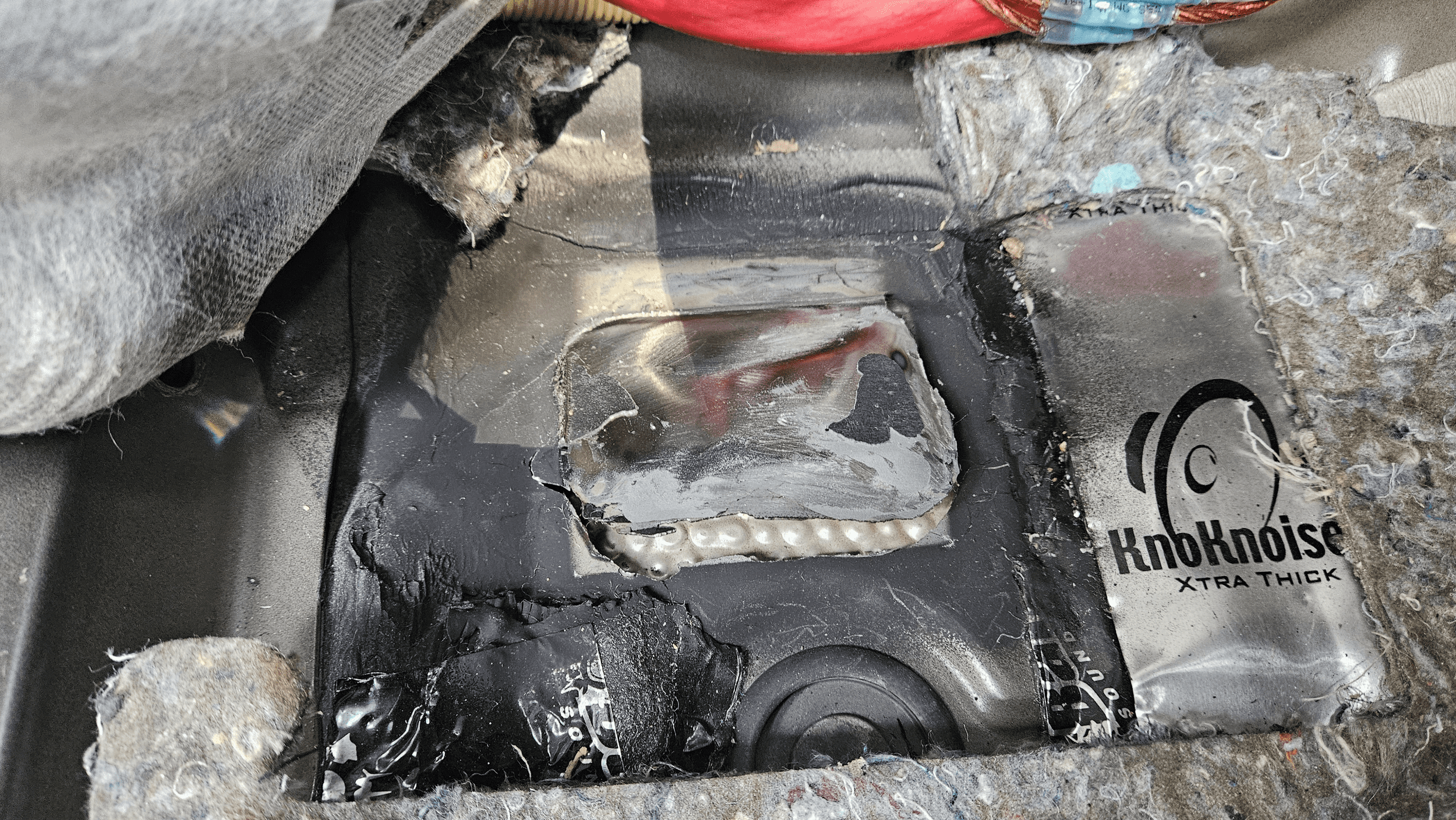

Thankfully, the only thing on the under side is that heat shield, so I could just pull it off, cover the exhaust to protect it, and then weld directly to the floor pan instead of using panel bond like I did before.
I welded that crack together. I then welded some small 1/8" plates into the dips to make the surface flat. Then I attached a big 1/8" plate with rivets through the original floor or welds to the new plates I put on.
