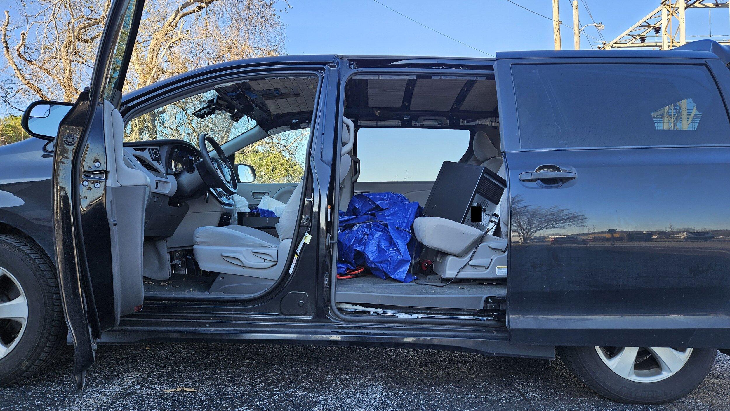

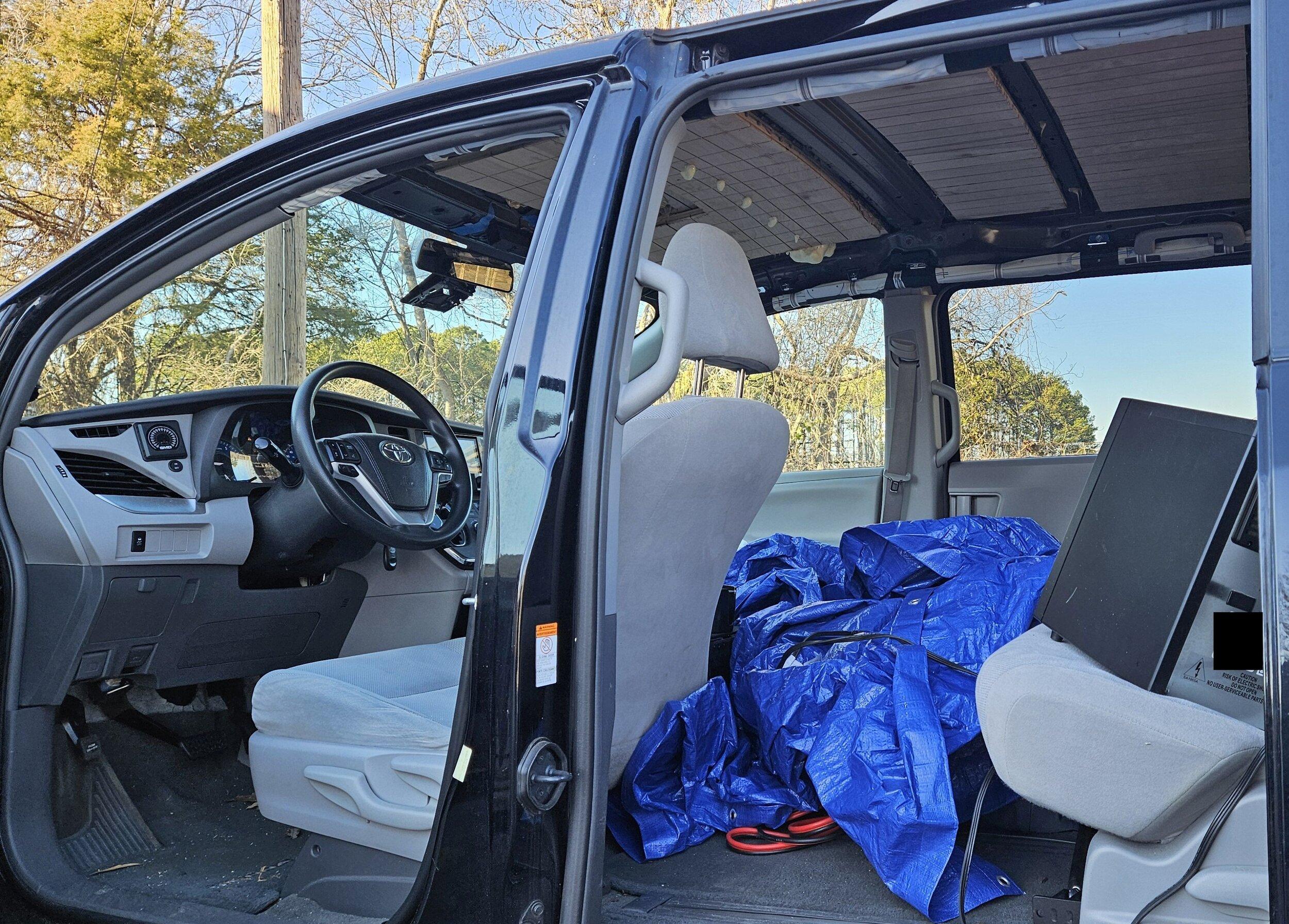

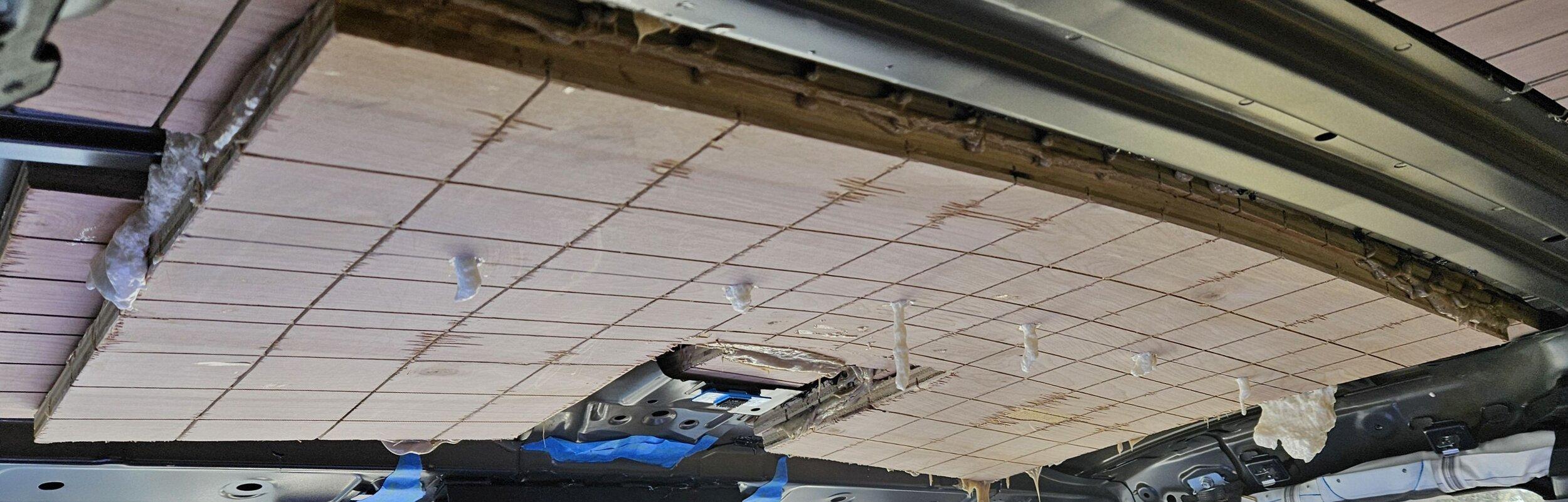

I decided to add a second layer to the front. It's ready for the headliner to go back on now. It should just go on with cutting some of it out and removing insulation from the back, fingers crossed.
Pardon the mess. I laid tarps to protect the interior. That black box is a space heater which I put in the car to keep it warm so the panel bond could cure properly.

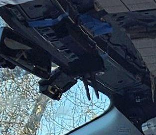

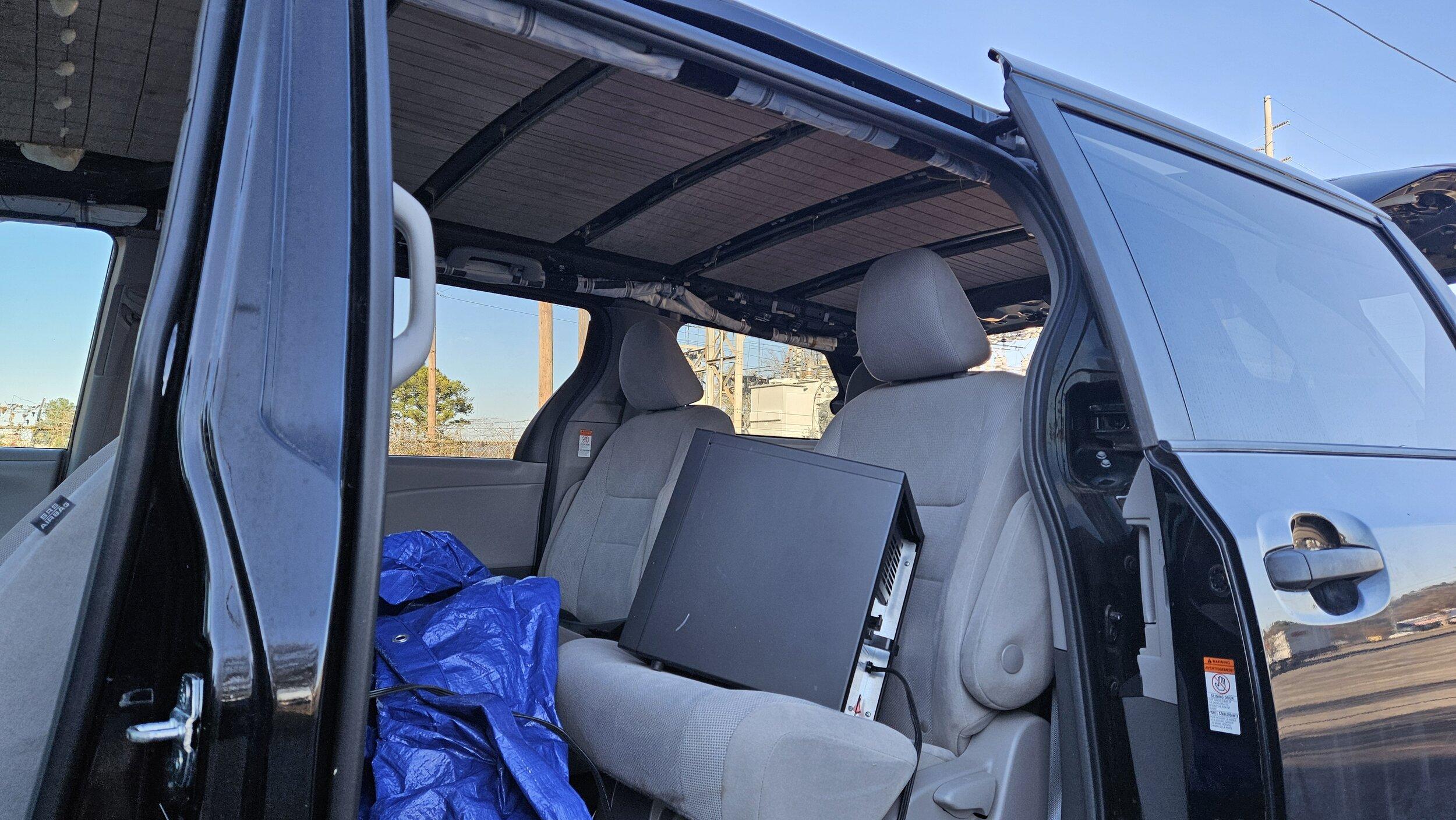

This is a metal piece I made to bolt the top end of the stripper pole to. I bought one from here: https://jims-machineworkx.myshopify.com/collections/box-braces-and-supports/products/box-brace-kits
View attachment 62370View attachment 62371View attachment 62372View attachment 62373View attachment 62374View attachment 62375
This is a metal piece I made to bolt the top end of the stripper pole to. I bought one from here: https://jims-machineworkx.myshopify.com/collections/box-braces-and-supports/products/box-brace-kitsView attachment 62376
Adding mass to that Minivan roof and overdoing it especially up front should yield fantastic results all by itself, a stripper pole to calm the front of the roof @ the windshield even more is like money in the bank. I'm unsure how loud your setup gets but its difficult to damage glass if the cabin is solid especially where it counts.

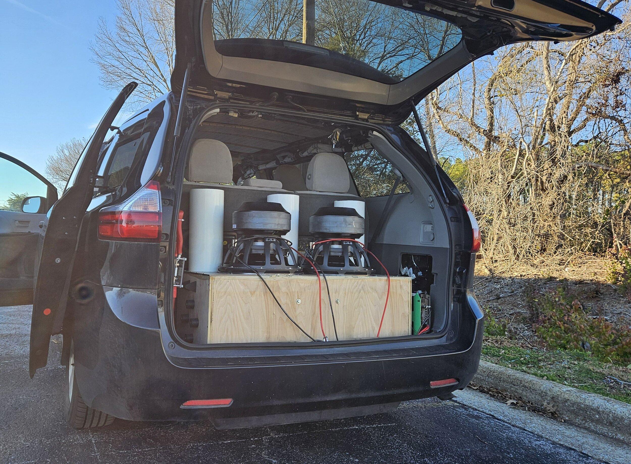

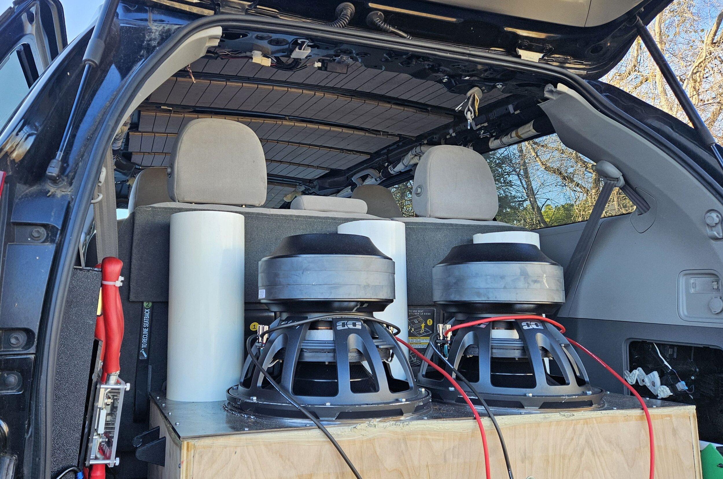

I'm aware of the damage a pair of 4515's can do, I just designed this for 13ply Baltic Birch and a 10" Bap for an Impala trunk. Crossfire 12K powering it with like 90ah of cmaxx. Happily the rear deck is already vented into the cabin substantially so the sound won't be completely trapped. I hate the "gorilla in the trunk" that happens when most output is trapped in the trunk.
Largish airspace and demo-daily tuning should be what the guy wants. Bassheads are not easy to please... they always want more... haha. The 10" Aeroport was used in his last enclosure but without the outer flare, doing that is like shooting yourself in the foot at his power levels Imo. Both flares are necessary to benefit from an Aeroport.
The flares help transitioning airflow into both environments (cabin/enclosure) decreasing boundary layer turbulence.
The increase in efficiency at both ends actually causes laminar airflow to almost match core velocities. The increased efficiency especially manifests at high output and "greases the air" where most compression would happen at hi-output levels with a round port.
Good to hear, I'm hoping all this will keep the windshield together. I have an spl labs mini bass meter but haven't metered the car yet. I'd guess I'm playing comfortably over 140 db rn, but I've been keeping it down because of the flex.

Bassheads like it low and loud without peakiness. Those 9515s don't become peaky until a super large airspace is used. I liked 4.2ft3 ea @ 30hz (approximately) knowing he likes lows and wants some under 25hz content.
The guy building the enclosure is the same from the SoloX build thread. I threw him a curveball on this one as certain parts are irregular and require a different assembly order.
Check out the window brace...

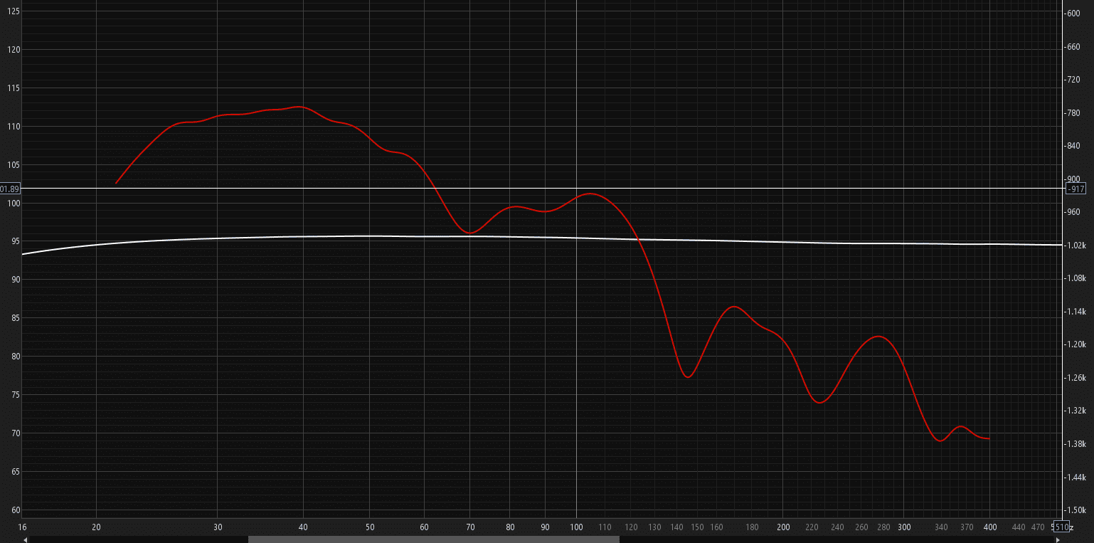

Got the roof done. I have been messing with my speakers to dial them in. Here's the measurement of the subwoofers. It's low level (so the RTA mic doesn't break), so not indicative of SPL at full tilt, however it shows the frequency response. It peaks at 40hz. plays very nice and flat over the entire bass range.
