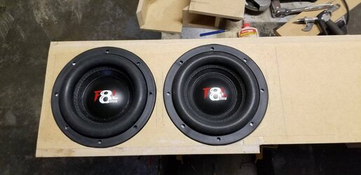

Hope you dont mind me bumpin this.. but I want to know if there is enough room for a single SA-10 in a ported box under a 2010 crew cab? I currently have 2 DC audio 8's in a ported box. They nice but I'm looking to get a bit deeper with a SQ finish. Am I off my rocker thinking a single 10 will be lower and cleaner than 2 8's? Anyone wanna build me a box? I got money lol
