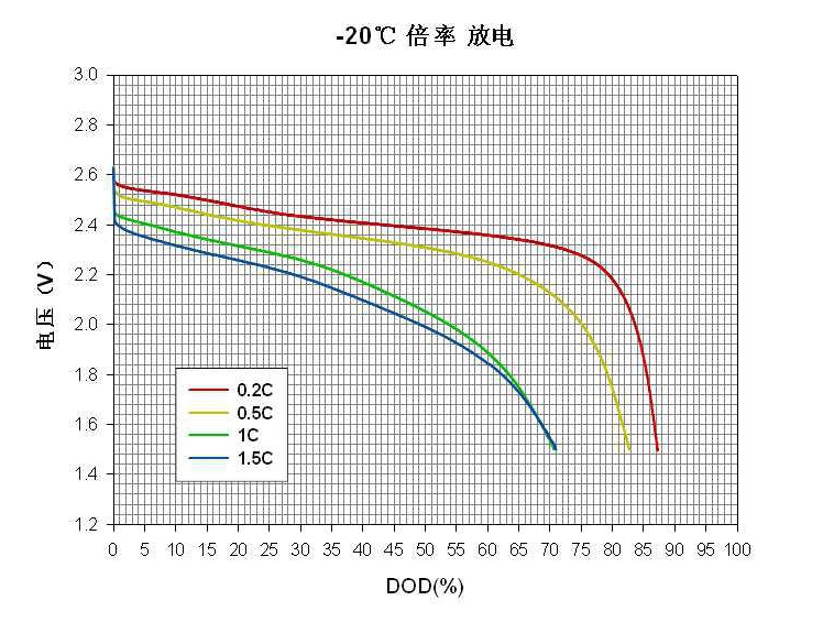

It is a great chemistry for car audio because it has huge cycle life and high discharge. As you can see here your 6S is basically starting at 14.4 if you're drawing over 1.5C

How do you read this graph? I saw a couple graphs that look very similar, with the voltage side the same, and the -20 degrees at the top, but the bottom was capacity in milliamp hours.
Good catch on the -20c. You may expect better performance at summer temperatures. Still though, this is showing the voltage the cells are going to be giving you at various states of charge.
The point being that the useful part of their operating range (99%-50% charge depth) is giving you 2.4 to 2.0V per cell or thereabouts so even if you try to 100% charge them you're not seeing more than 14.8 for very long at all as you pull energy out of them.
Ok. I think I get it. There's really not much to be gained between charging them at say 60% and 100%. At least not on a daily system. Please correct me if I'm wrong.
So them my problem is that my alternator charges currently at 14.7 volts. That's lower than 50% isn't it? If I'm assuming correctly, 15.2-15.4 would be a very nice spot to be at for LTO. So my only option is externally regulated?
