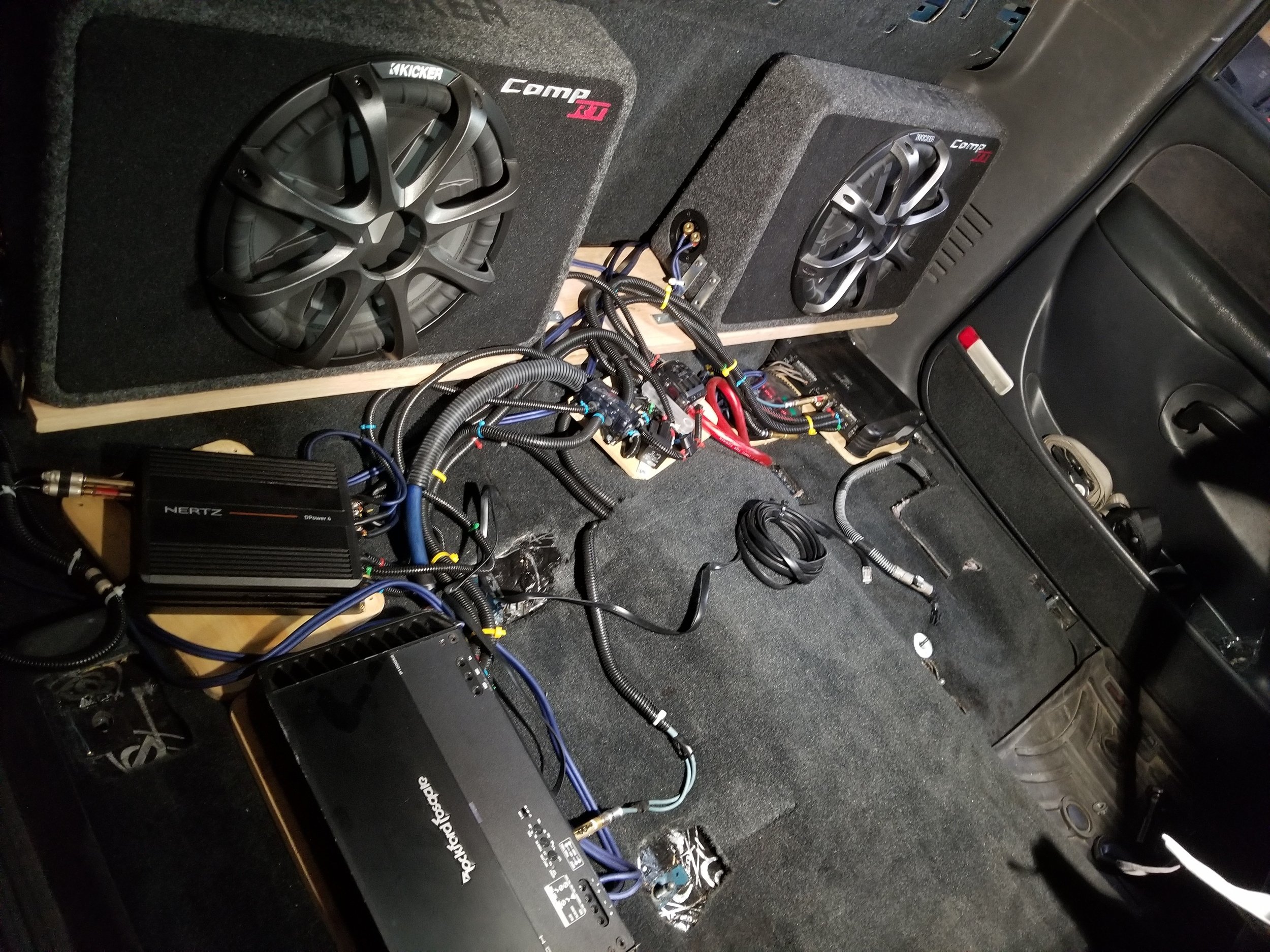

I am trying to figure out what my options are before buying anything else. I have a Silverado regular cab pickup, currently with two L7T 12" square DVC 4 ohm subs in the Kicker prefabbed boxes. (I chose these because they are the hardest hitting prefabbed that will let me put the seat ALL the way to the back. I am currently running a fosgate 1K watt amp. I chose these because the size is perfect to sit behind the seats, and the width is enough, where if I put the center seat back down, they are not visible.
I have taken some quick measurements and I believe I can fit a third enclosure back there, (will be tight, and I will either have to remove or cut the C pillar panels to make it fit). This is actually the finished product how it sits, other than I have since replaced these subs with the square ones (more power and 30% more cone area). I am currently running 3 subs with a focal 100x2 to some JL audio 4" in the C pillars, a Hertz D power 4 with 130x2 to a set of JL audio ZR 650 components in the door, and the 2 L7t 600w RMS 12" Kicker subs powered by a Fosgate P1000x2 amp, (that sits completely under the seat, and will cut out from overheating when its about 108+ degrees out with the windows down, after about an hour at full). It might not look good in the picture, but that's fully installed, and completely hidden when the seats are installed. (That junk in the middle is a board with the two distribution blocks, a relay and a busbar to wire the remote wires). It's decently loud and hits well, considering I wasn't going to compromise on the seats or my leg room.
