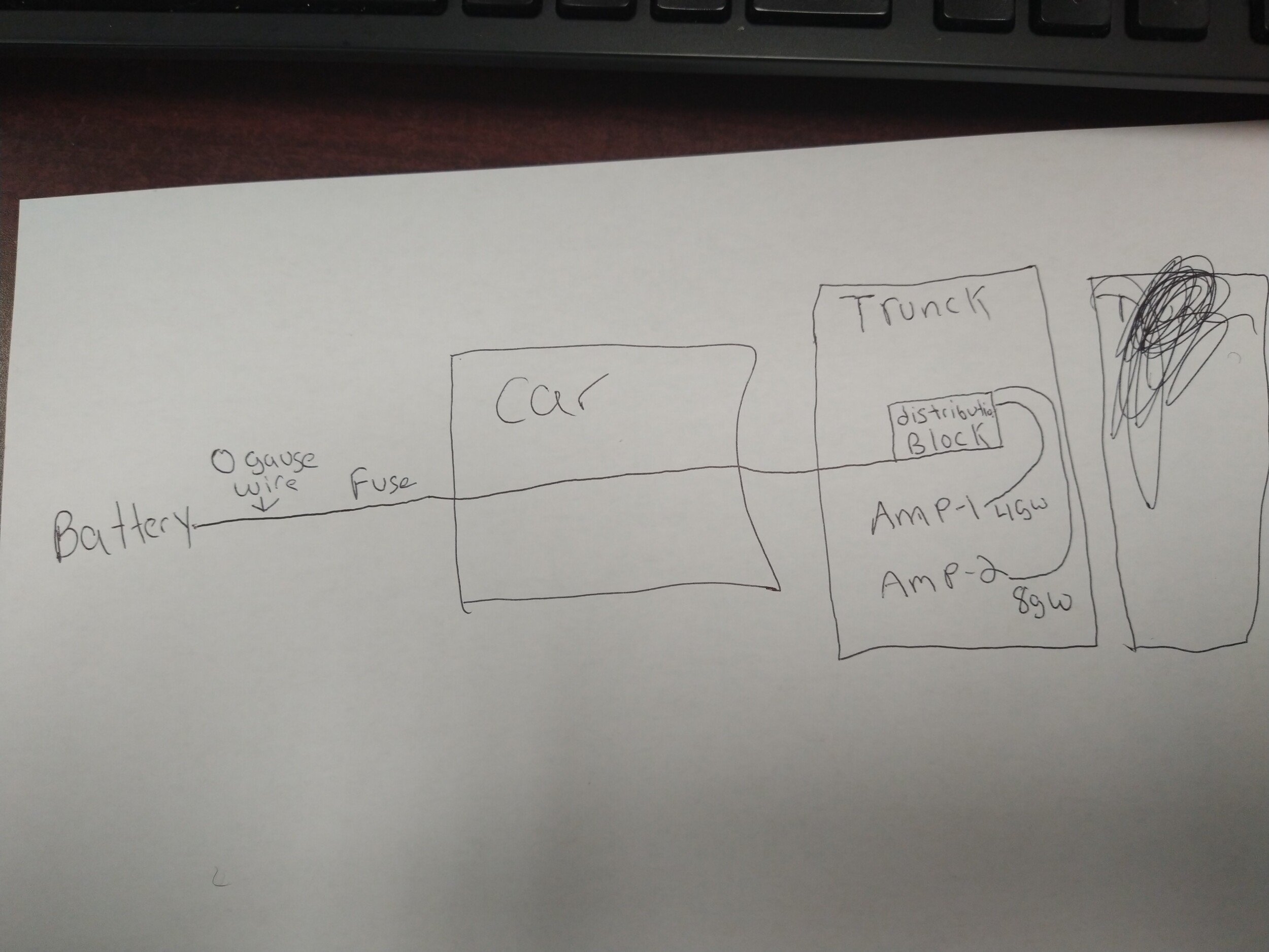

It's going to look like this
It's going to look like thisView attachment 41490
This looks correct you could use 4awg to the smaller amp if you have extra. Going bigger won't hurt.
Just don't fuse 8awg over 60amp for real full sized ofc. This is what skar calls for on the RP 75.4
