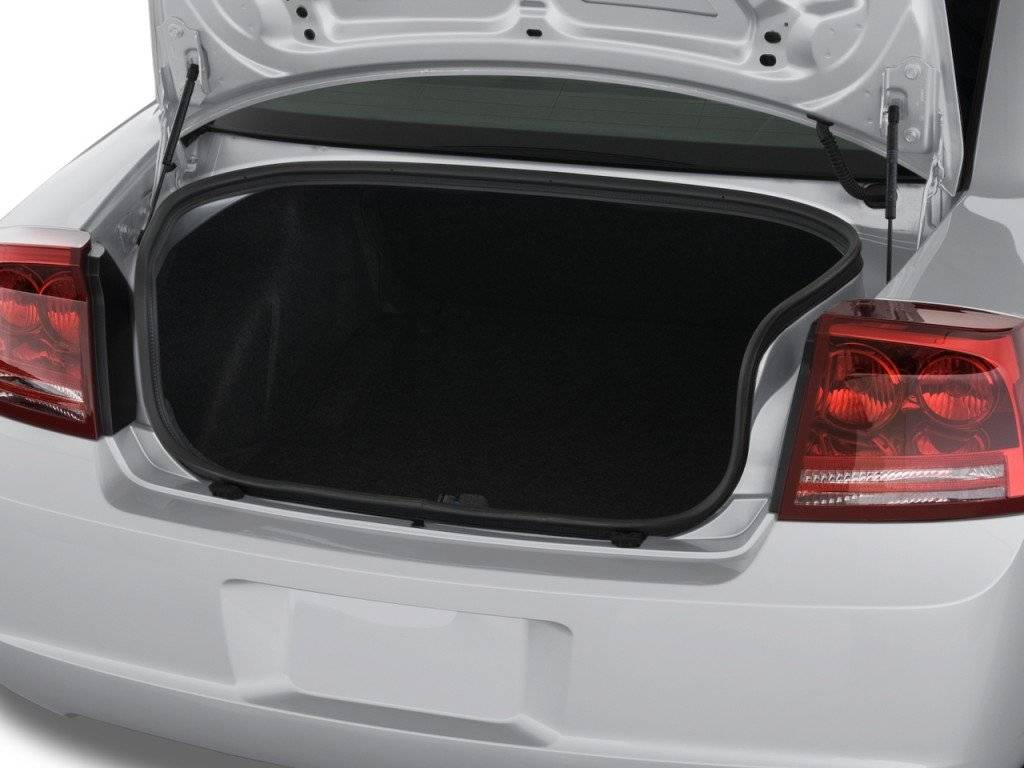

doesnt look easy to fit in the trunk. I believe I have the same trunk as you with a 2007 charger. I went with (2) 12s a good 270amp alternator and a lot of power becaues I could barely fit one 15 in the trunk with like 5.5 cu after displacement but that box got stuck going in the trunk so I had to use the router to take off all outside edges to 45s and a wood rasp to wear off more material in certain places to wedge it in the trunk. dont forget to take your weatherstripping off the trunk before wedging your box in so you dont tear it up.
I would try for (2) 12s or (1) 18 unless you want an undersized dual 15 box. My next box will be for (1) 18 it might be a little undersized but Ill make up for it in power. going to try to upfire from the back of the trunk and port forward into car with seats down.

Calibers are hatches, by the way. I doubt they have the same "trunk" as your Charger.
