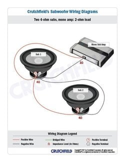

hers how hope it helps

You will only use one terminal set on the box.
That won't work. It's a dual chamber box.
Ian you just need to run some ~14 awg wire from each sub to the box terminal. The easiest way would be to use some standard quick disconnect terminals, probably the blue ones (14-16 awg). You will have to find the correct tab size. I think your (+)'s will be .250" and the (-)'s will be .187. These can be found at walmart, but the .187's might be a little harder to find.
For amp to box - you can either run two +/- pairs from the amp for each terminal, or run one wire then a wire from one box terminal to the next.
The amp and box terminals will both work with bare wire.
