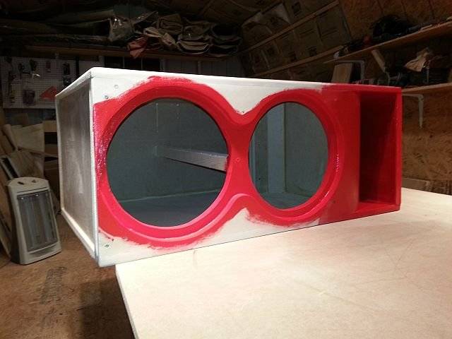

Enclosure: SMS 4 cubes tuned to 33Hz, red kerf port, flush mount

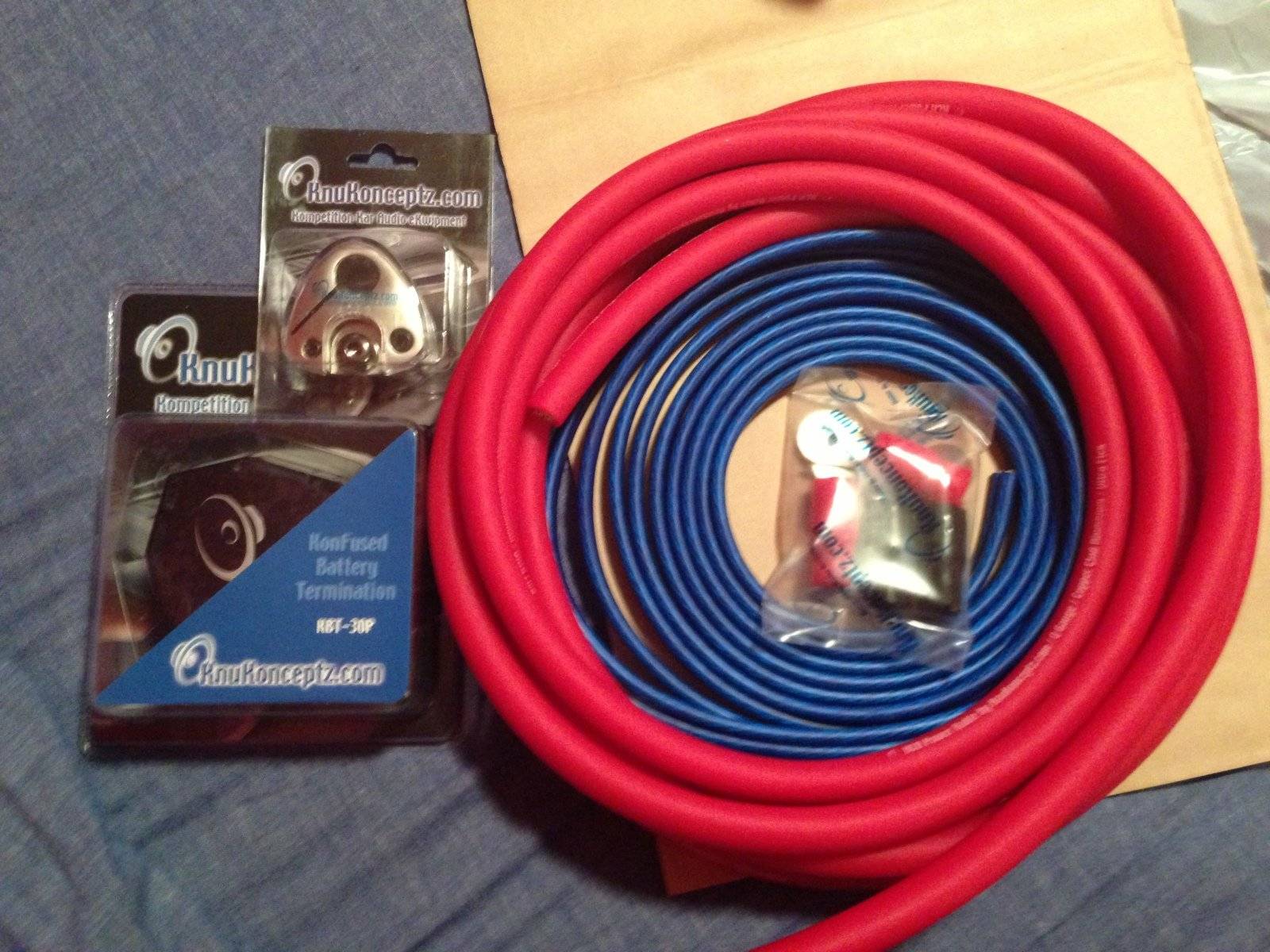

Electrical: Stock alt (mechman 240a being ordered as we speak), wet cell battery (Duracell AGM from Sam's going in within the next month), KnuKonceptz KCA big 3, one run of KCA 1/0, one run of Kolossus 8ga

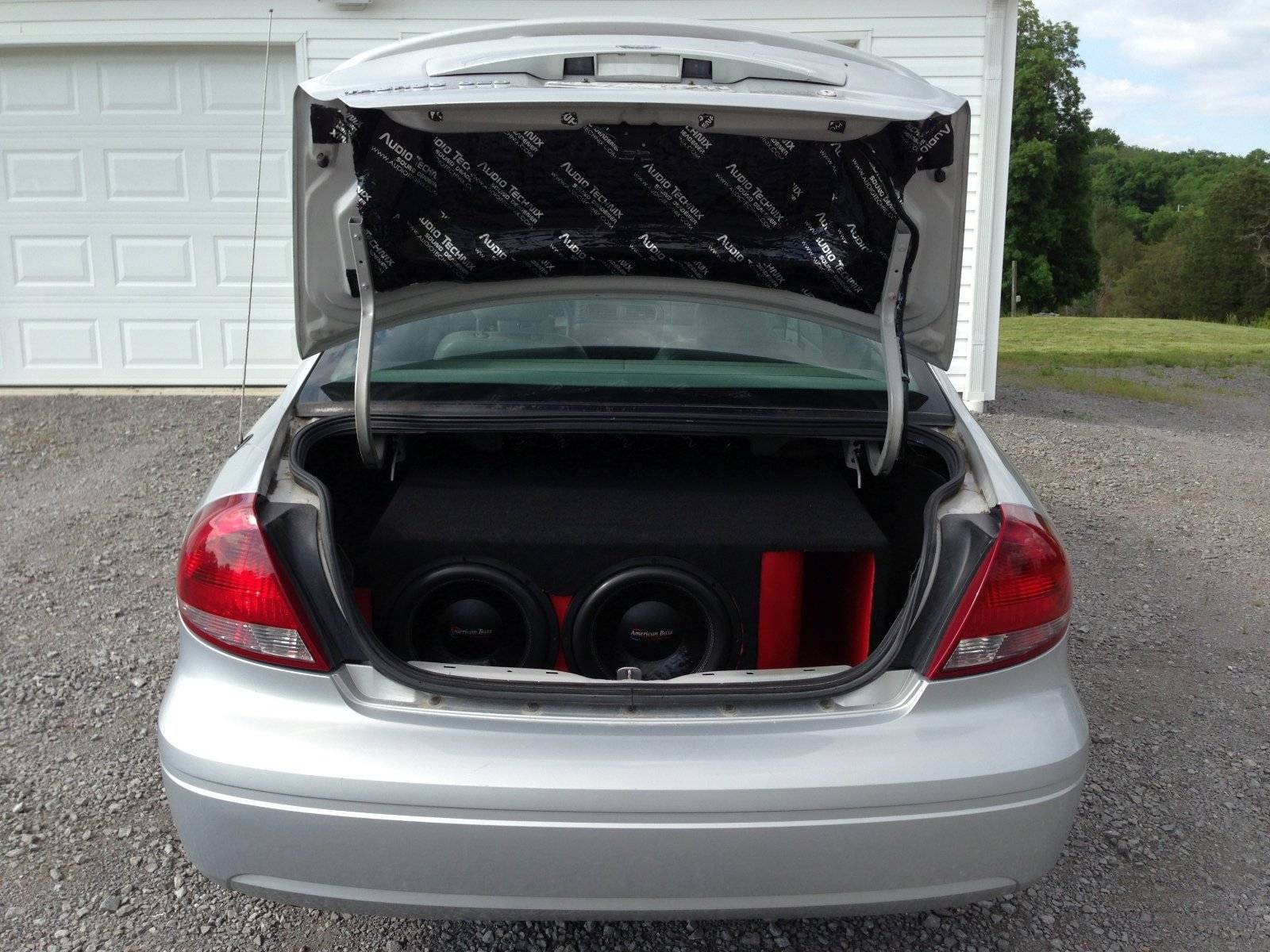

First: pictures of the car (back end is weighed down pretty good.... lol)

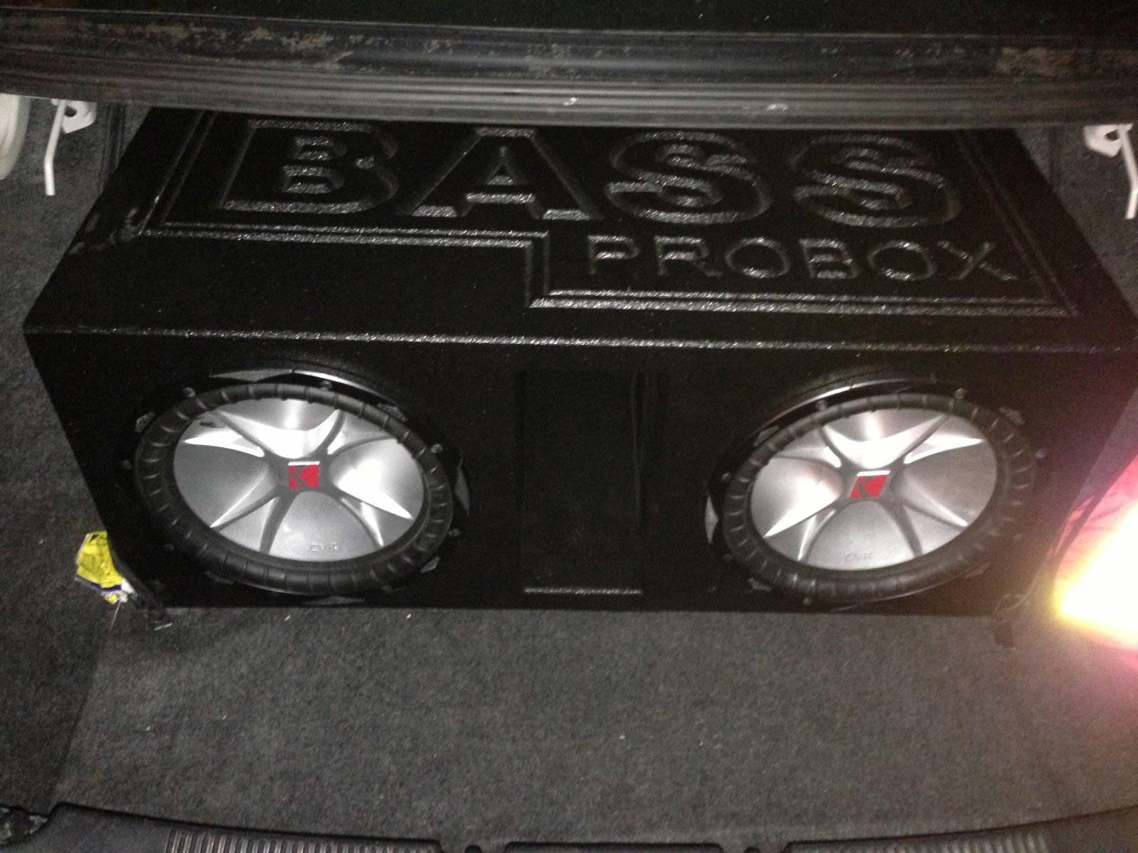

Kicker CVR 12s in a probox (hit hard for what it was, but tuned too high)

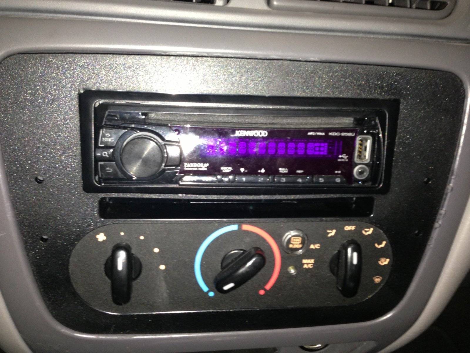

Kenwood KDC252u in a Scosche Dash kit

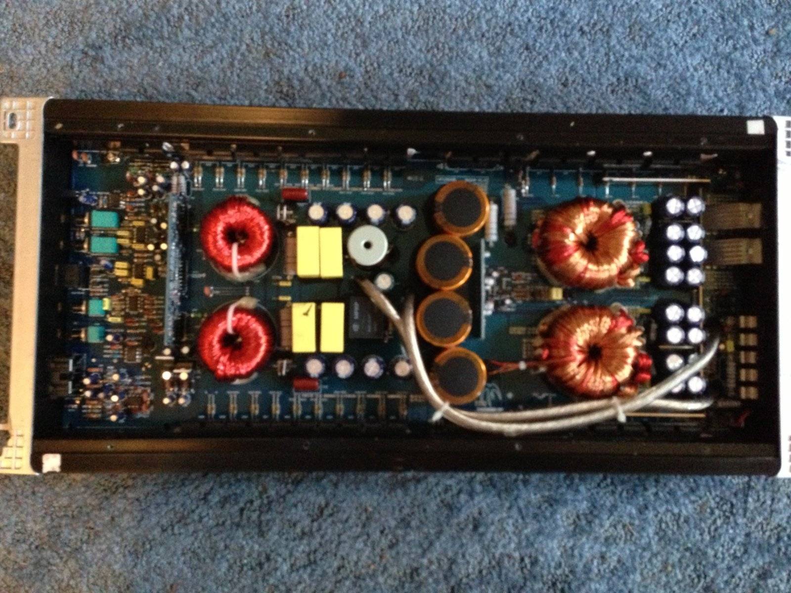

HFi 2500d guts
And the electrical upgrade began

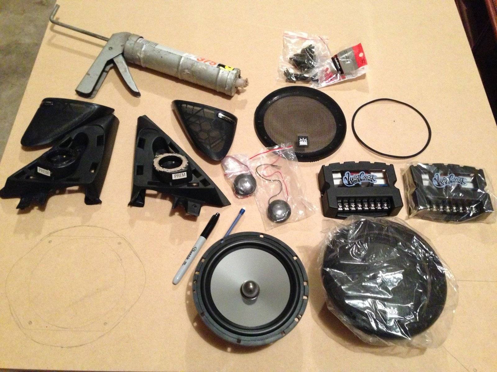

Decided my front stage was lacking, added component set, amp, and false floor

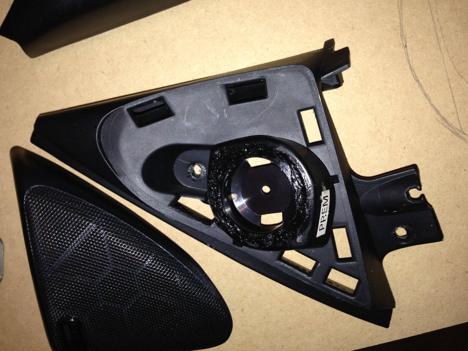

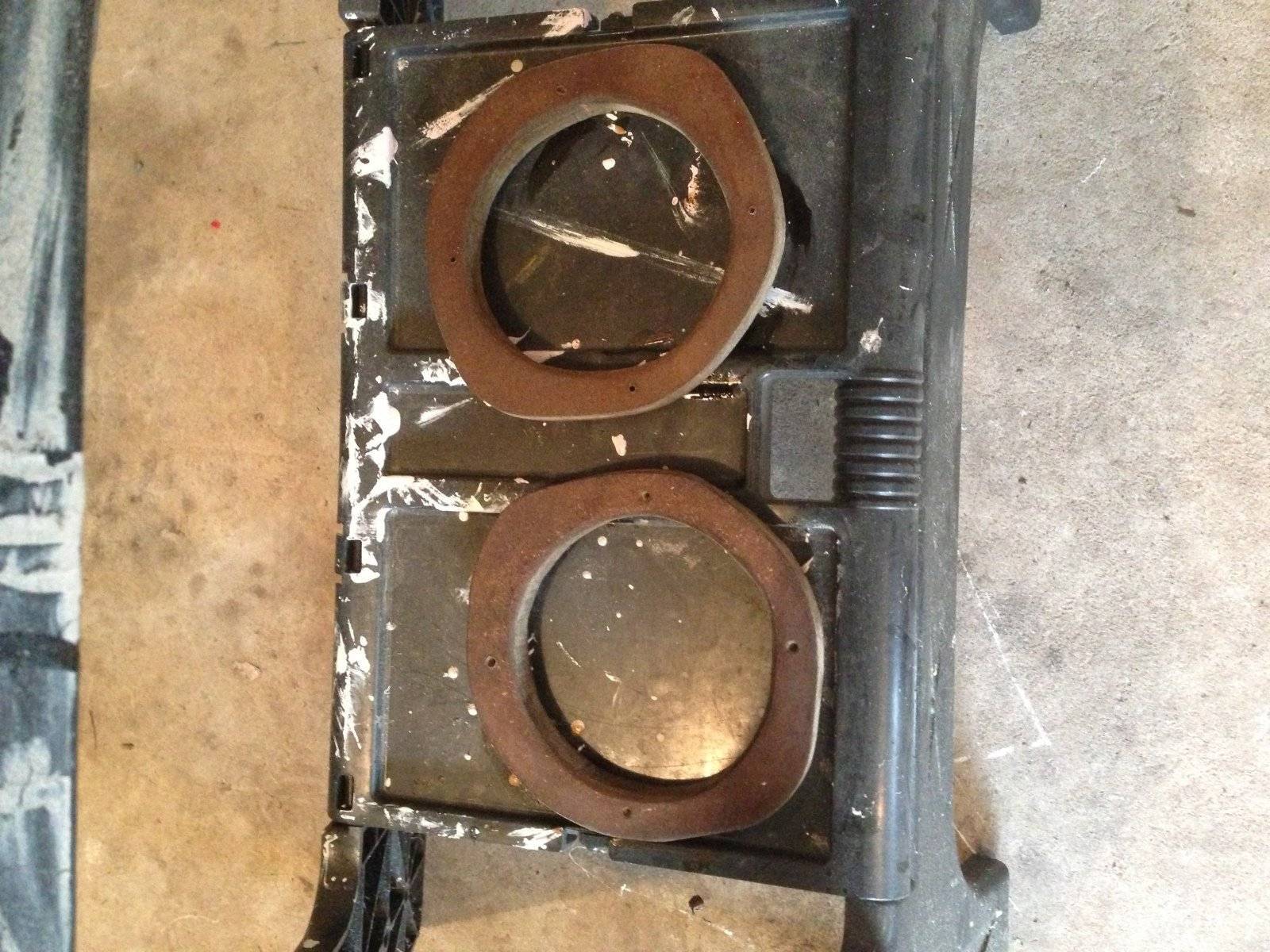

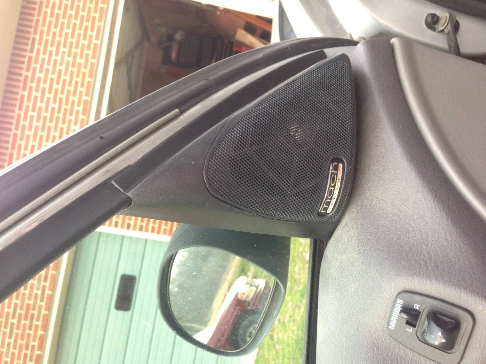

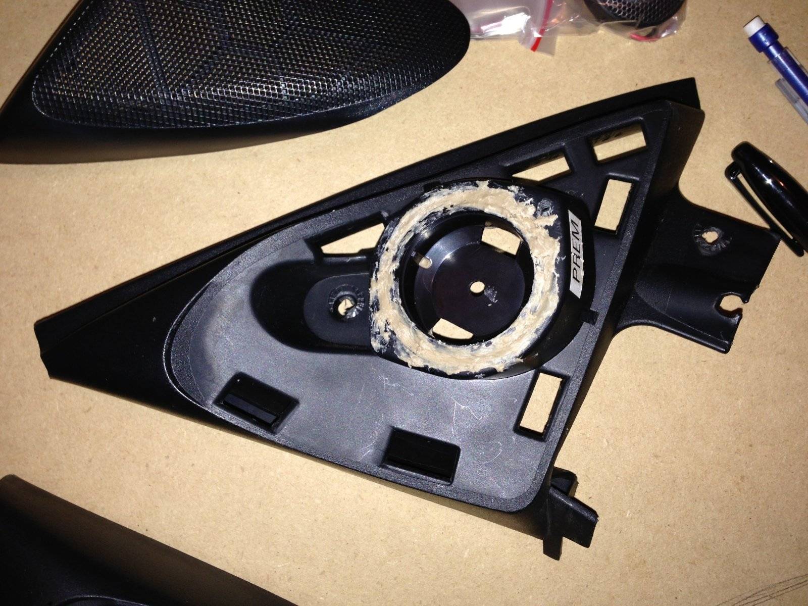

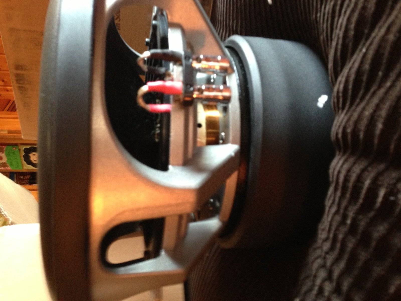

"fabricated" aftermarket tweeters into stock tweeter location
6x8 to 6.5 adapters
Installed tweeters

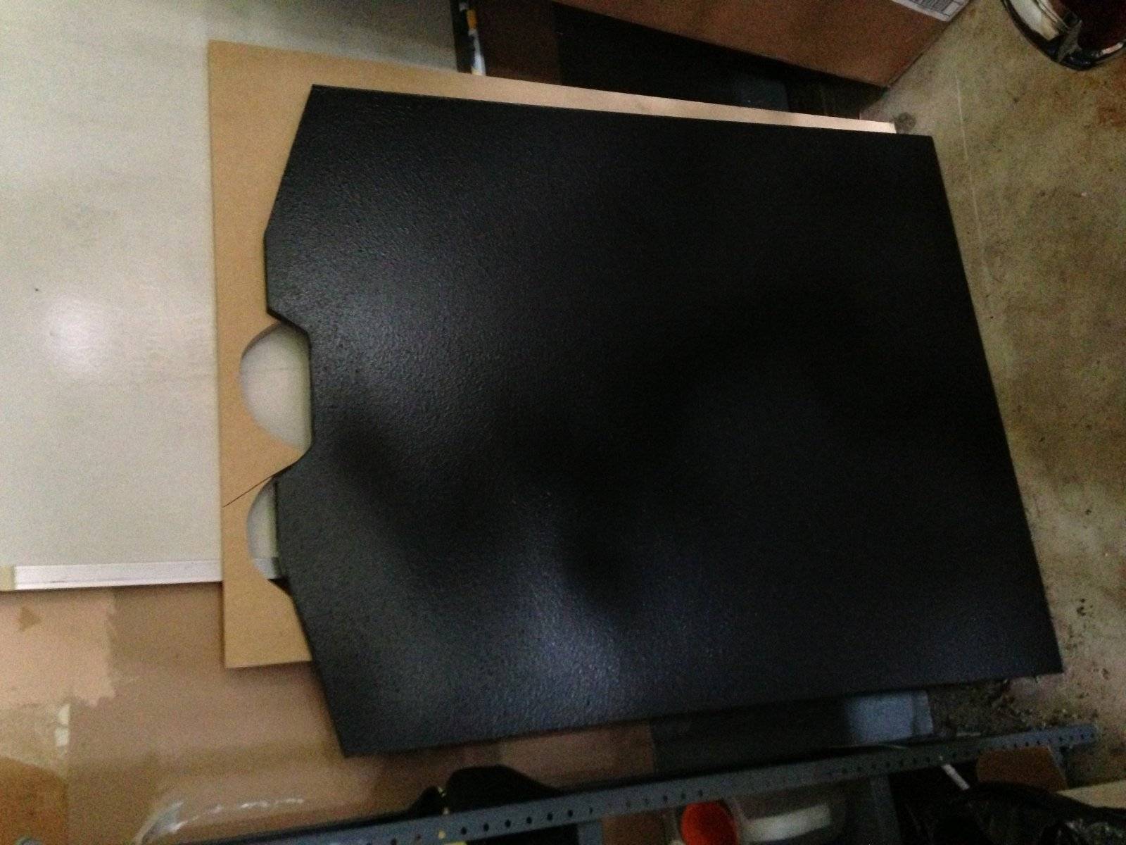

False floor begins

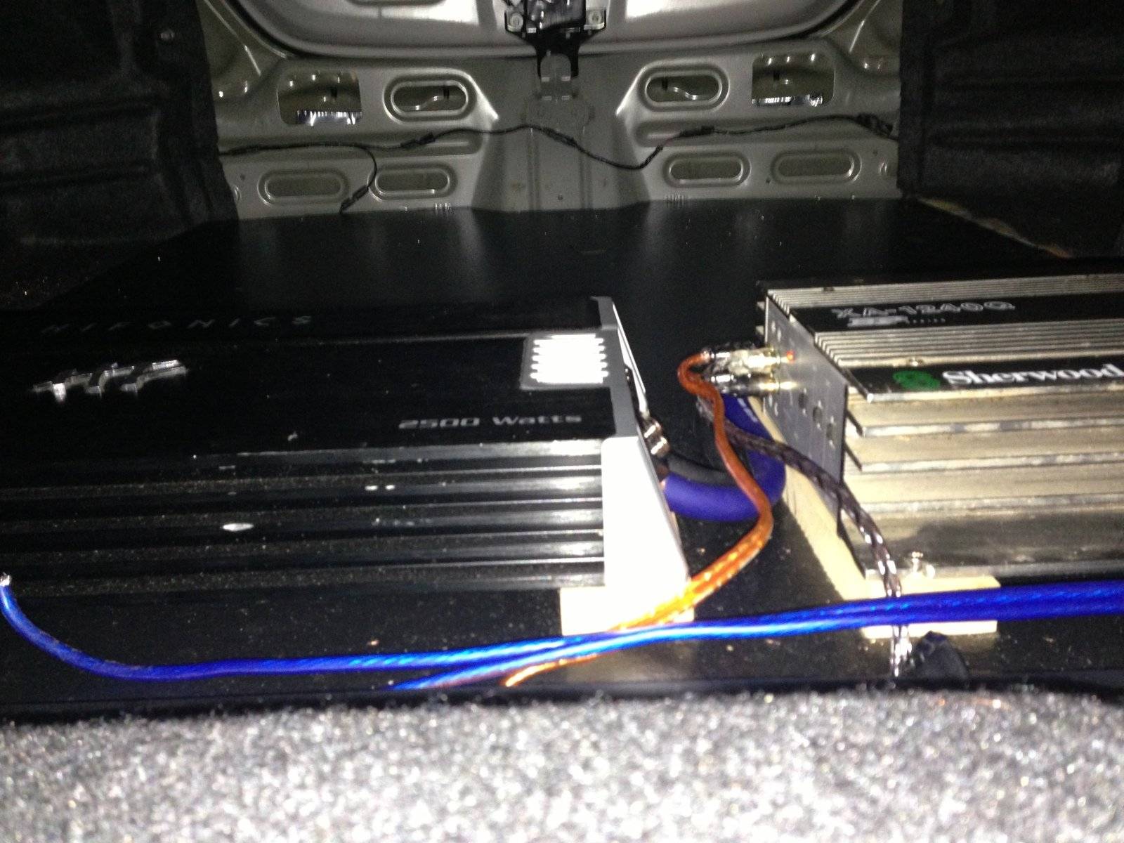

Floor and amps go back in

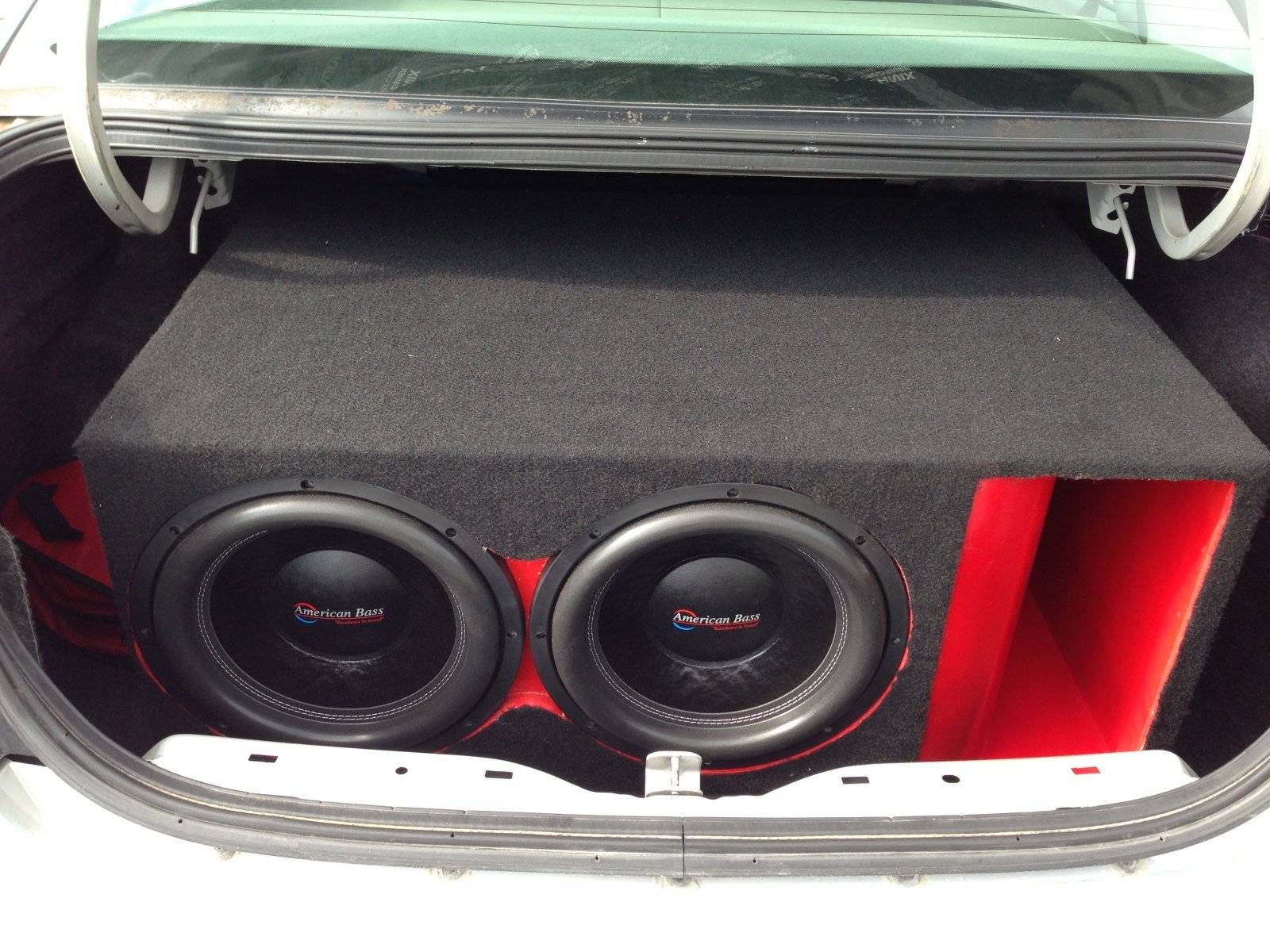

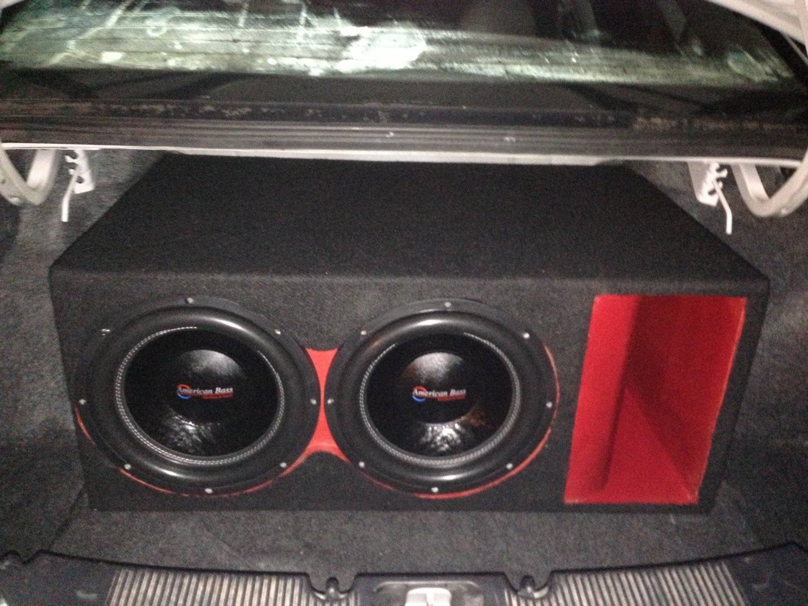

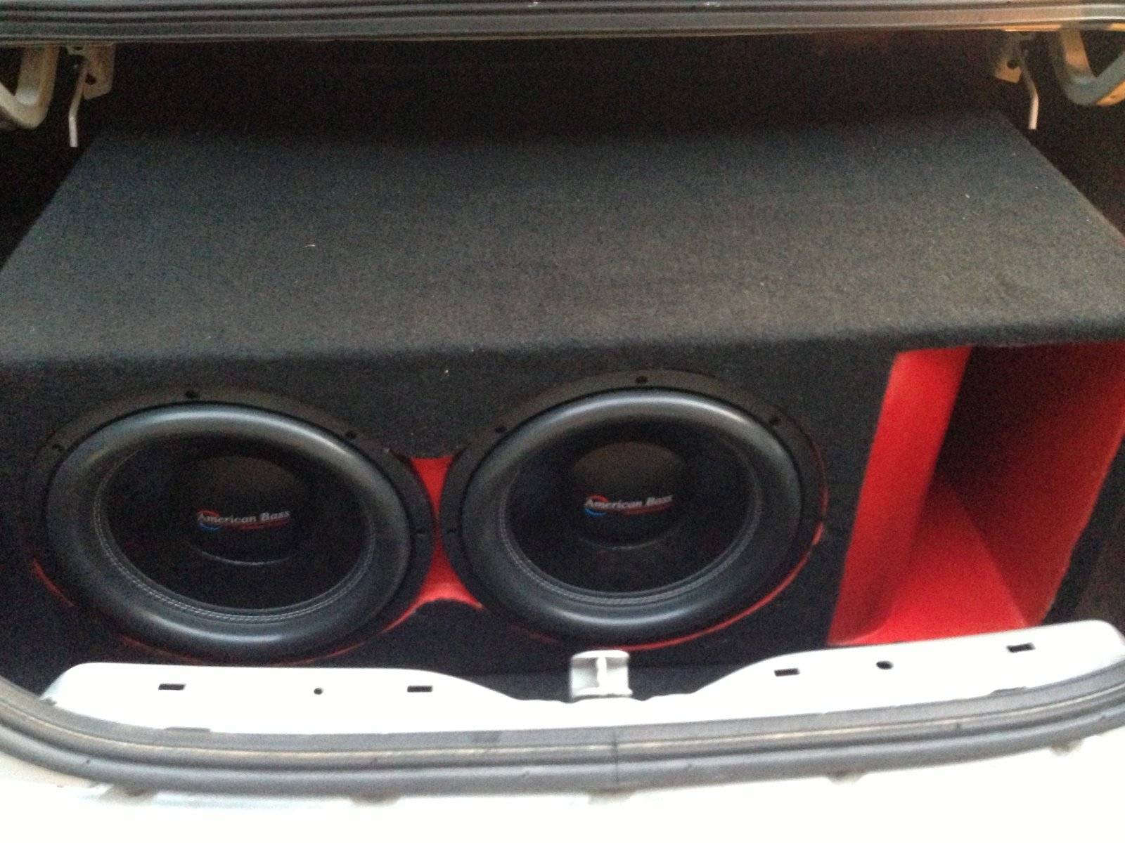

Box goes in

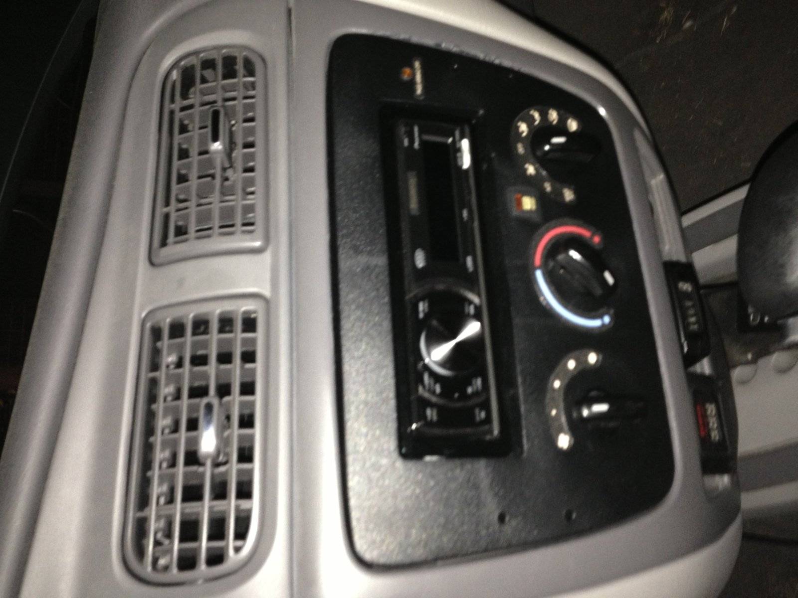

To accommodate the extra amp, new head unit goes in

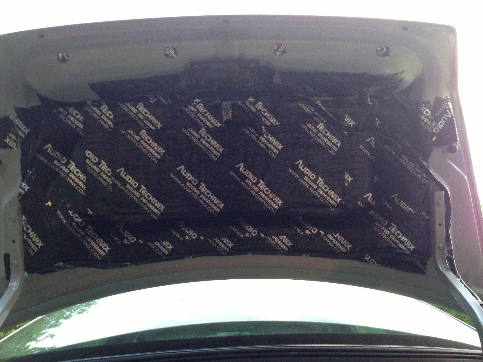

Sound deadening begins
Scooted box further back, it is audibly louder

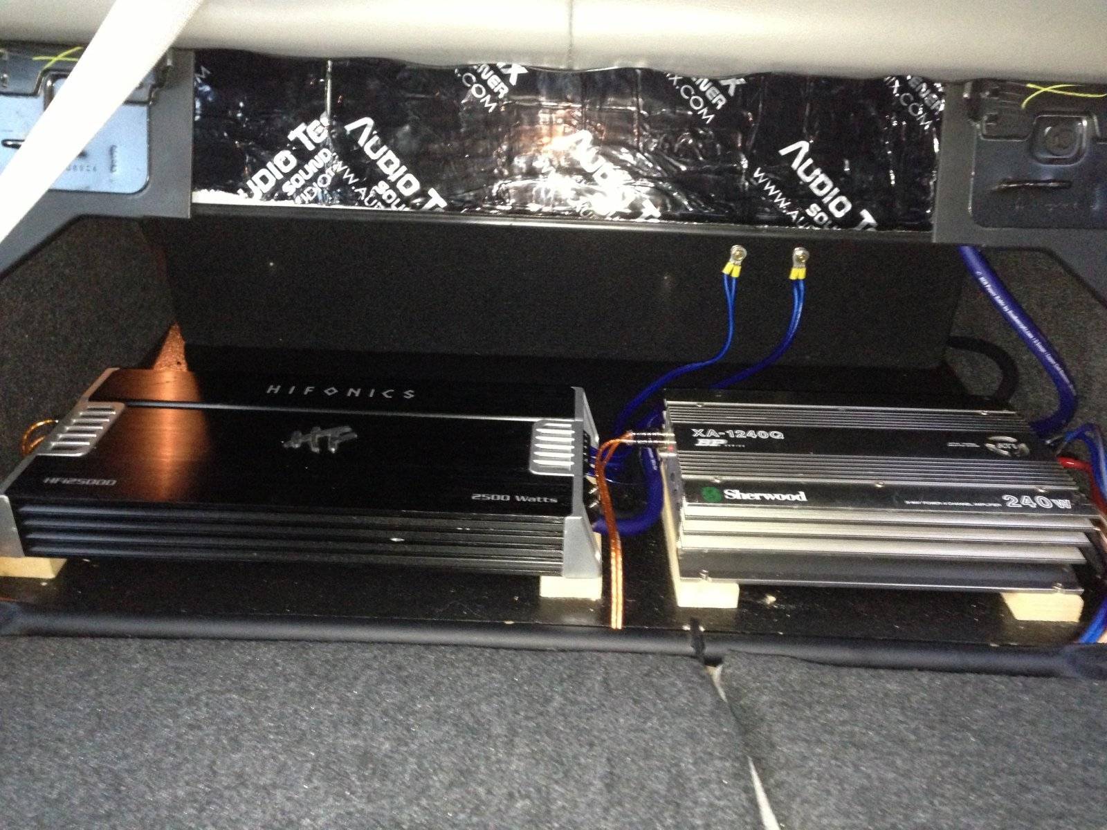

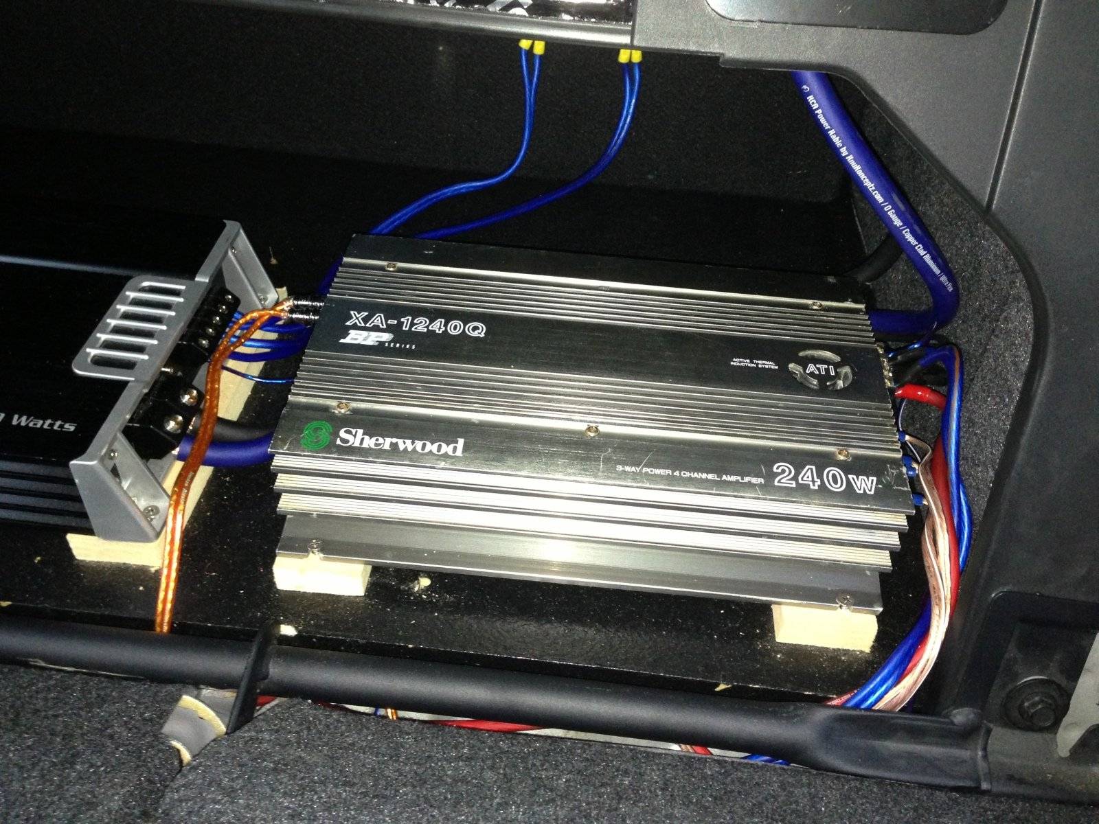

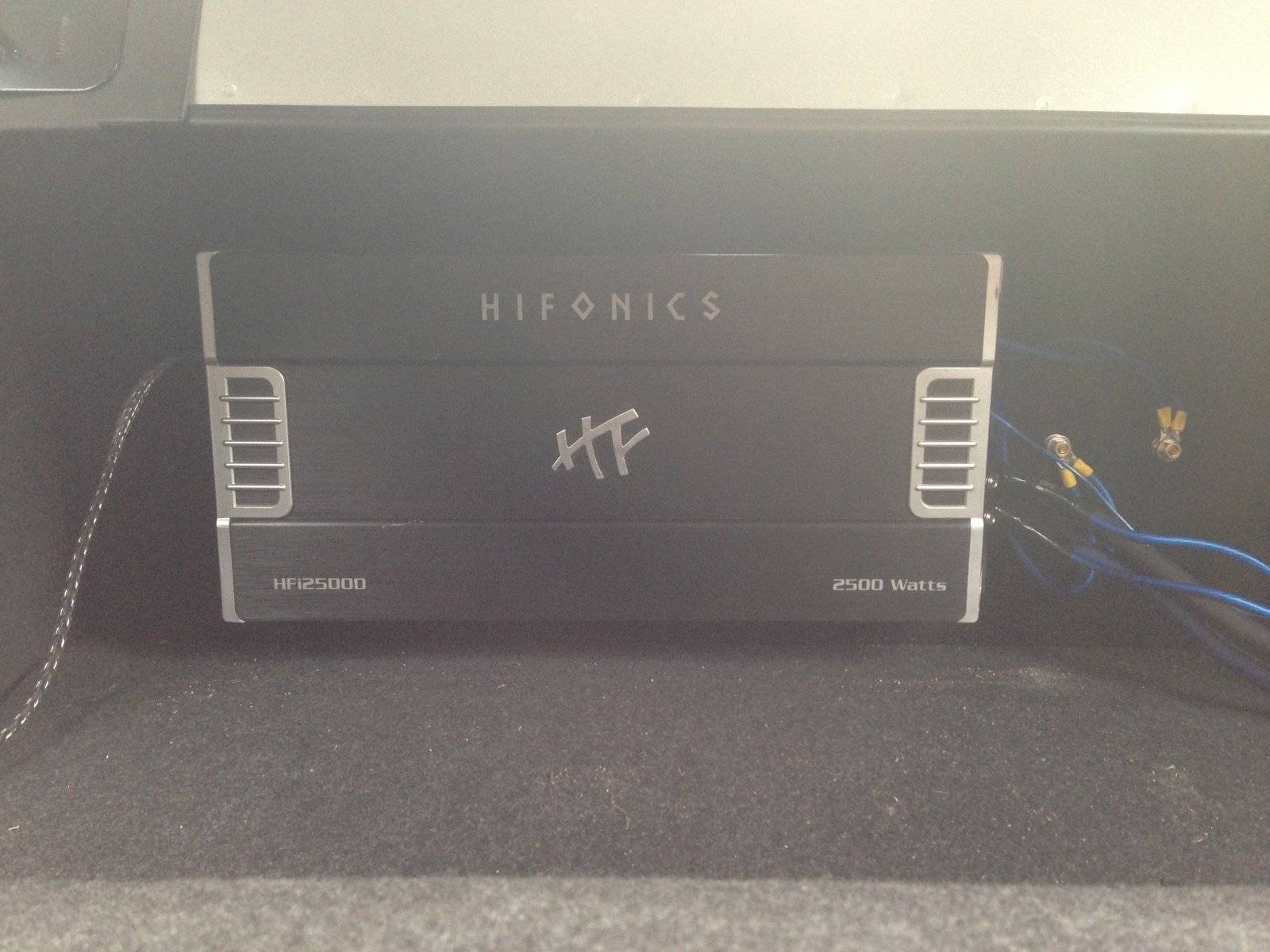

More amp mounting pics (may paint the MDF under amps black in the future)

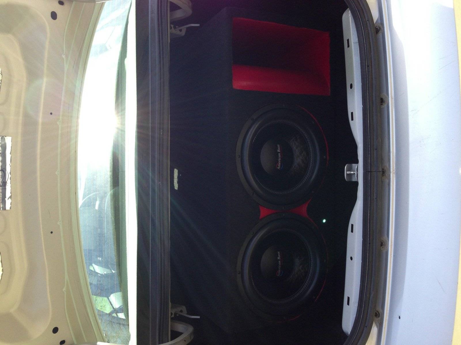

Current appearance:

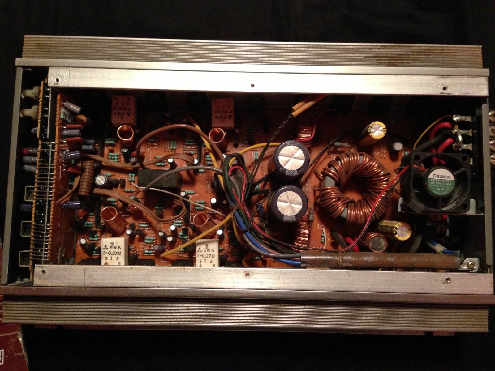

Also somehow I missed this picture, but internals of the sherwood amp:
