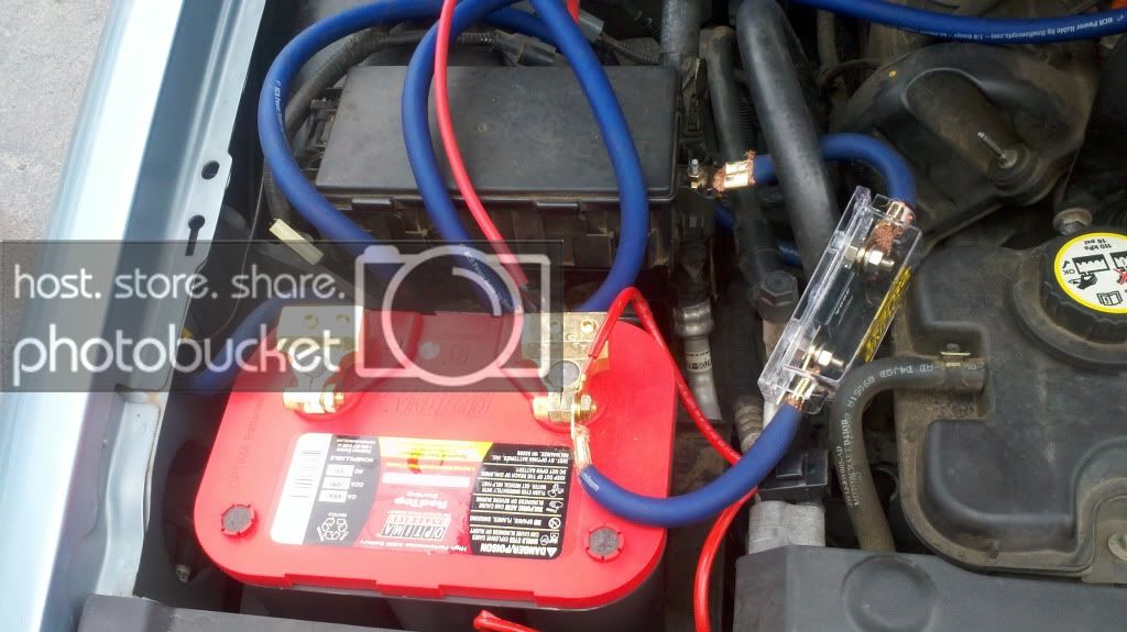

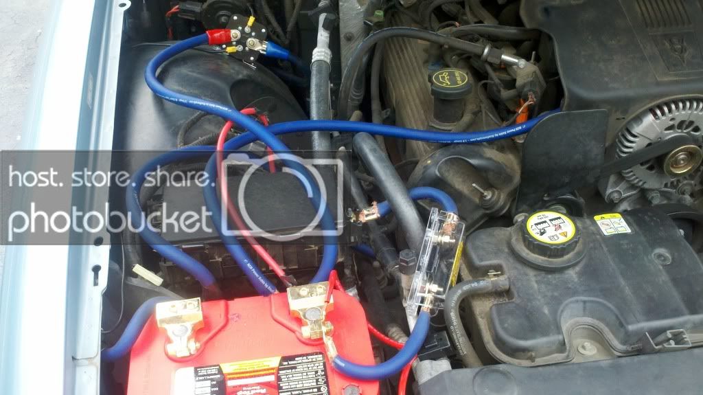

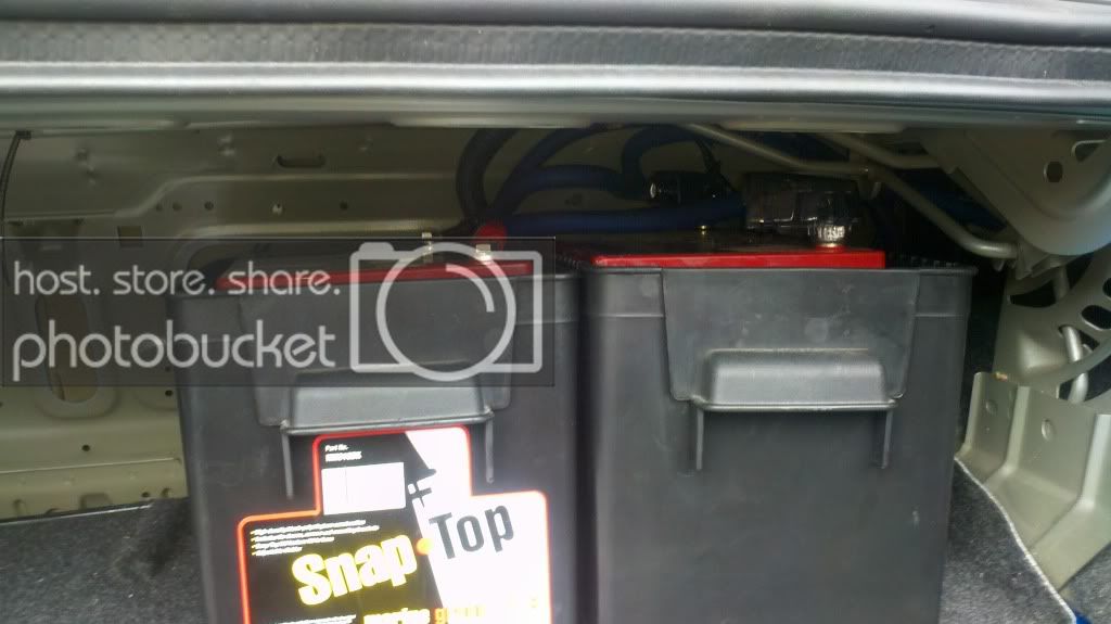

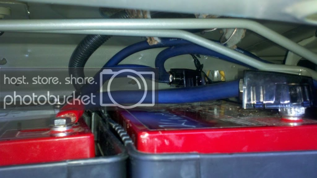

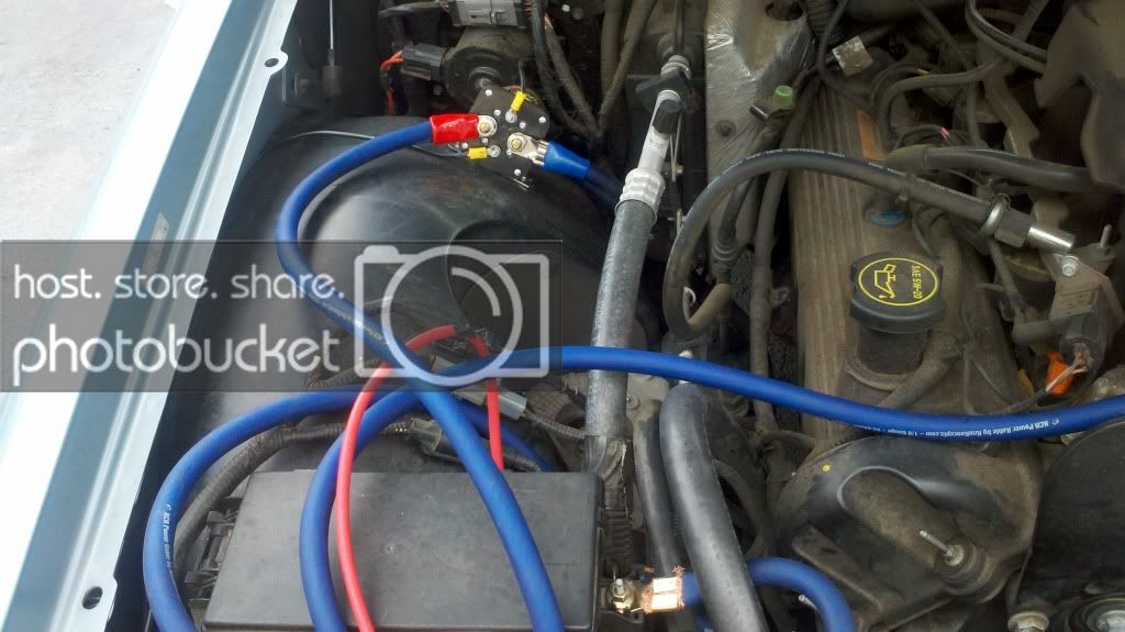

finally got around to redoing my big 3 today. no im all wired up from the front end to the rear. no i just have to wire in my batteries in the trunk i will post pics of progress later.
yea i know i need a to build a box for my batteries. but i like these boxes just makes it easier to remove if i need to. but here is the progress ive made so far rebuilding my system. amps should be back one day this week and i can get those installed and do a video

Does anyone have info on doing the big 3 on these cars? I am gonna attempt it once it gets above 20 degrees here some day soon. How much 1/0 do I need to complete it on these? Thanks.
Looking good did u take the seats out and find the ground spot?
no not yet i just used the same ground as your temp spot for now. tested everything with a DMM and im getting good voltage. but im gonna probably change it to the seat ground when i get some more time off.
thanks dude for the info this should make it easier for me now. as far as the big three goes fairly simple. all i did was remove one wire at a time and replaced it with 0 gauge. as for how much u need i would get more than enough. i bought 100 feet of knu 0 gauge some good shyt.
