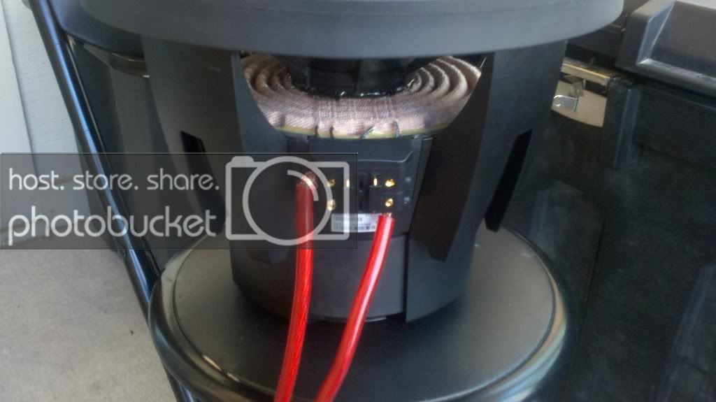

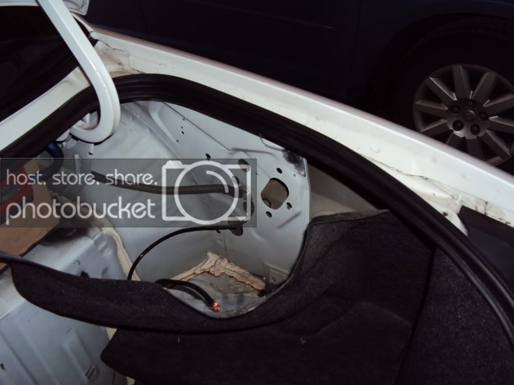

ok my first problem the dude who built my box did me the honors of installing some cheap *** speaker wire. anyway im upgrading it to 4 gauge heres a before pic of the speaker wire the pic is small but you can see what the old wire looked like
and this is a pic of the upgrade to 4 gauge wire sweet!!!

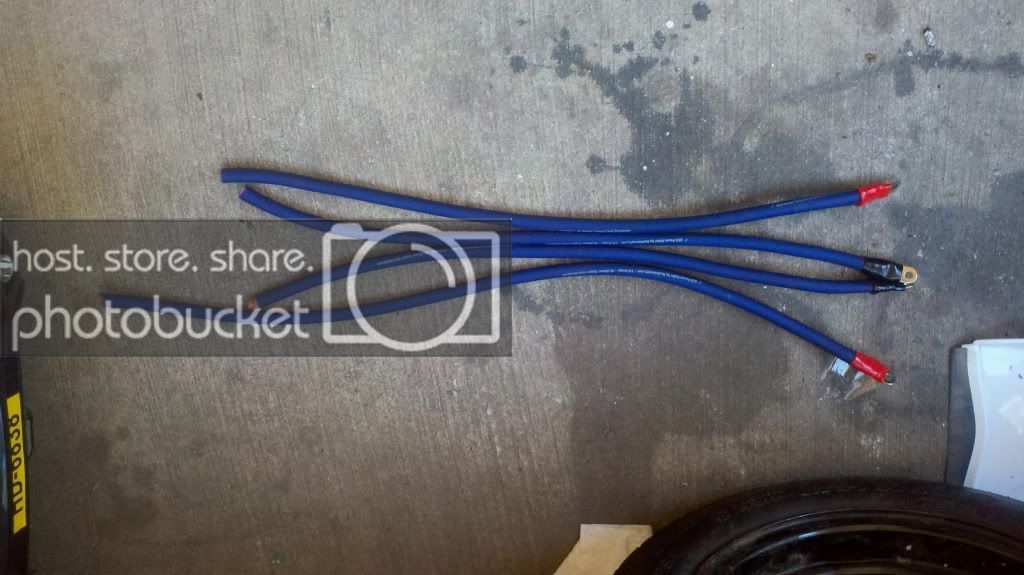

here is a pic of my old big three upgrade done in 4 gauge (dont criticize please thats all i had)

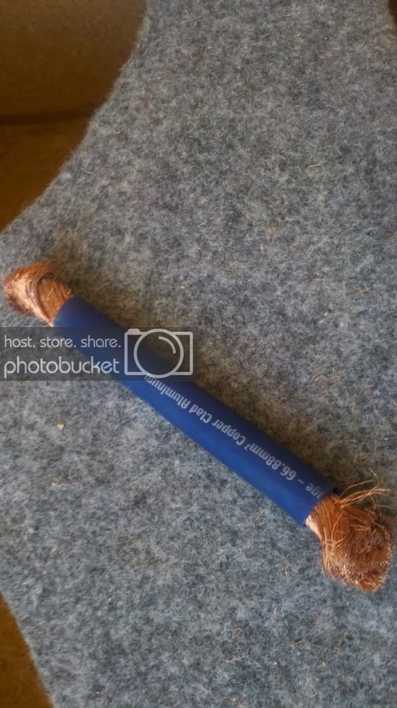

and here is the knuknoceptz 0 gauge wire i will be upgrading it to (this is some good shiiiiiii)

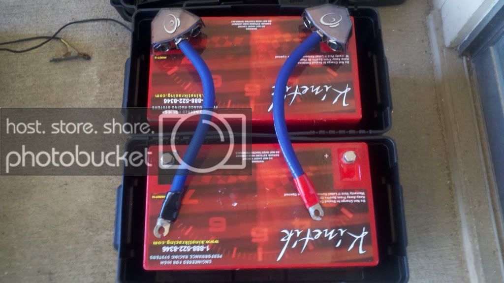

and as you can see on this pic i had my batteries ran parallel but wayyyy to far apart
here is how the batteries will look onced installed (much better)

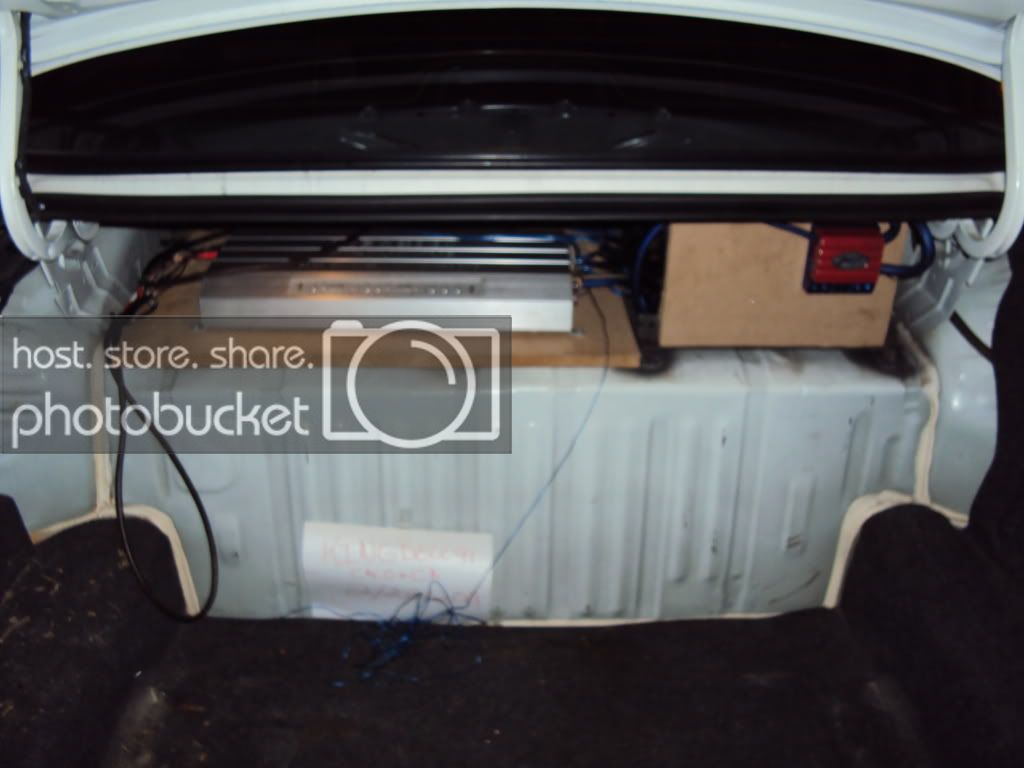

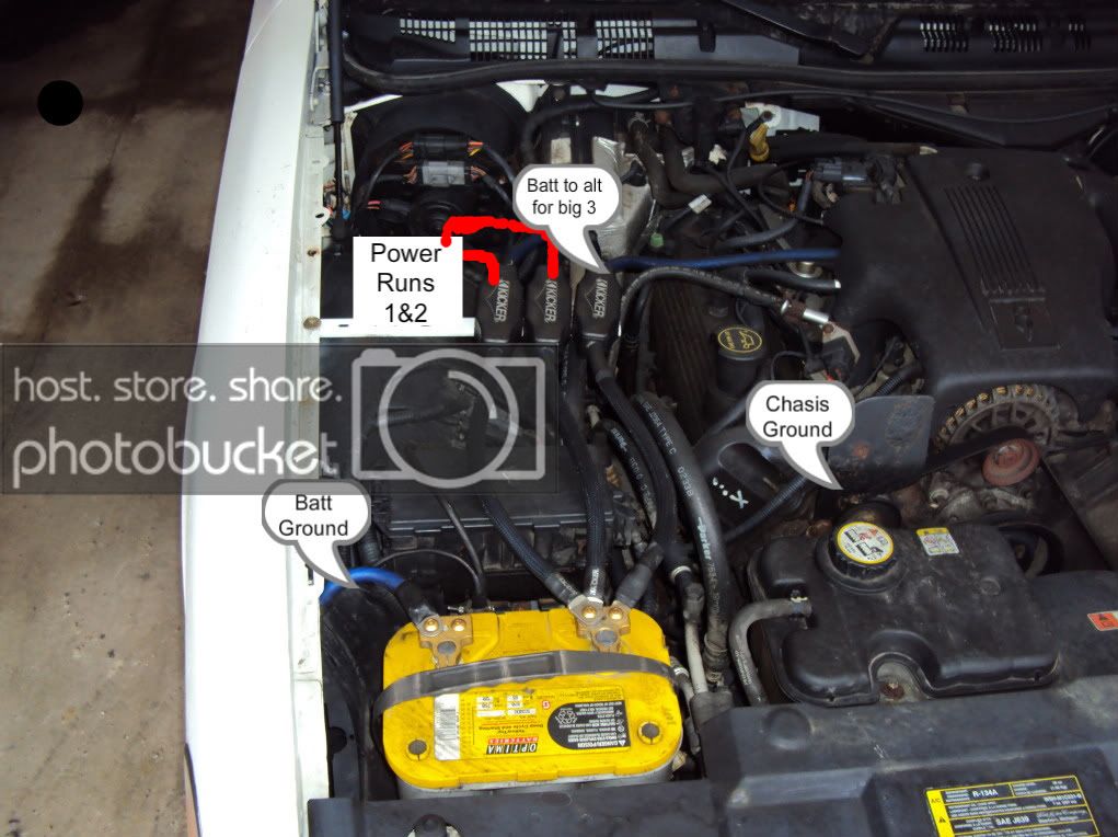

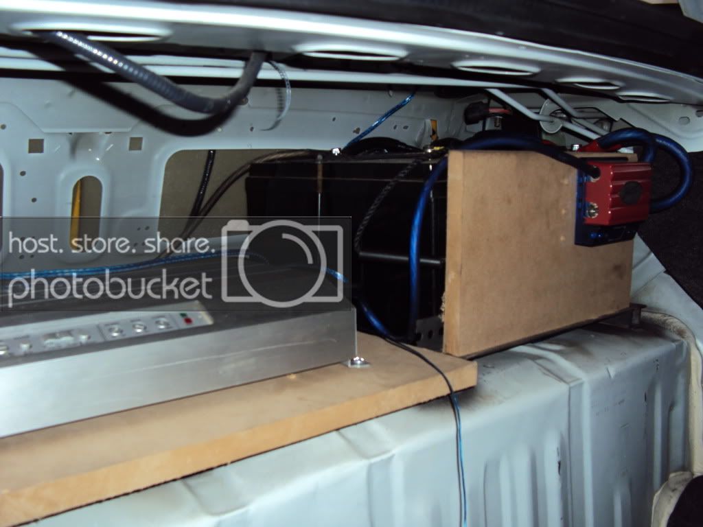

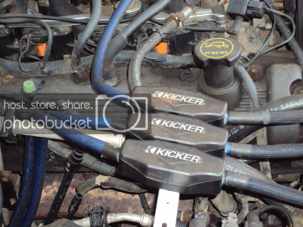

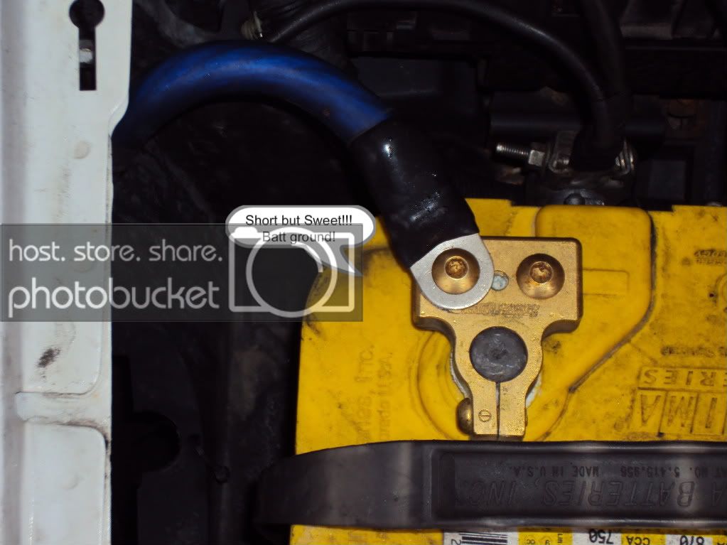

for some reason my post are not showing up!!! But here are pics let me know if you have questions! Think i might do 1 or 2 more runs!
everything looks good man. Thanks for the pic. Mine is done exactly the same way i just have to upgrade to the 0 gauge wire instead of the 4 gauge that i used before. Anyway how is your batts grounded in the trunk
Thought i could get in there to show everything but could not lol i have to remove rear seats to show everything which i cant do right now!

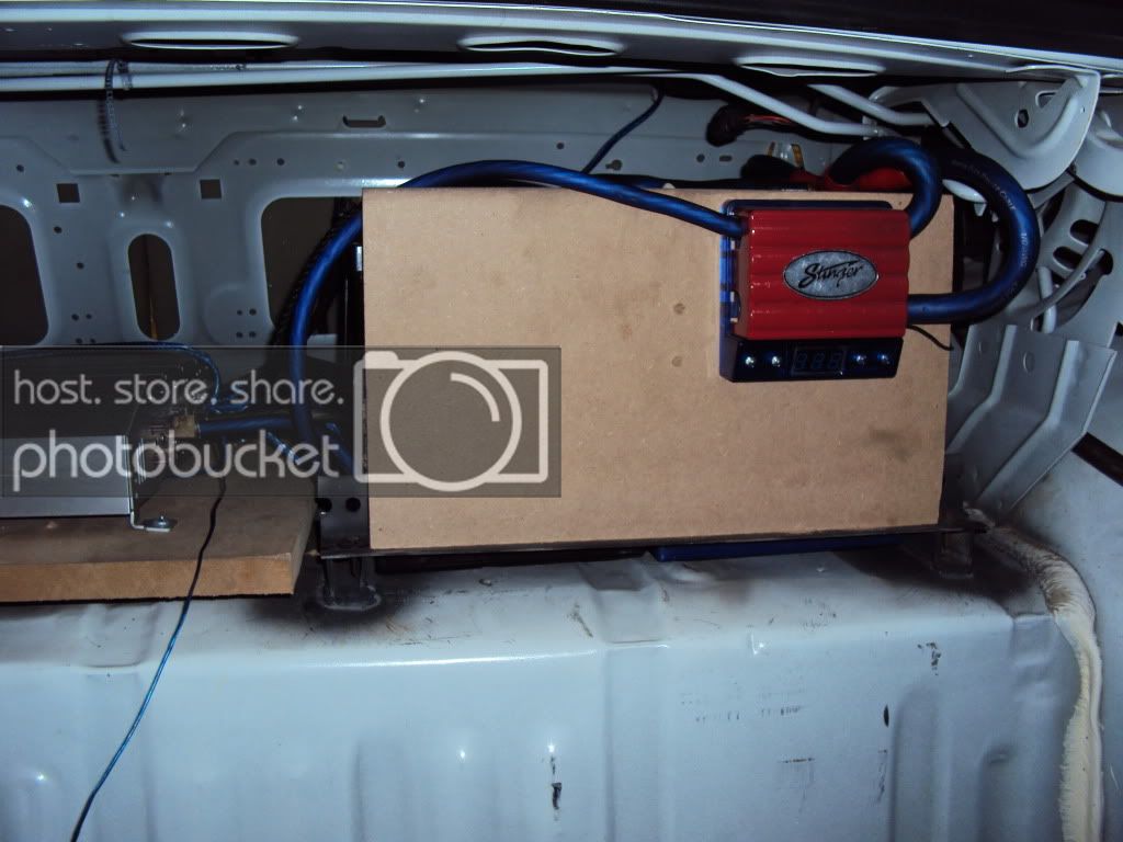

everything welded down with steal and i drilled the wood into the steal.
there are 2 HC 2400s behind that MDF
if you put your batts up where mines are and remove your back seat u can ground to the seat bolt its connected to the Chassis How much deadner did u use for the trunk?

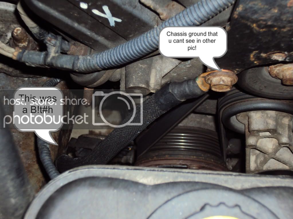

dude i have to say that you are doing one hell of a job!!!! man thats looking good. im gonna put my 2400s in the same place you got urs mounted. now my next question is how hard was it for you to remove your rear seats? and the temp ground that you have is it a good ground spot? also great pics man. i see on your big three, the engine to chasis ground, was that the stock ground point? because on my merc its different. its connected to my engine at the same point but it doesnt go to the chasis it goes to the negative battery terminal. then i have the regular batt. negative in the same spot as urs. im going to take some pics tomorrow to show you cause i might be confusing you a little.
LOL the rear seats a few bolts and it was out have to remove the whole think the back end and the seat part!
well that ground i have now is OK but like i said it will be changed to seat bolts which are connected to the Chassis!
With the Batts do not drill cause the gas tank is right there all that stuff is Bolted down to steal Bars which a welded to the sheet metal on that rear deck!
As far as that BIG 3 ground i made that my Self and it was a pure B!t#h to bolt Down, u don't have to =bolt the other end where the factory is. but what u cant see in that pic i also still have all my Factory wires in in addition to my own
