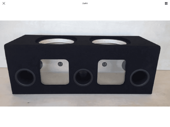

the 2 hcca’s  are brand new 2018  blackseries.   2 +2 ohm              not sure if i should go sealed or ported  all i know is Face up is the way they say it should be built..     i saw  a box online  ebay i think   it has 2 plexi glass openings so you can see the face up subs magnets  which is pretty nice...    im just not willing to spend 250 on wood box   i can make .    anyone have plans ..        also i think sealed box would work better  just not sure what to do..      my subs are sitting in storage for months because im not sure the way to go..    any help   also this box is to wide by 3 inches F9DFE6F1-B780-44B9-9362-5D8BA61E8013.png

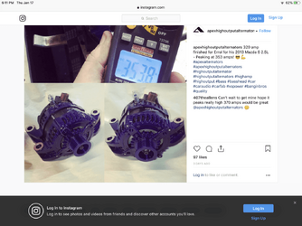

lol  your funny   i have a high output alternator   actual one is pictured here , 4 batteries  , i dont need to tell you these details  ..     im just looking to build a box   and got a lecture about sealed isnt good..lmao           forget i asked you guys..  i know now never to ask for help here again..    its fine with me i got my box designs through email direct from orion audio... see ya later      and its a adjustable box.    sealed and ported

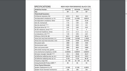

do you even know what TS specs are? I doubt you know a single thing about woofers and how they are designed and how TS parameters affect what kind of enclosure they need or what kind of performance etc.. moving mass, motorforce, compliance etc... Any basic understanding would tell you this is a ported only woofer with an Efficiency Bandwidth Product of 64 means its a ported or 6th order oriented woofer. I doubt you know what EBP is so idk why im even explaining this to you

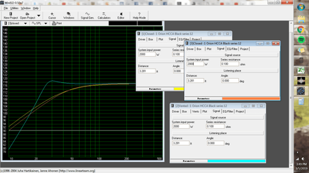

you literally are blind to facts and dont understand a single thing about woofers and just listen to the fking manufacturers blindly. They only list a sealed spec just so they can sell the woofer to dumbass noobs like yourself that follow blindly without a second thought.  Anyone with a brain actually pulls up the electromechanical parameters and model up the woofers. Here's an actual subwoofer enclosure and performance modeling software using the exact spects from orion. Yellow and orange are sealed. Blue is ported. Blue plays flatter and deeper along with having an overall 10 db output over sealed BEFORE cabin gain which can translate to much higher than 10 db all given about 2000 rms. You might do 138 db at best with two 12s sealed on 5000 rms while on the same power on a proper ported you can hit 150-152 db and if you dont know, thats a fking huge jump in loudness and couple that with higher bandwidth with better bass response all around, its a no brainer.
