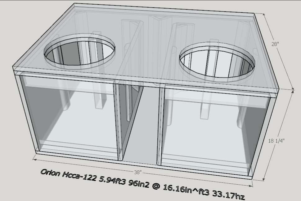

If it was me (and could afford it) I'd throw 5k at a pair, wire low (.5) and build something like this...
Yeah, that woulda been fine in the ol' Blazer... but I probably would have used different subs.

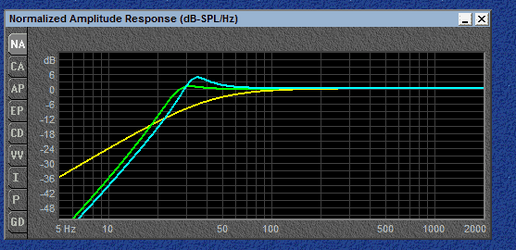

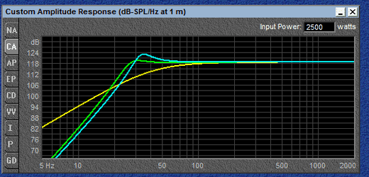

Wow. I swear these newbs are getting stupider day by day. I've never seen an HCCA sealed...always port. And no need for adjustable port.....in a wood box lmao. Like what else could boxes be made out of besides plexi, which is very expensive.
youtube it    saw one with hccas
Don't need to nor want to. But I can almost guarantee it'll sound better ported than*cough* sealed.
Why anyone in their right mind would take a high dollar sub and seal it is beyond me.
